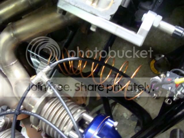

I have been asked a million times to help people with turbo testing and I always ask for the same pressures so i can see how the turbo is working. Most of the times people have no clue what the back pressure is, So I put together a kit to help everyone be able to check back pressure.
Knowing your back pressure is a must for dialing in your turbo. Back pressure affects spool and top end power so adjusting it is vital to getting you the power band and over all power you are looking for.
The kit we made keeps you from having to drill your header and can be removed after testing.
Here are a few pics of the flanges.
The kit comes with a 1/4 thick flange 2 gaskets and 1 pressure transducer good for up to 100 psi. Also all testing hardware like copper line and fittings.

Good idea Dan. Also if you dont want to kill your pressure sensor, loop a few inches of brake line between the manifold and the sensor to 'isolate' the sensor from the egt's.

<TABLE WIDTH="90%" CELLSPACING=0 CELLPADDING=0 ALIGN=CENTER><TR><TD>Quote, originally posted by Boner_Ben &raquo;</TD></TR><TR><TD CLASS="quote">Good idea Dan. Also if you dont want to kill your pressure sensor, loop a few inches of brake line between the manifold and the sensor to 'isolate' the sensor from the egt's. </TD></TR></TABLE>
We supply copper line with the kits.
<TABLE WIDTH="90%" CELLSPACING=0 CELLPADDING=0 ALIGN=CENTER><TR><TD>Quote, originally posted by miller &raquo;</TD></TR><TR><TD CLASS="quote">Seems simple enough but it seems like it will be a headache to get it to work, i mean come on. If you are doing back pressure testing, taping a housing or manifold isnt all that big of a deal. Especially seeing as how downpipes will have to get redone, intercooler pipes among othre things</TD></TR></TABLE>
That is the reason we made it 1/4 inch thick. Most down pipes and intercooler pipes have 1/4 inch of flexability. We tried 1/2 inch but it was a bit too much.
Alot of people don't want to drill a hole in a $1000.00+ manifold.
On some cars there is no room to fit a drill in the engine bay to drill and tap a hole without removing the exhaust manifold.
<TABLE WIDTH="90%" CELLSPACING=0 CELLPADDING=0 ALIGN=CENTER><TR><TD>Quote, originally posted by cluelessmale &raquo;</TD></TR><TR><TD CLASS="quote">on a divided housing would you need to have two pressure sensor?</TD></TR></TABLE>
If you are running a true divided set up it would be better to check both sides, which can be done with our divided version of the flange.
