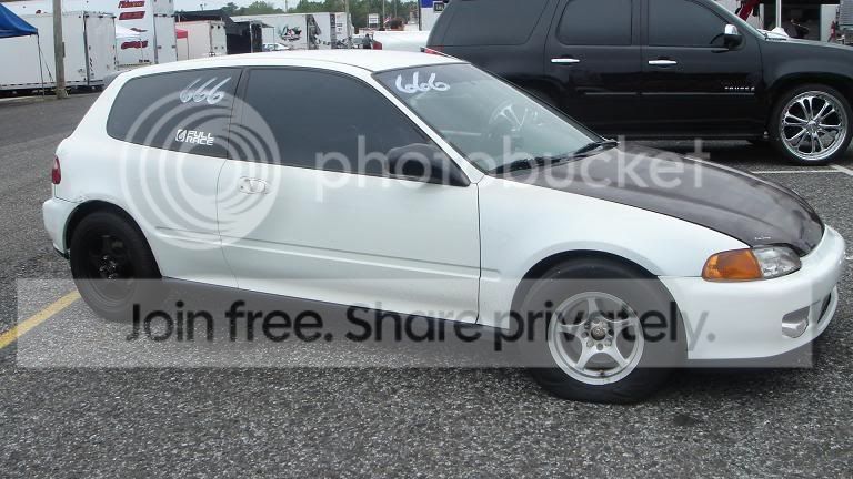

jus came back from jeff evans on a retune and came home with
700whp and 455 ft lbs on 34psi on my little b16
and at just 3.00 a gallon at that.i think i gonna love it
going to the track tomorrow for boti at atco to see what happens.
thanx to jeff and andrea at evans tuning for always being helpful
firststate motorsports for the part and welding hook ups

heres specs
b16a 84.5mm ge sleeves
cp 9:1 calico coated heavy wrist pins
pauter rods
stock crank balanced bottom end
stock port head
manley springs,retainers
type r cams
edlebrock intake,type r throttle body
fullrace t/3 ramhorn
3in downpipe and full 3in exhaust
fullrace t/3 t/67ho
1600cc injectors
msd 6al and external coil
neptune
motor has been together for a year now and just switched to a t67 and e85
stay tuned for times at boti sunday

<TABLE WIDTH="90%" CELLSPACING=0 CELLPADDING=0 ALIGN=CENTER><TR><TD>Quote, originally posted by JamaicanDave &raquo;</TD></TR><TR><TD CLASS="quote">nice numbers!!! when do i get to drive it ????
</TD></TR></TABLE>thanx for the pic dave see u at the track<TABLE WIDTH="90%" CELLSPACING=0 CELLPADDING=0 ALIGN=CENTER><TR><TD>Quote, originally posted by paulzy &raquo;</TD></TR><TR><TD CLASS="quote">nice, what fuel pump are you using to push that fuel?</TD></TR></TABLE>its a aeromotive eliminator
