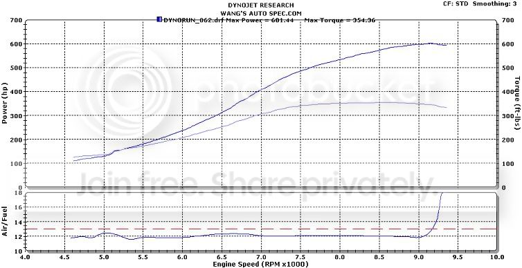

i tuned a car last week and the hp level was 601whp and 355 ft lbs of torque! the turbo were using is a t72, 84mm ge block, arias pistons, manley rods. my question is why is my torque so low? i run a act extremely heavy duty pp, 4 puck disk that is about 4 years old. if i change to a twin disk setup will this change my reading on the dyno?? any help would be appreciated! here is the dyno sheet
last year this setup made 588whp with 350 ft lbs

how much boost and timing? what hot side on the turbo? that thing looks pretty lazy for a 72

26.5lbs of boost, timing @ 26.5 psi is about 24ign... hot side on the turbo is unknown the owner of the car would know!

I have the B18c 84mm bore with a innovative T72 turbo also but it seem to me that you might have a big A/R turbine housing. Your turbo seems to be a little lazy according to your graph. The graph never flat lines....meaning it hits target boost and holds it there. The sooner you can get it to spool up. The more torque you will make. I make 540 Wheel Torque @ 38 Psi.
A T72 seems to be a little big to only run 26.5 psi...crank that thing up!

Is that a stock GSR head? Has it been ported/polished? That is where you will see the torque numbers increased from.
Over then that, you can see the VTEC reverberation at about 5200 RPM. You could lean that out a little bit, or pull more timing right there (VTEC window), this will heat up the exhaust gas and help the turbo spool a bit quicker.
You could also drop it down to 20 degrees at about 26 lbs of boost.

Torque is so low because that dog-*** turbo is spooling up so much later than your torque peak that you're not getting a chance to make anything. Run more boost, and ditch those godawful crower turbo cams and watch your torque jump.
