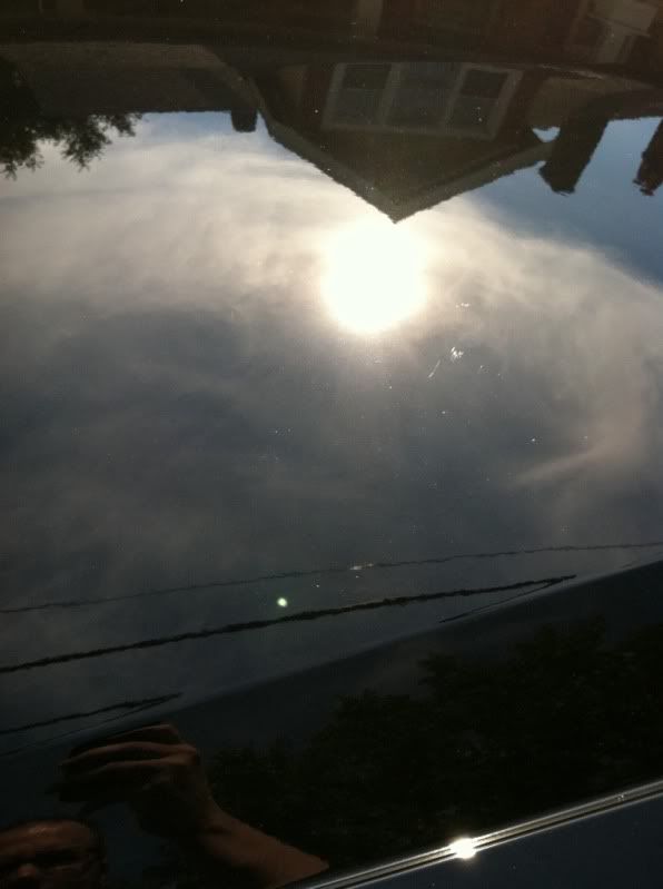

Just a quick before and after shot. I didn't take nearly enough after pics, so you will have to take my word that it was a major improvement.
Really thought I shot more after pics.

Can you explain what you did to get rid of those scratches?

Here is a quick run down
Dawn wash
Clayed with Zaino Z-18 w/Z7 for lube
Meguiars M105 w/Flex 3401 Tangerine LC pad
Dawn Wash
Zaino Z-PC w/Flex Black LC pad
Zaino Z-5 by hand
Z-6 with Zaino Blonde towels

I didn't end up with any afters of the passenger side. I lack any real photography skills. It is my sister's car though so I might be able to get some still. She just bought it and it had def seen it share of gas station washes. I would say the correction was in the 90% range. The brother in law should be able to keep it up ok now.

It was easy to work with. The Z-PC on a tangerine pad fared pretty well on the swirls that were on the whole vehicle. 105 wiped them out. I was fairly aggressive on some spots with a rotary. (This was actually an insurance job) There was plenty of clear to work with too that is for sure.

Saw my sister today. Truck has been washed twice since, and not by me. It is also filthy in these iPhone pics.
