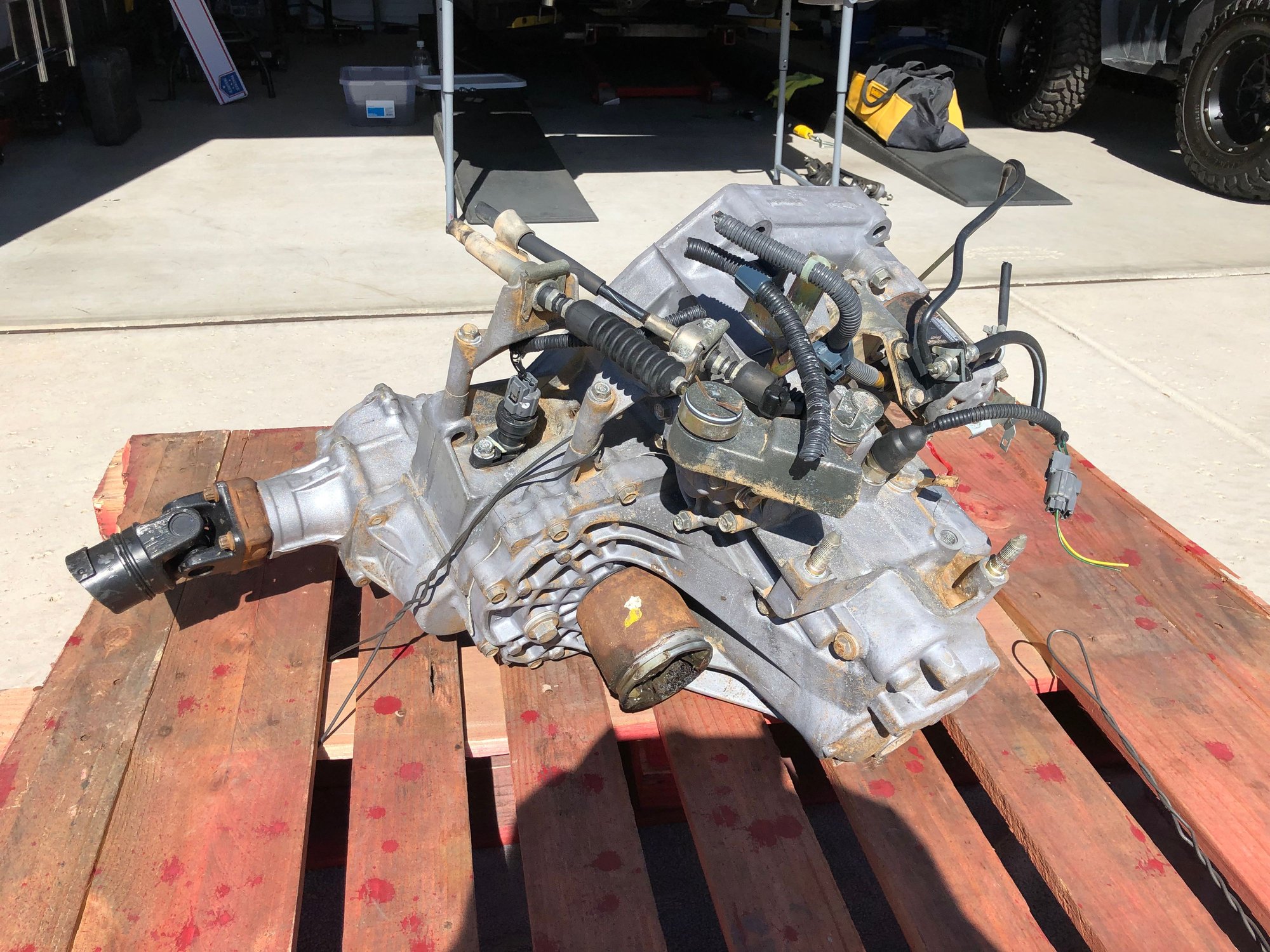

Current state of the car!

I will be putting up my FWD Trans and T1 Shifter with Strain Gauge soon LOL.

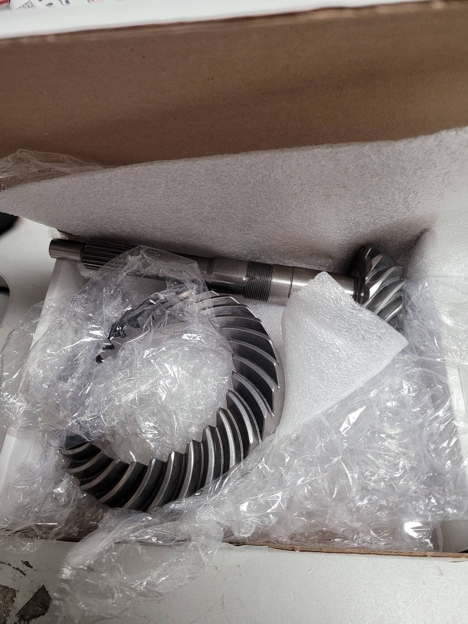

Got a text that my Ring and Pinion are in and will be going out next week for cryo treatment and polishing. The LSD is being shipped from Europe so I’m hoping to see it in a few weeks possibly.

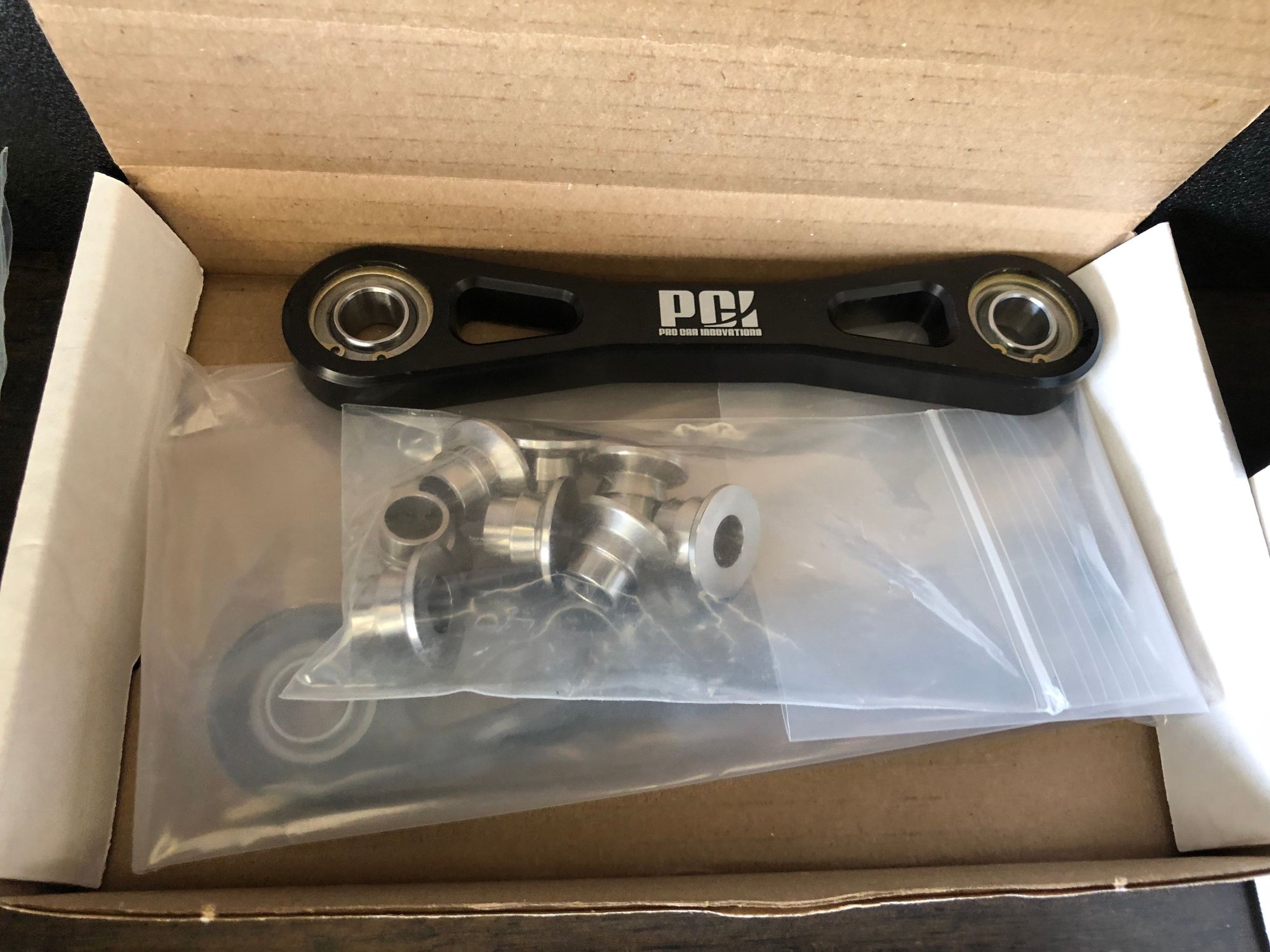

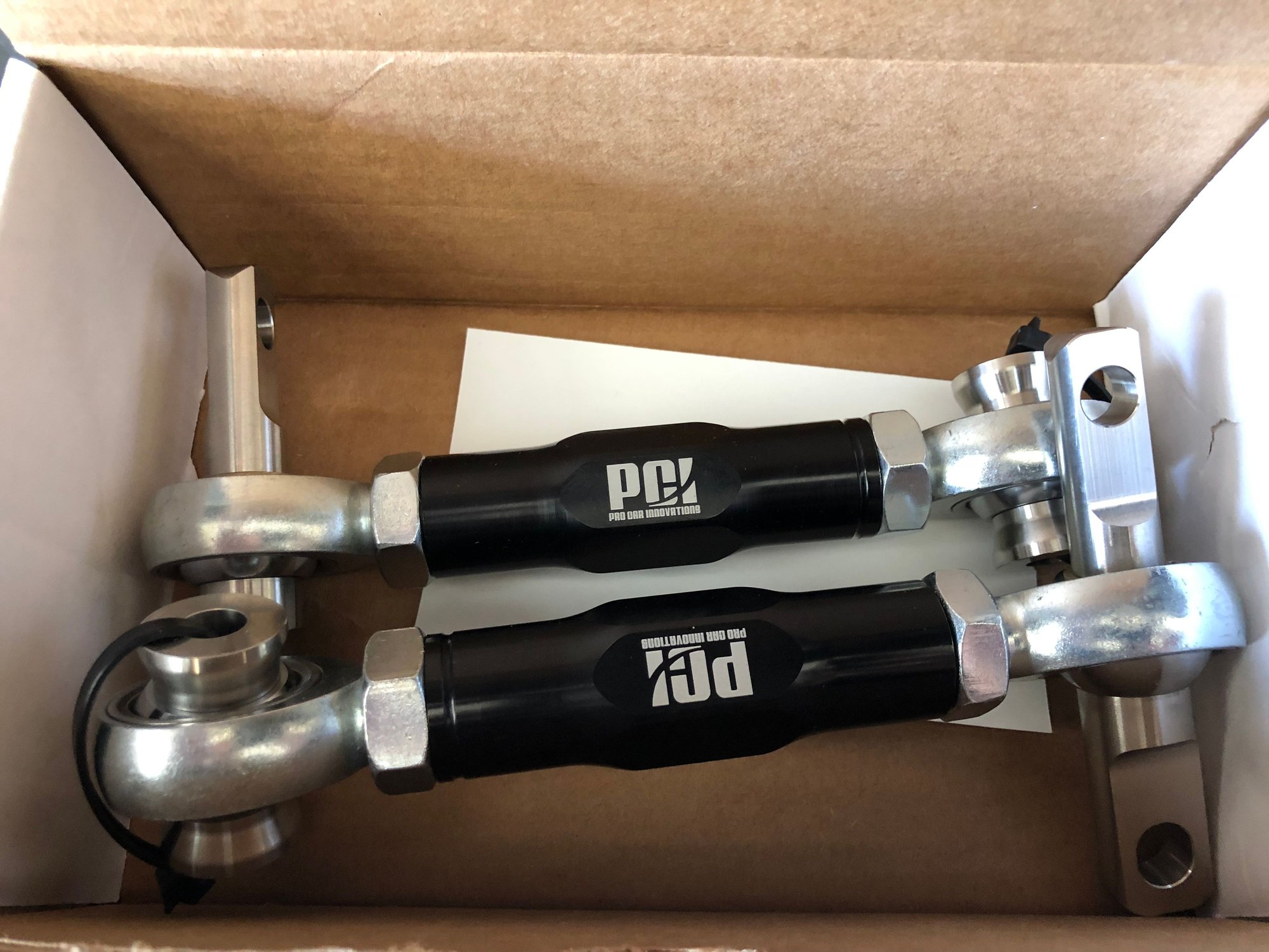

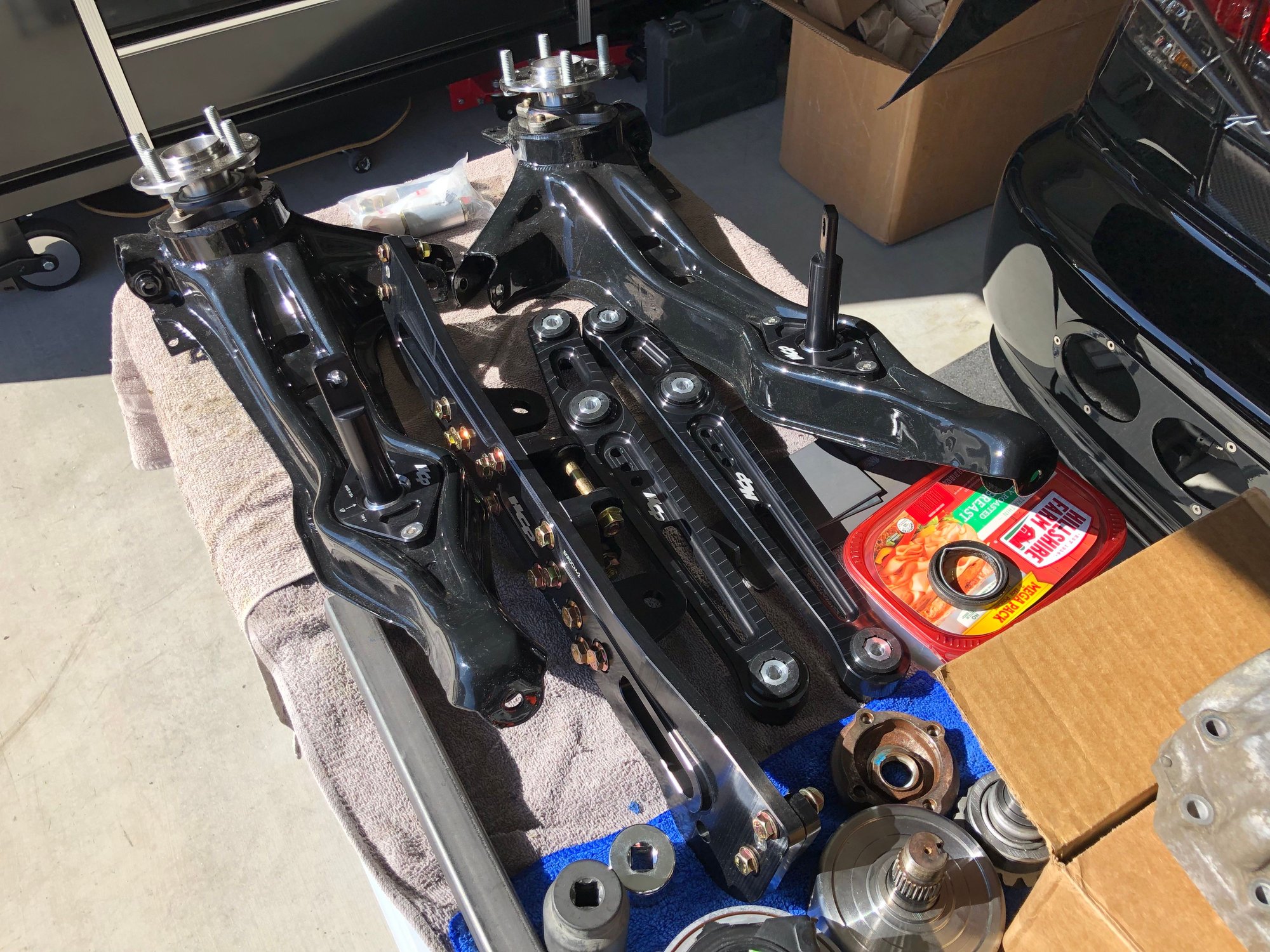

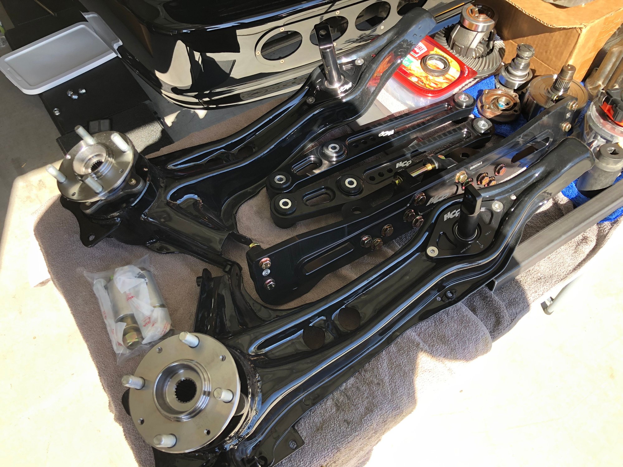

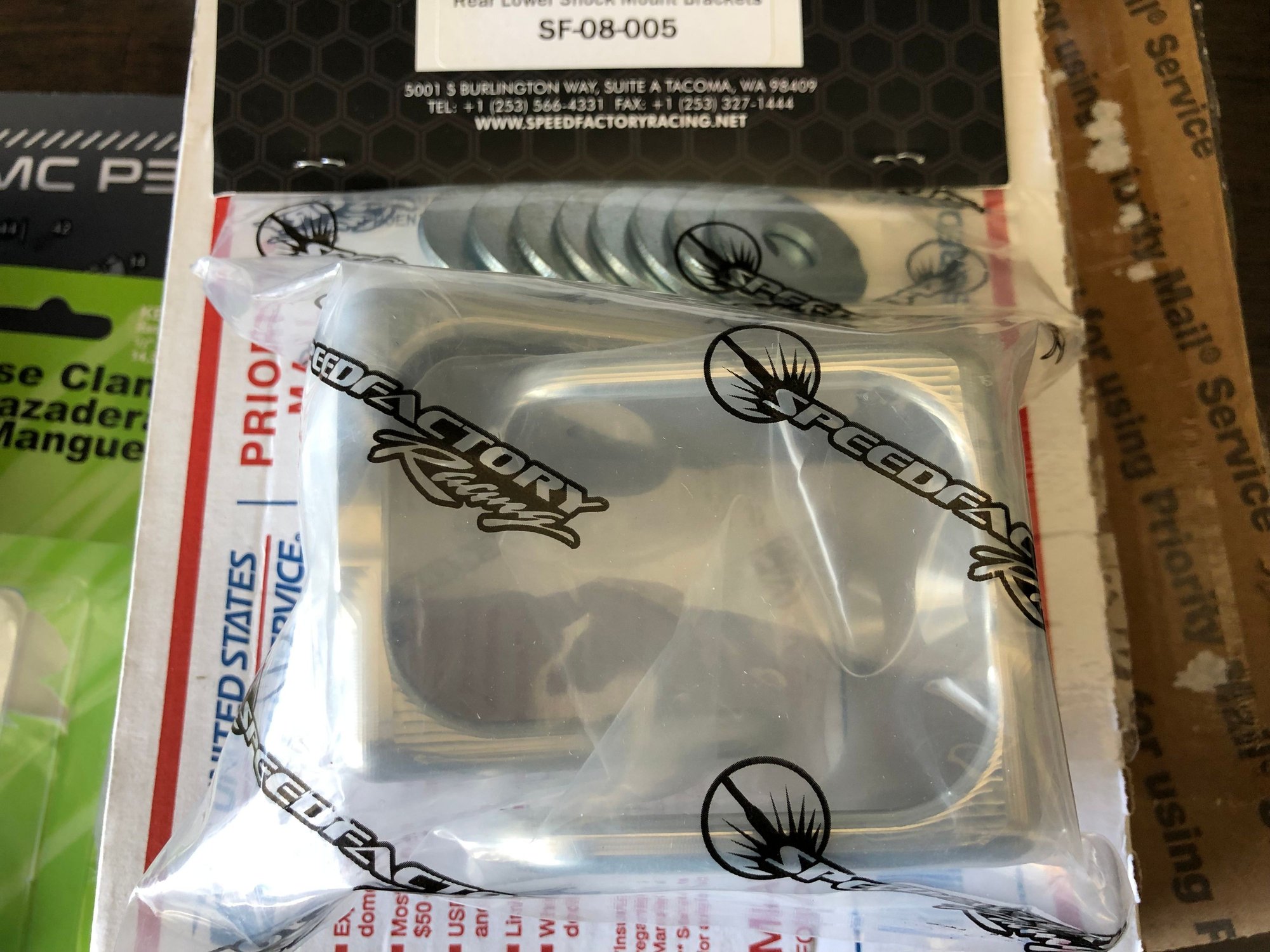

Got some parts in today…

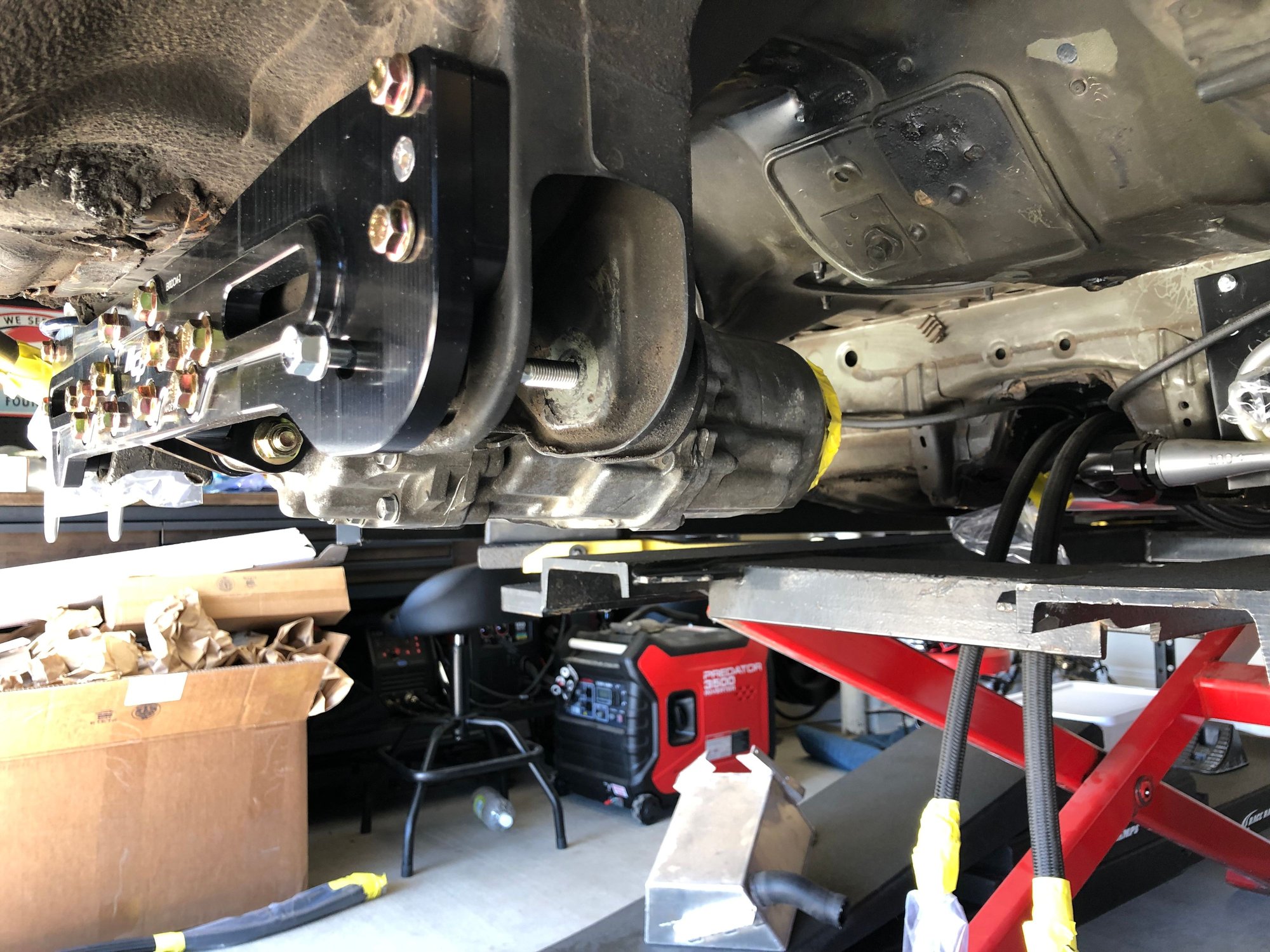

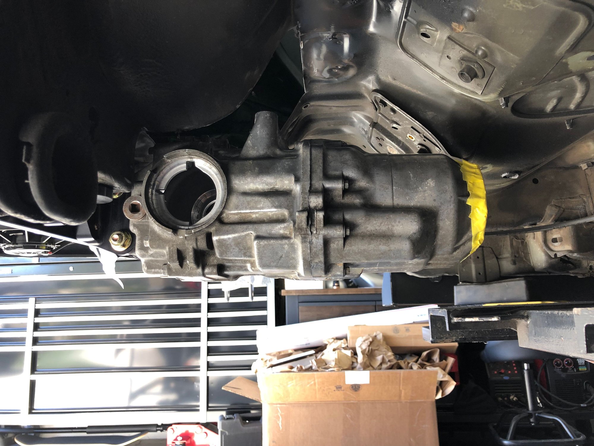

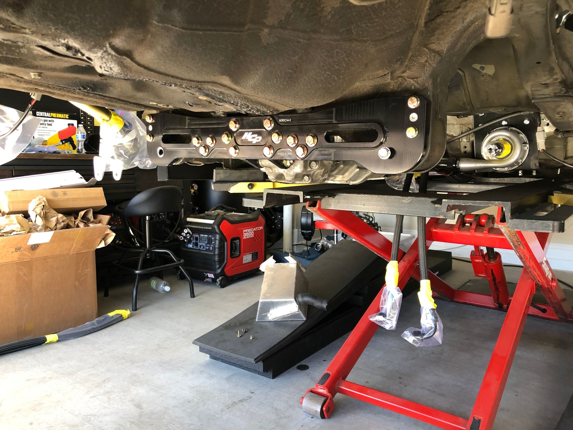

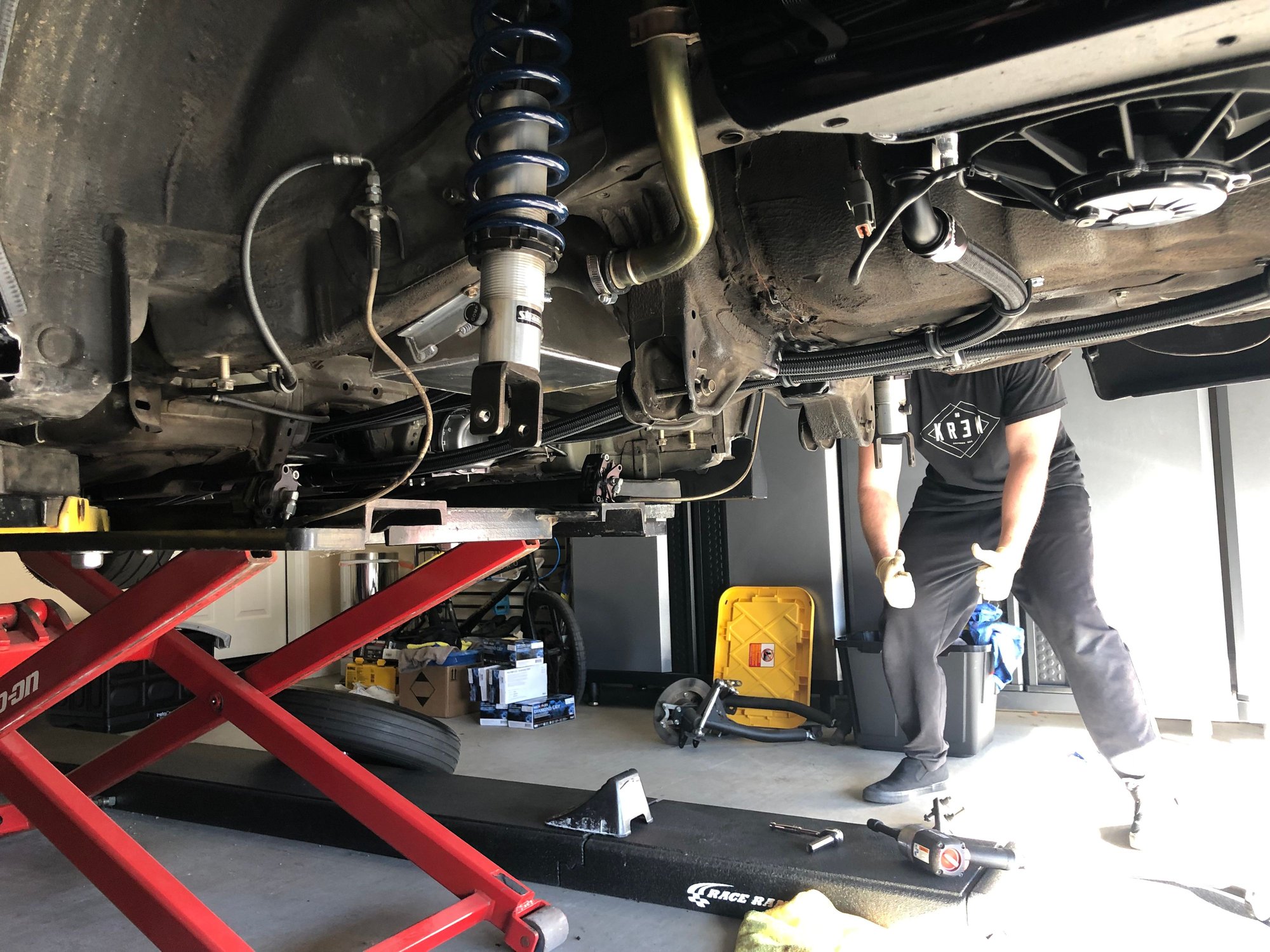

Made some progress, basically getting the HCP mounting bracket on and then getting the rear diff mounted and figuring out how much I need to cut from the trunk area.
Once I am done with that I can start getting the rear arms on and getting things bolted up, from there I have to get the diff bar measured and welded up.
