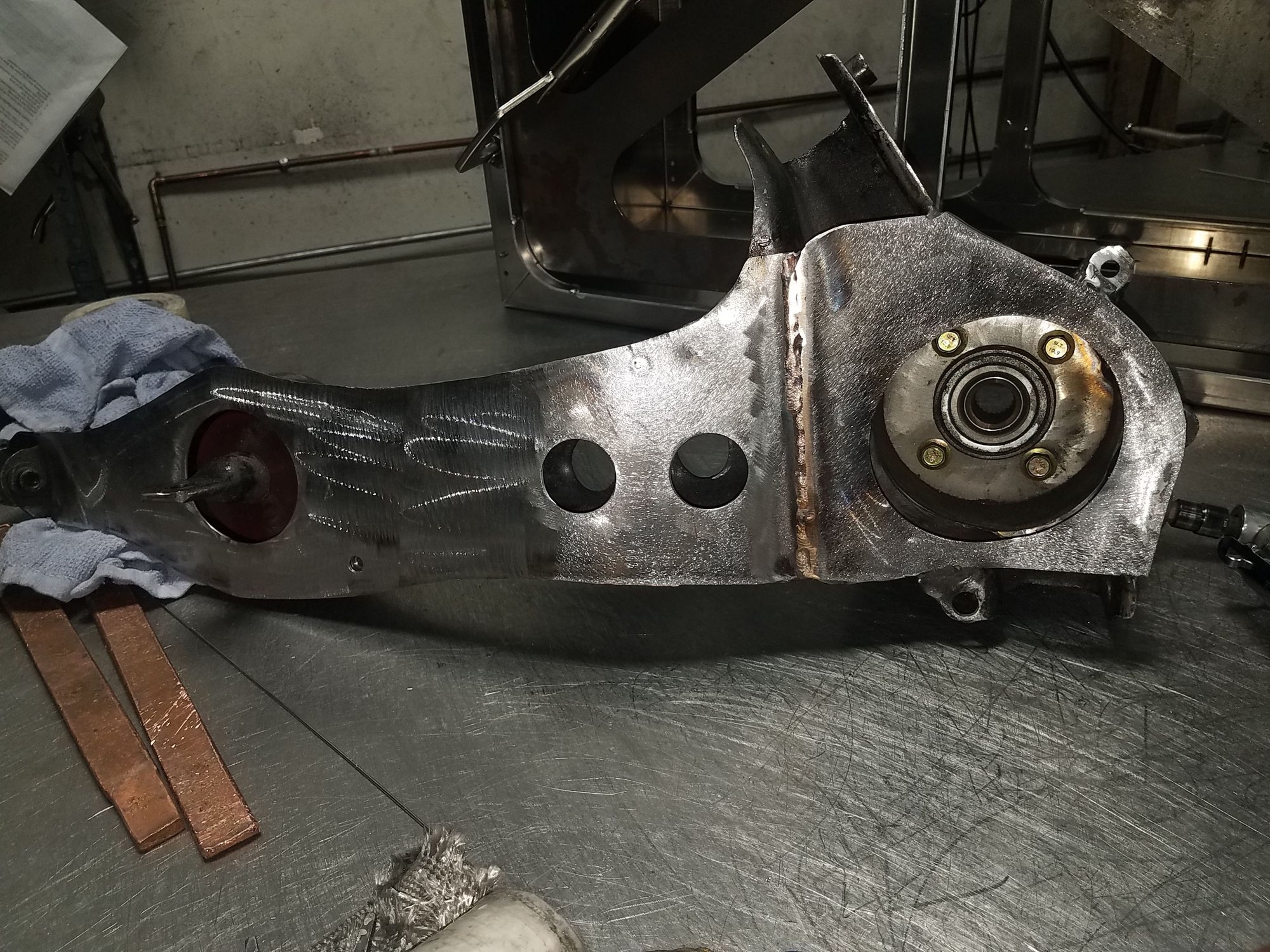

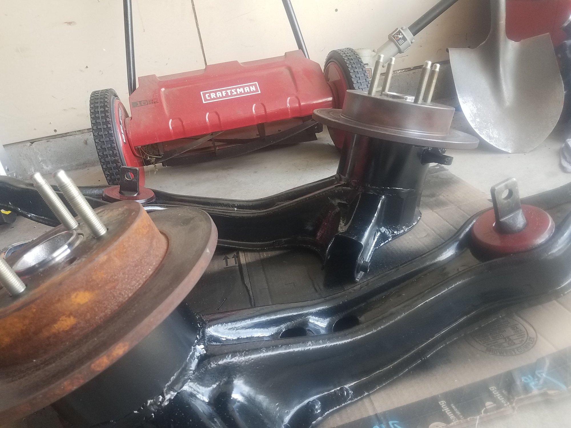

Originally Posted by Ryanthegreat1
Holy weld build up! Why not band saw out some 1/4" plate? Even a zip disc would work. Geebus! That was a lot of gas and a lot of heat!
Didn't really want to spend the time in writing another program and since I work in the welding department this was faster for me.

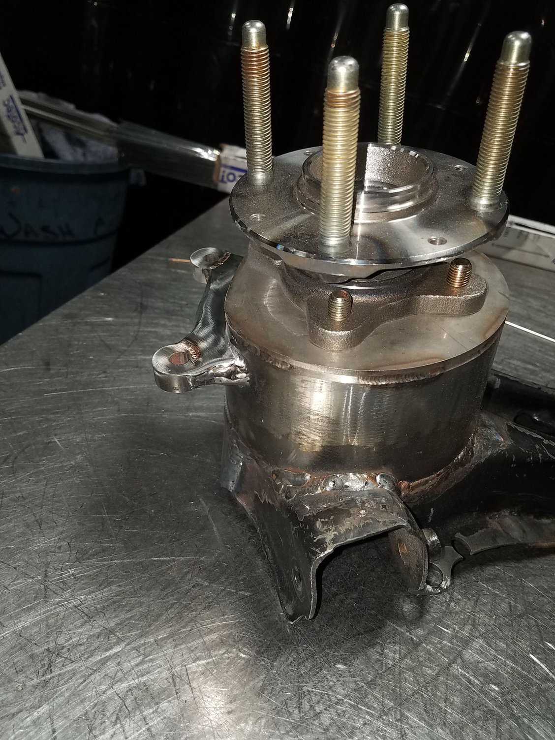

Did you use ERCuSi to fill that joint?
Old Jun 28, 2020 | 10:07 AM
  #33
tigArex's Avatar
Joined: Nov 2019
Posts: 34
Likes: 11
Default Re: AWD for 1k
I fused it, then steel, then i was added silicone to make it look flush before I realized that was dumb.

We do it all the time to avoid putting to much heat into the part. Run a pass of steel, flush out with CuSi, grinders blend it down, paint makes it look great.

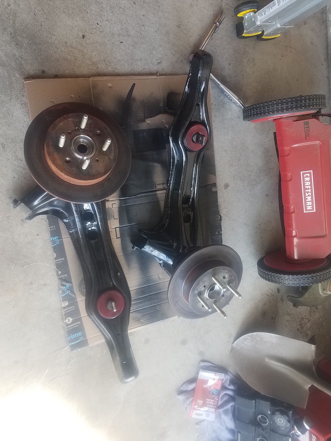

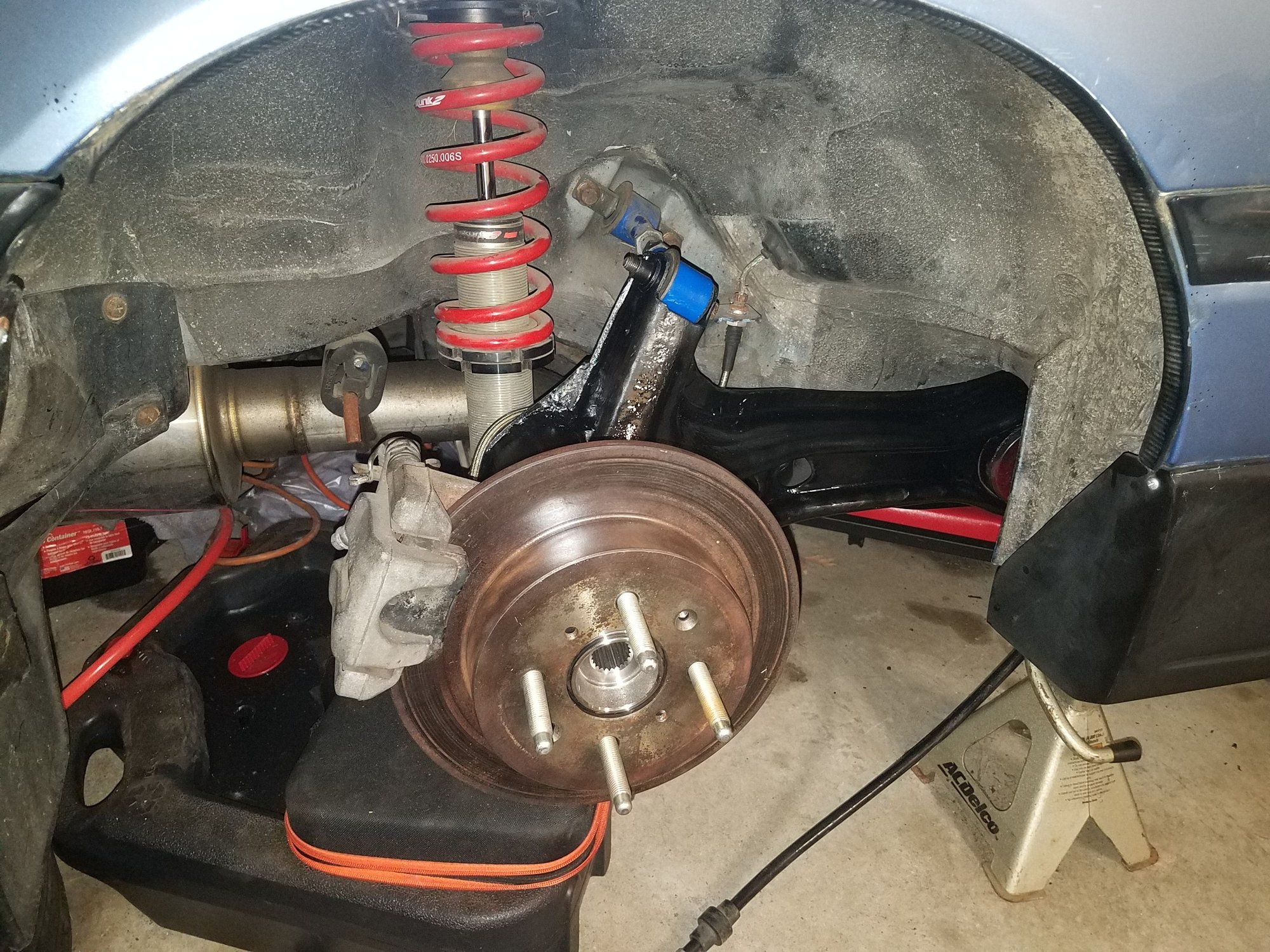

brakes seem to fit alright the exhaust has to go though

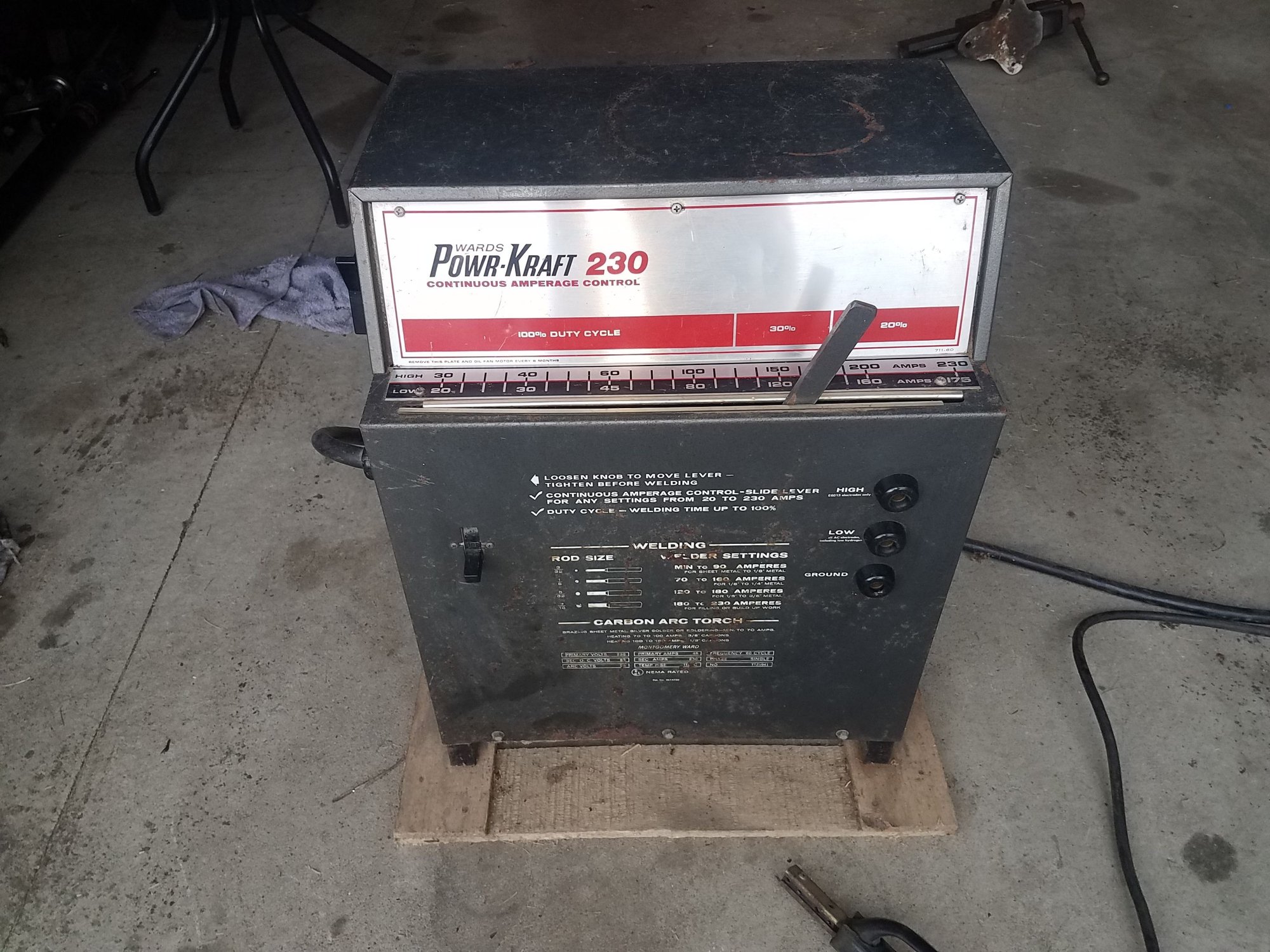

Got a couple gifts today! Don't know how to stick weld but I'm sure it's like riding a bike right?

Can you MIG weld?
Old Jul 12, 2020 | 10:31 AM
  #43
tigArex's Avatar
Joined: Nov 2019
Posts: 34
Likes: 11
Can you MIG weld?
I get to weld about 4 times a year but yeah does it look the same?
Old Jul 12, 2020 | 10:38 AM
  #44
Caoboy's Avatar
-Intl Steve Krew
Community Influencer
Active Streak: 120 Days
Loved
Posts: 6,927
Likes: 197
Sort of similar if you’re familiar with fluxcore.
certain electrodes are for specific positions, some are for all positions, some are root pass (6010/6011), some are high fill (7018) etc.
youre familiar enough with welding that if you grab yourself a box of 1/8th 6010 and a few 1/4 plates you can figure it out. I was taught stick first, because ‘if you can stick weld, you can mig weld!’ according to my instructor.
