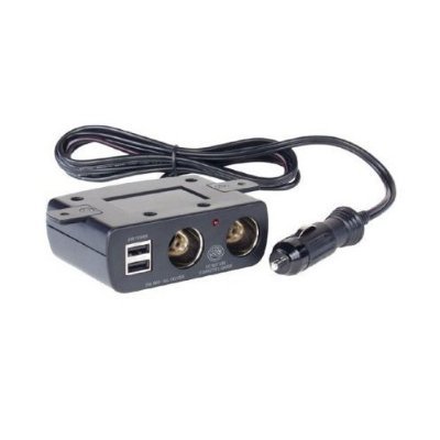

I bought a Magnadyne charger with dual 12v sockets and dual usb ports.
I'd like to mount it using the brackets to the underside of the top of the little cubbyhole under the radio on my 2001 Accord EX. Of course, while I'm at it, I may as well get rid of the power cord, so I guess I should buy a female socket that terminates with a leads instead of a socket plug.
Any guides on doing this? Any advice on how to mount the device? I suppose I'll need to drill a couple of holes, and that will mean removing the housing around the stereo (no way to drill a hole that far back in the cubbyhole without removal, I don't think).
In the end, I want it to look like this:
The other potential issue is that once I've wired it all up and gotten that cable out of the way, I still have cables for the devices I would connect to the Magnadyne charger (GPS cable, USB cable for phone) creating clutter. Anyone have a more elegant solution? I suppose I could gut the Magnadyne, and see if the innards fit inside the dash and run all the cables out from the dash.

1. Since the charger is rated for 20A, perhaps I should connect it to circuit other than the 12V cigarette lighter plug circuit, which might be a lower amp rated? My thinking there is the charger would be able to supply more power to charging electronics (like my phone) if connected to a power powerful circuit. Am I thinking about this correctly?
2. I want to connect the charger to a switched circuit (as opposed to an always-on circuit), so that it's not always drawing current. I don't drive my car every day, so I don't want the battery drain, nor do I want the indicator light on the charger attracting thieves (see bright red light in pic in first post).
I picked up an ATM blade type fuse holder and some ATM 20A blade fuses. Also picked up some quick disconnects.
Not sure how to proceed, so suggestions are more than welcome!

FWIW, I have this exact same device:
You'll need to the check the rating of the fuse on your existing lighter socket and also the wire gauge running to the lighter. In the case of my Civic at least, the lighter socket is rated at 10A and the wiring is like dental floss - maybe 22AWG or something. If you *really* need more than 10A on these sockets, you'll need to home-run some new wiring back to the fuse box or the battery.
12VDC @ 10A (120W) is more than enough power to run my full-size Thinkpad laptop DC adapter off the lighter. If you're only running some USB devices and a phone charger/radar detector, you can replace the 20A fuse on the back of the device with a 10A fuse and connect it to original lighter wiring.
10A is *not* sufficient to run an actual cigarette lighter safely.
Battery is safest route. You can also find switched circuits at the fuse box and use an add-a-fuse to piggyback the charger. Only caveat here is the "add-a-fuse"-type devices are only rated at up to 10A.

Where did you mount the charger? Did you hard mount, or just use the velcro? I found the adhesive they used with the velcro to be very cheap and it came right off.
I'll check the wire gauge later, but in looking at the Helms manual for my 6th gen Accord, it looks like the fuse for the accessory power socket is a 20A fuse (fuse #9). The audio unit shares this fuse. It's located in the passenger side under-dash fuse box. BUT, the cover of the accessory socket has "12V 10A" written on it.
How does that work? Is there a fuse further downstream of the passenger side fuse box that limits the accessory socket to 10A? If there is, it isn't drawn into the circuit diagram. But I'm sure I'm missing a simpler explanation.
OK, so given your explanation of how much power I'm getting at the accessory socket (120W), I have more than enough power to charge my GPS device and a phone. So I can just replace the 20A fuse in the charger with a 10A fuse and connect to the accessory socket wiring. As far as the connection, do I simply cut open the wire leading to the connector that plugs into the accessory socket, strip off some of the housing and connect the red and black wires, respectively, and wrap it up with some electrical tape or heat shrink tubing? No need to solder the wires together, correct?
I guess the charger's power cord does not contain a fuse in the male plug, just the fuse on the back of the device? If that's the case, why do the instructions state that if you cut off the plug, you need to connect to a fused power source? Shouldn't the fuse on the device itself be sufficient protection?
I'm not actually using it in a car, but for a small solar power setup in my house.
The accessory socket itself is switched, and since it sounds like it has sufficient power and makes for the easiest installation, I'll just use that.
Agreed - I'd just hard-wire into the original lighter socket in your case. You'll not exceed even 10A with a GPS and phone charger.
