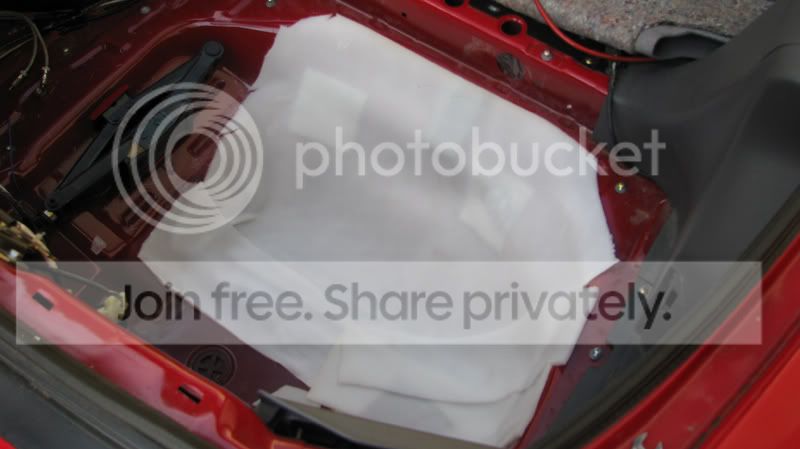

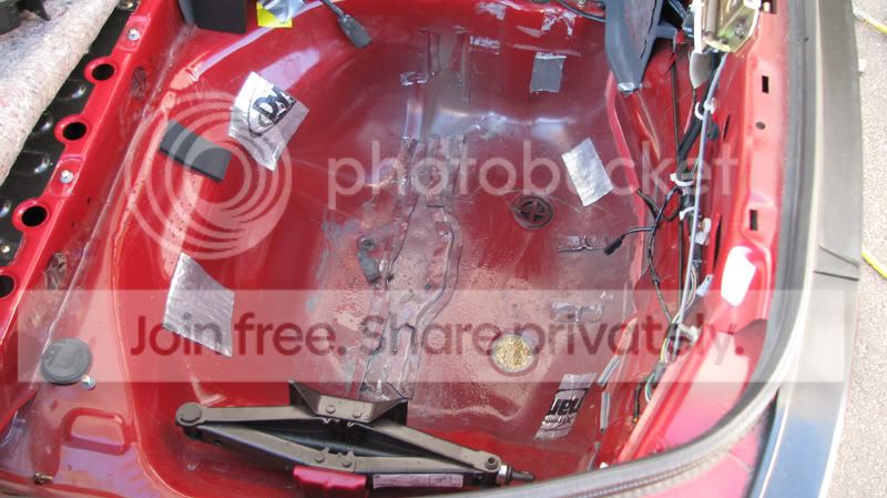

Had the car since tuesday, and have a couple days off, so figured it's way overdue for a system
Plenty o' pics -

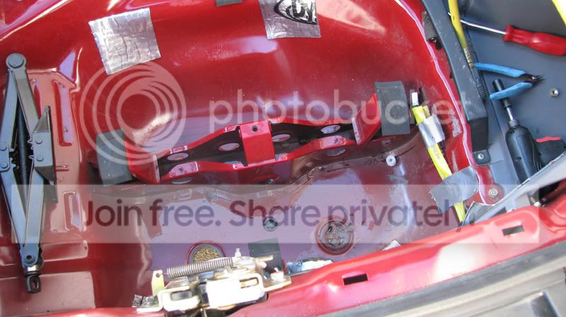

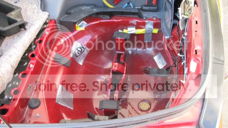

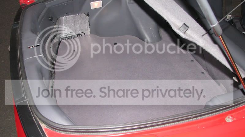

Before, after I removed the spare and rear washer reservoir -

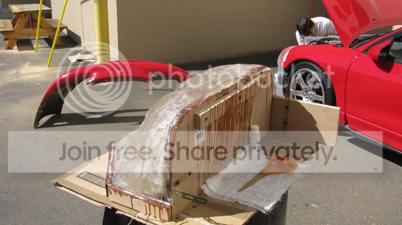

After airsaw and hammer -

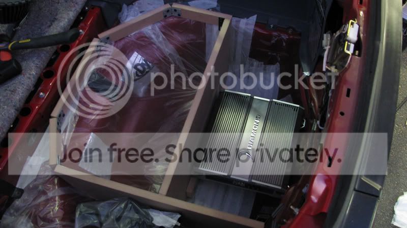

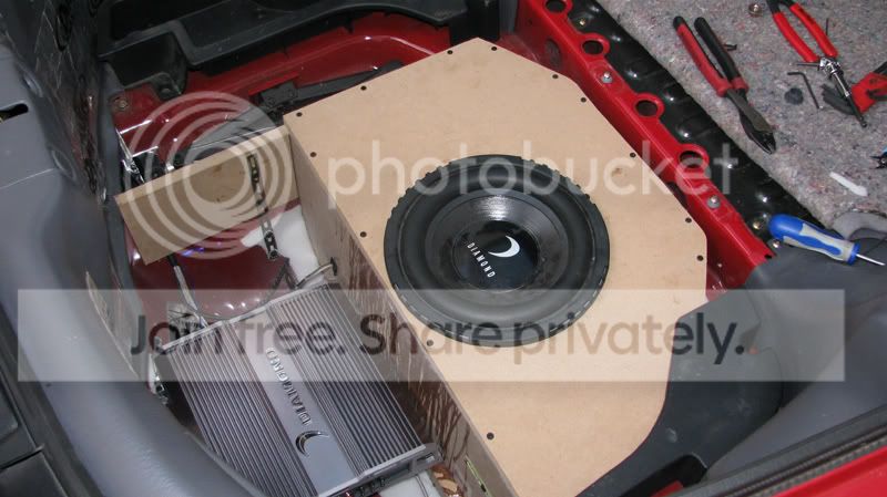

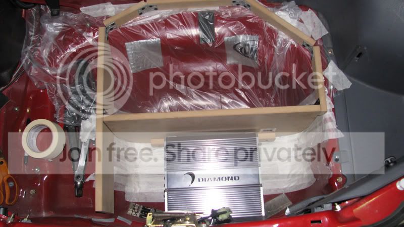

Pre-glass, test fitting amp and building frame for box -

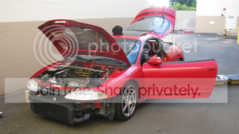

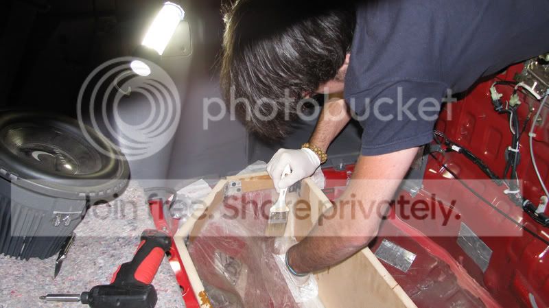

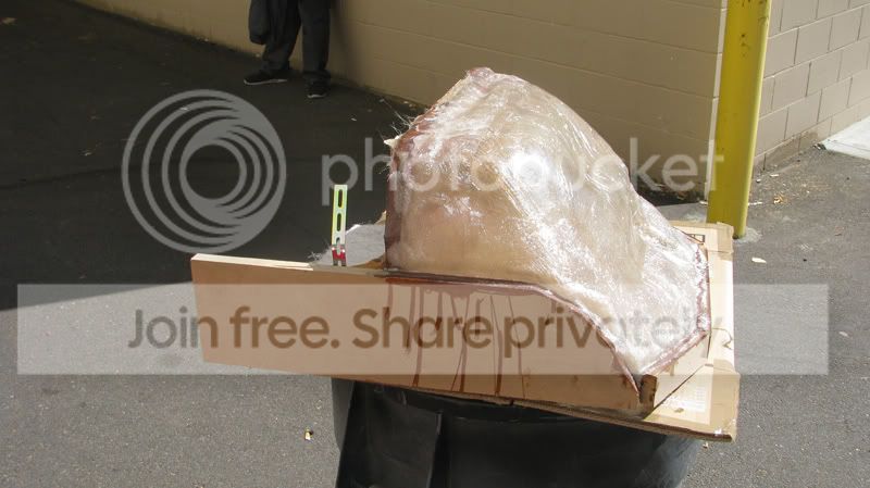

Action shot, was really wishing I had a respirator about this point -

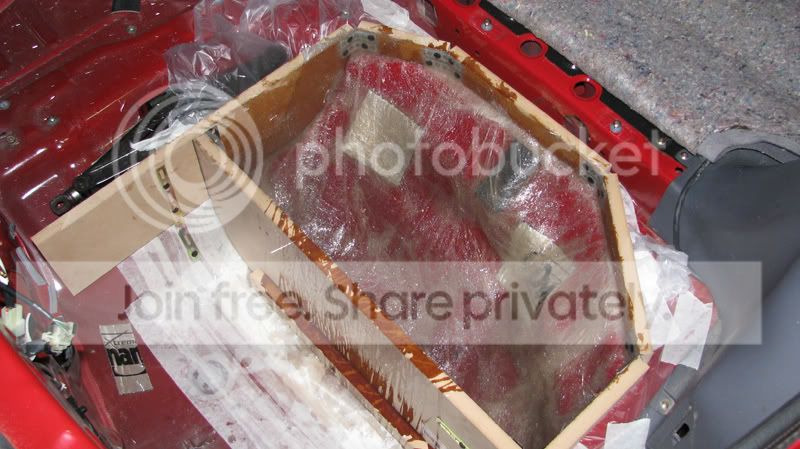

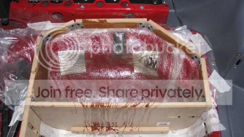

After 2, 3 or 4 layers of glass -

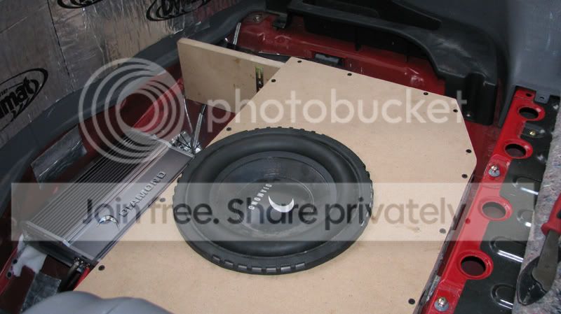

I spy Dynamat Xtreme, but only a tiny patch - What's the story on that?
Old Sep 6, 2008 | 11:30 PM
8520's Avatar
Posts: 6,416
From: Seattle
Default Re: (Davus)
Previous owner did it. Not sure wtf was going on there, or why he put it on the OUTSIDE of INTERIOR panels in the trunk.

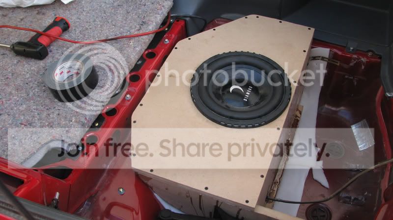

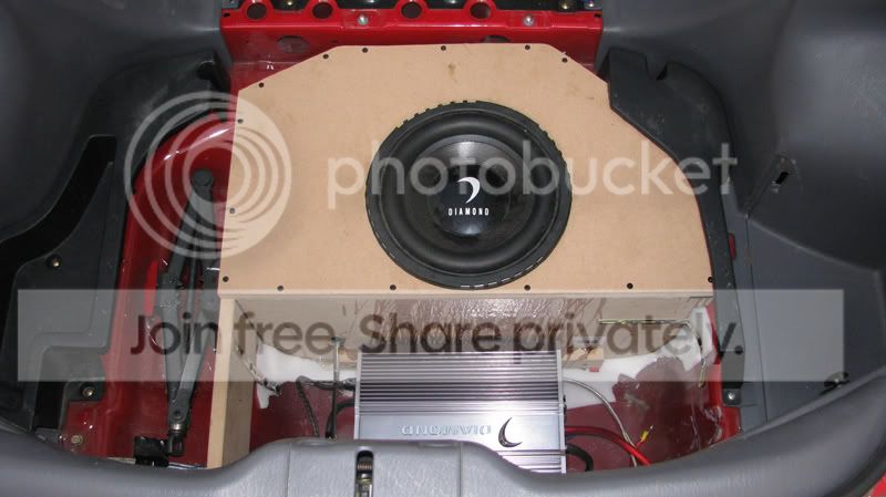

So. Here's what we got done today -

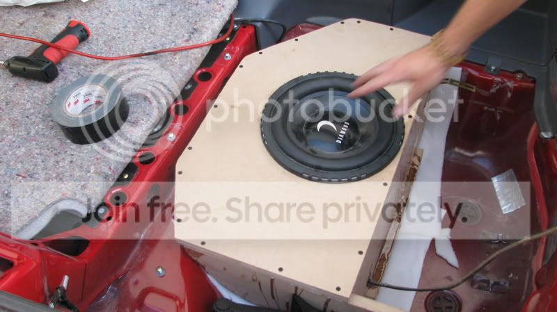

Glassed the outside box edges and did another couple layers on the inside. Box is solid.
Unfortunately I didn't get any pictures of the final box assembly, but it was pretty straight forward. Pre drilled all my holes and silicone sealed the edges. Bought some 1/4" foam to go between the box and the floor so it wouldn't rattle. Spray adhesive worked wonders with this stuff.

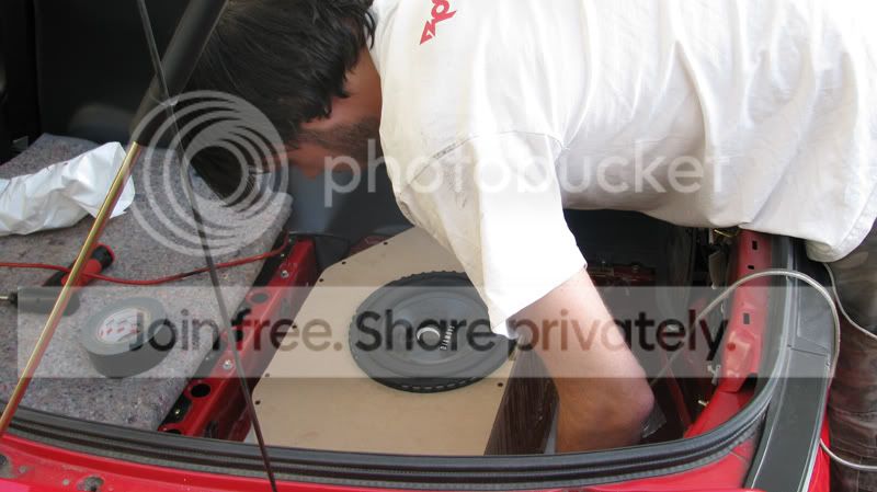

Test fitting -
Oh, painted the interfooler today too
Sub amp mounted, don't mind that the amp is "upside down" as there will be another amp mounted on top. Unfortunately the sub amp rca's weren't long enough
What it will look like once it's all done.
Going to make a false floor with an integrated grill and use security screws to help deter thieves.
