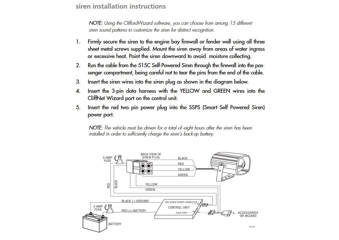

Starting with a thank you for any help. I've dug up and old Clifford G5 alarm that I removed in the past from a car. I need help with the speaker/horn wiring. The siren/speaker has a red wire and a black wire. The alarm unit has two brown wires for speaker output. Brown 1 and brown 2. Or if you might now the wiring of the Clifford speaker with backup battery. It's wires are as follows. Red, black, green, and yellow. Any help would be appreciated.

I would assume 1 brown from alarm to red on siren/ black on siren to ground.

1. Is the primary + output to your siren.
2. Is the secondary for horn+ output.
The others im not sure, try www.the12volt.com They might know.

For the siren with battery backup, the Black, Red, Yellow, and Green wires goes into a siren plug. The Red and Black wires then is plugged into the siren power connector on the control unit. With the Yellow and Green wires going to a data port on the control unit.
See page 36: https://www.directeddealers.com/manu...9640_08-04.pdf
