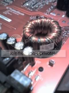

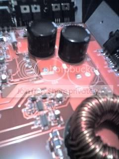

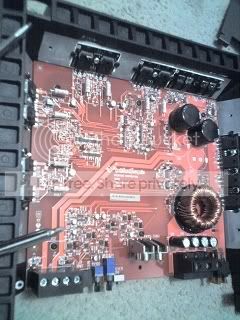

Hey FCM do you got the schematics to the rockford fosgate t3002 amp by any chance or know what one looks like inside? I'll take a picture of the amp when I open it up. It should be fairly cheap to fix. It looks like its missing 2 capacitors inside if im not mistaken.
These are the internal amp pictures.

No caps are missing, the same board is used in a number of amps, the T3002 does not have caps there... http://ampguts.realmofexcursio...T3002/

What are those two black things in the first picture? It seems there are 2 missing since there are spots for them but I guess not since you provided the link, most amps that are my size, inside has 4. Oh well.
