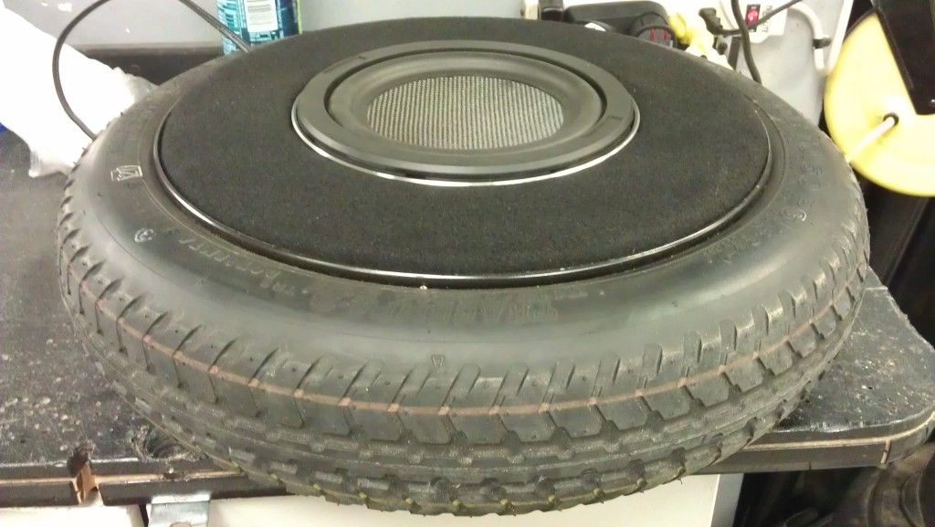

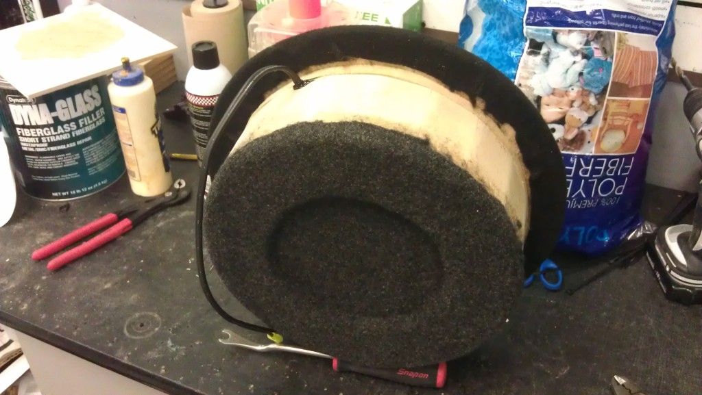

single 10 would require a box of some time in the hatch area.. if you want complete stealth, the spare tire holds enough airspace for an 8. built this one for a fahrenheit edition gti a while back. if you're willing to ditch the spare, you could easily do a 10.. but not many people are willing to ditch a spare tire for tunes
