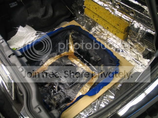

I bought 2 50 sq ft rolls of b-quiet off ebay I didn't double layer everything but I did cover it all. I left the original hole in the doors and rear trunk area but my complete floor & roof is covered I used up 1 complete roll and 30% of another one. I have a picture of the rear hatch section I'll post later

Default Re: How much Dynamat? (92CivicSIRhb)
Since this picture all the metal is covered in this area I left all holes open as I didn't want to waste material.

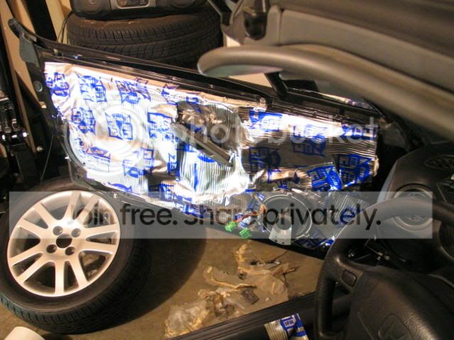

I do my doors a bit unique depending on what is goign to be in them - let's assume there is going to be a driver in the door....
I use a stepped approach for the door skin, with the focus being right behind the speaker - The door skin gets one layer across the whole skin. Then a second layer that covers about 1/2-2/3 of the skin. Finally a 3rd and 4th layer go right behind the speaker - about a 10" square.
For the inner door panel area - where the speaker actually would mount to, like the photo above....I do one layer over the whole inner panel, but cut out the areas where the big holes are. Then, I use perforated aluminum sheet and cut patch panels for the big holes, shaping them until they fit. Next, cover those panels with matt on both sides. Screw them too the door with sheet metal screws.
Then one to two layers of closed cell foam over the whole door (I use ensolite).
Then the back of the door card gets covered with matt as necessary.
Along the way, you test the door by wrapping it with your nuckles to see if there is any vibration, etc. I pay special attention to the lock mechanism, door latch rods, etc and cover them in foam tape to quiet them down. I also tie the wireing down nicely to make sure it doesn't move at all.
Then put it all back together.
That's what I would call a proper door install. If you want to get a bit crazier, there are a few ways, but it involves aluminum channel and 600mph tape and a lot of work - what's posted above should be more then adequate and actually overkill for most.
But that's how you spend 30sq feet in two doors

Here's another pic. This was just a single layer. I have since changed the setup some.
