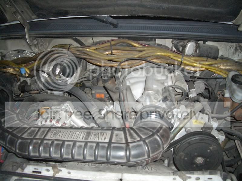

heres the pic of my engine bay...
i got 8 runs of power cable...0 guage....with a 250amp HO alternator...
running an odyssey pc2150 (thats a battery if you guys dont know)
my bad...i didnt say what i got, so you guys assumed that im just kid that dont know ****...
its a street B set up...dB drag...

LOL.... That looks like straight up *** crack.
And I've never met a competitor that doesn't run a fuse... Must be you're a genius compared to everyone else because you know something the rest of the world doesn't.

Is that TRUE odd gauge cable???? It doesn't look like it is. BTW It is RETARDED to not fuse power cables PERIOD!!!
