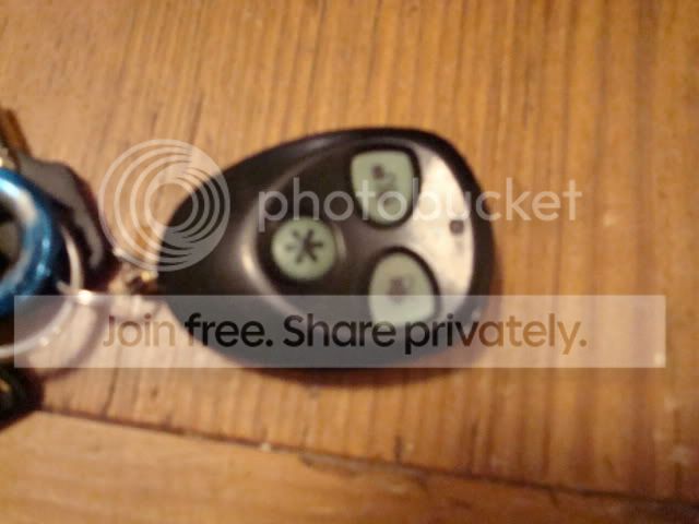

The Civic is an Si with stock power locks. I was looking around and playing around and after fiddling with the switch on the door, the passenger door started locking and unlocking with the remote. However, the driver's side won't work with the remote or the power switch, the door can only be locked with the key. The lock seems to jam up when the mechanism tries to actuate it. I can't find the "brain", but then again probably wouldn't be able to recognize it either. The problem seems to be mechanical, but here's a shot of the remote anyway in case it helps at all.
Anyway, where should I go from here?

You need new door lock actuators. 94
PS, that is not a stock remote control.

thats a avital
