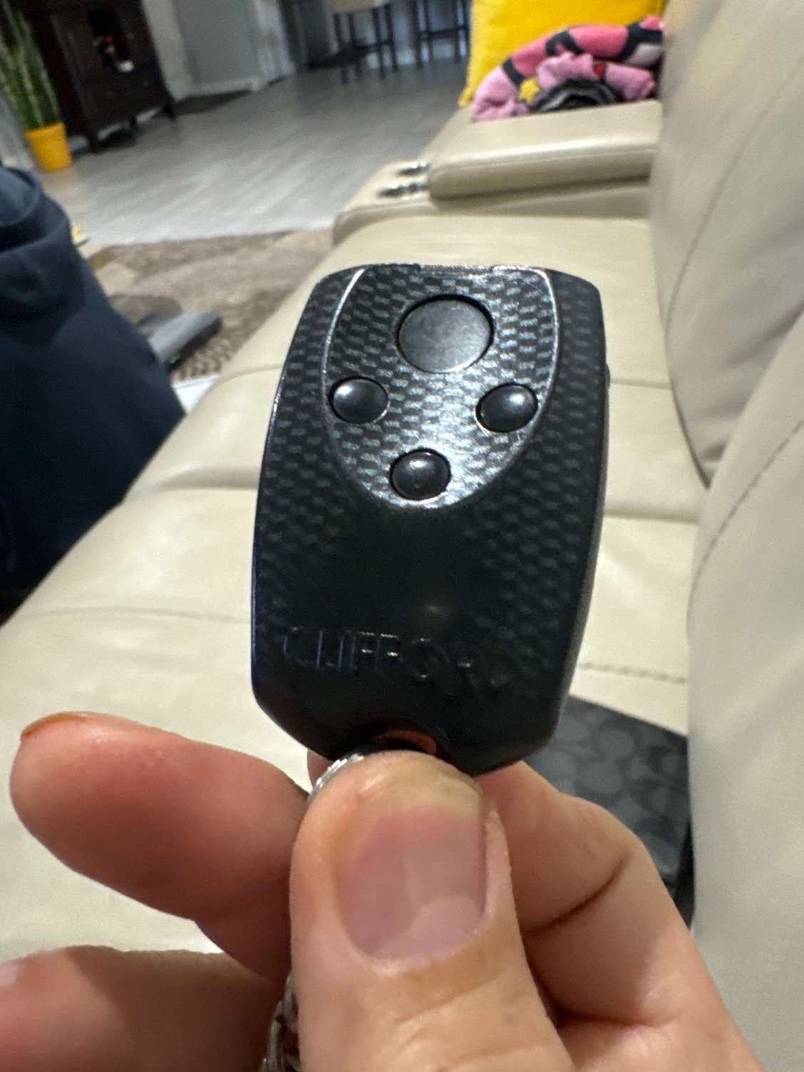

Bought a 1999 integra, comes with a clifford remote. Anyone still using the same remote? I wonder what the left and right buttons are for. The dash led light is on (solid)… i wonder if theres a remote start function. I dont know what model is the alarm.

If the status light is on once you turn on the car, the system is in VALET MODE. Look for the valet switch and turn it off.
if you search around, the brain control box is likely located under the driver dash. I’m betting it’s a Clifford Ace 5000
REMOTE
top large button — arm/disarm
left button — silent arm/disarm
right button — trunk
bottom button — start
