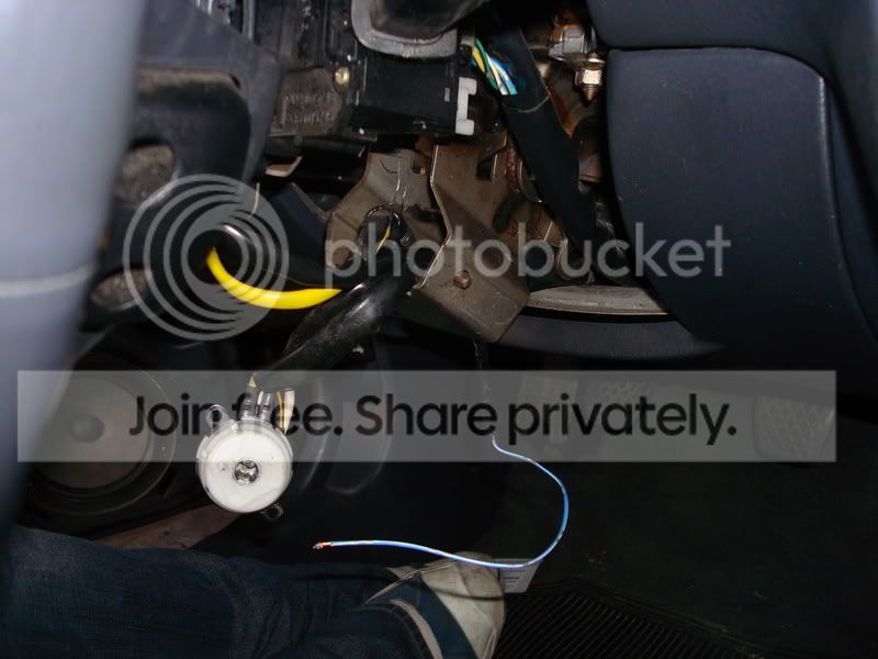

My 00 si got stolen about two weeks ago and I was fortunate enough to get it back. Unfortunately, now I have to fix all the things the thief screwed up
I have no knowledge about any of this so I'm hoping someone can help me out.

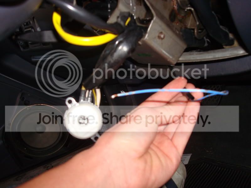

It looks like the guy hotwired the car but I'm not sure. there is a blue wire that is cut underneath the steering column. I traced the wire back and it looks like it comes off the main harness that goes to the ignition switch. Other than that one single wire I can't really see anything that looks like it was cut.
Here are some pictures to show what I'm talking about.

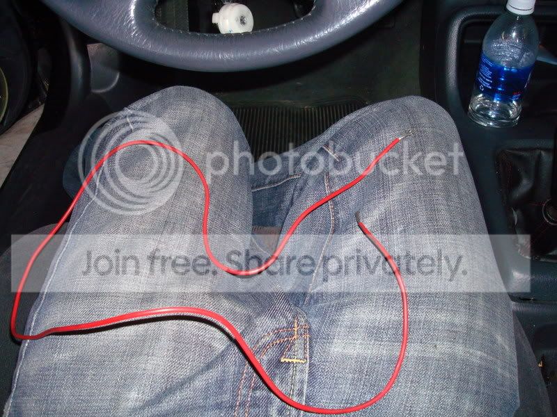

THis picture shows a long red wire that was sitting on the floor of my car when I got it back, I have no idea where it came from.
The problem I am having right now is that the amber lights on the gauge cluster do not work, neither does the glowing lights on my climate control. However, the gauge cluster is working and the lights on the e-brake, turn signal, CEL light etc. are all still working also.
Any help would be appreciated and if anybody could let me know what i need to do to fix this so that everything is working like normal again that would be great
thanks

Sorry, I am not sure I am able to help, I do not know what that blue lead is, it may be "key sense".
However the "dash lights", [instrument cluster and heater control] leads are red/black, [pos.(+)] and red, [neg.(-)] so I would check your dash light fuse in the under dash fuse box.
You said no other leads are cut, but was the ign. switch hanging there like in the pix?
Does the car start or even turn over, [crank]?
The red lead is not an OEM lead, probably something they were using to hot wire the car.

umm... where is your steering lock?
that white thing dangling, is the combination switch... it attaches to the steering lock
all you need to do is turn the center, and the car starts..
you don't need to "hot-wire" the car...
check your fuses... for a blown fuse...

yeah the car turns on by just turning the center. But why would that blue wire be cut if they started the car by taking off the combination switch? i guess thats kinda what im asking.
it might have gotten ripped off...

The " white thing dangling" is not the "combination switch" it is the ignition switch, it is screwed in, [two screws] to the back of the "".
However, "umm... where is your steering lock?",[Lock cylinder and steering column lock assembly] is a good question.
Starting the car is as easy as removing the two screws that hold the ign. switch in the lock cylinder housing and using a screw driver to turn the switch, assuming car does not have OEM immobilizer.
Driving/steering the car would require getting past the steering column lock, probably by just removing the whole lock cylinder/steering column lock assembly.

eh... actually honda calls that switch: "switch, steering" but its listed under "combination switch"
he said he had a 2000 honda civic.. i don't think those came with an immobilizer
your best bet is to find a junk yard steering column assembly..
and have a locksmith re-key it to yours... since you are missing it...

OP they probably used 3 wires, which most honda theifs probably use. One for the starter, one for the ignition and possibly the fuel pump/or a ground wire. The blue one is for the tach/coil.

To the OP, I would go to a "pick your part" salvage yard and get a new steering column / ignition harness. Then have a key made for it. Re-key the trunk. Disconnect the door key cylinder rods and use keyless entry. The people in this forum will help you put together an effective car security setup so this never happens again.

6th gens dont have the glowing key ring, but I think you can turn the headlights on and tap into one of the 12v wires on the column.
Isnt the tach wire for ignition? thats the blue wire. That blue wire almost looks blue/white

but yeah the key cylinder housing/steering wheel lock assembly is not there, what is in the pictures is all that is left.
