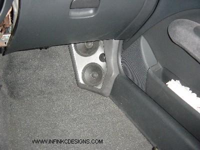

custom kick panels

<TABLE WIDTH="90%" CELLSPACING=0 CELLPADDING=0 ALIGN=CENTER><TR><TD>Quote, originally posted by infinkc &raquo;</TD></TR><TR><TD CLASS="quote">custom kick panels
nice kicks... but im wondering on air space for each one of the woofer, mid bass and tweet.. as well as if they are separated inside that inclosure

Default Re: (infinkc)
dude infinkc, how do those not get kicked to hell by your passengers? is there something over those?

Default Re: (cruzin89lude)
I had a custom job done with Boston Acoustic 6.5's that the tweet's were mounted in the kick panel on my Integra GSR also. They never got kicked or anything. The imaging was perfect.
