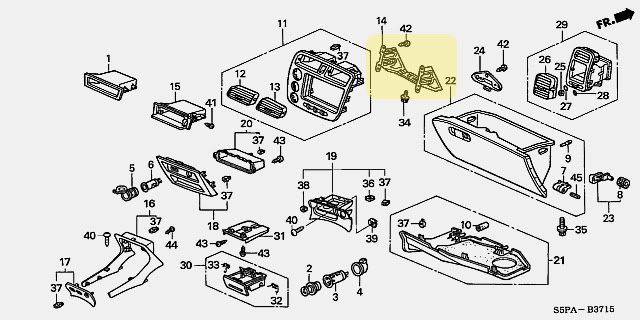

Im not sure what the 05 dash looks like but I have a double din in my 01 and it was very straight forward. Just mounted it to the stock cage and had to use a washer on both sides as a shim to center it. Do a search on metra's site for product 95-7899. You will need to trim the bar off that runs through the middle and sand it flush and you should be set. hope that helps

that does help, i think anywhere from 01-05 are the same setups.
does yours resemble this?

thats it! i dont know why they told you at crutchfield it wont fit? i used the mounting holes on the side of my AVIC D2 and the holes on the stock cage that the oe stereo is attached to. Once you have the old stereo out and the wire harness all plugged in, its literally a 10 minute install
