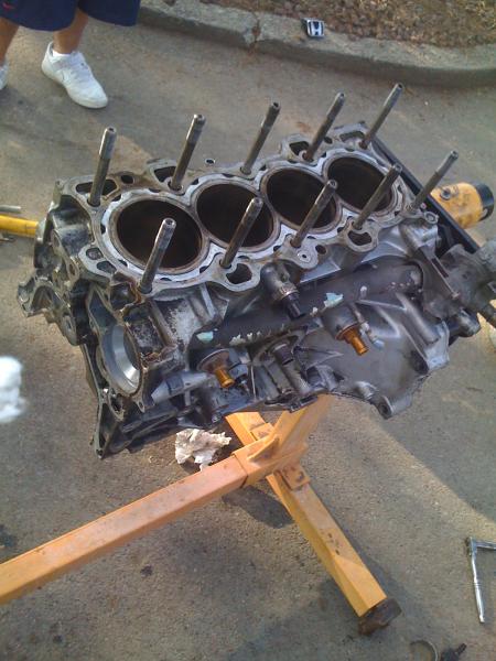

Some MORE!!!! after taking the motor out n trying to clean it .. n before taking it to the machine shop n after...

nice buddy-what did you get done to the block just a clean or did you get a bore/sleeves?
Old Feb 15, 2010 | 02:34 PM
กก4drWHORE!!'s Avatar
Joined: Mar 2009
Posts: 494
From: A BOX
Default Re: !!!SuperCharged B20v 4DR!! QueVida
The Block was hone n hot tank*
-Shot peen rods
-Hot tank pistons and glass bead them -Reround rods
-Polish crankshaft I left my stock pistons n rods
-new OEM rings*
-ARP HeadStuds/ROD bolts
-ACL Mains/Rod bearings
-SuperTech BlockGuard
-OEM oil/water pump
-Moroso Oil pan... That's all I can remeber for now
