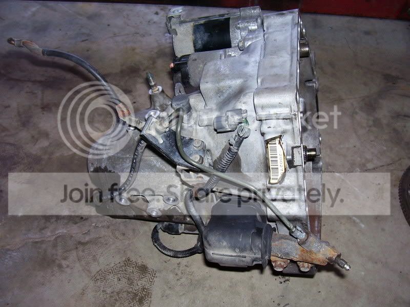

I ran my 1990 Civic STD last year with good results.
https://honda-tech.com/zerothread?id=2067128

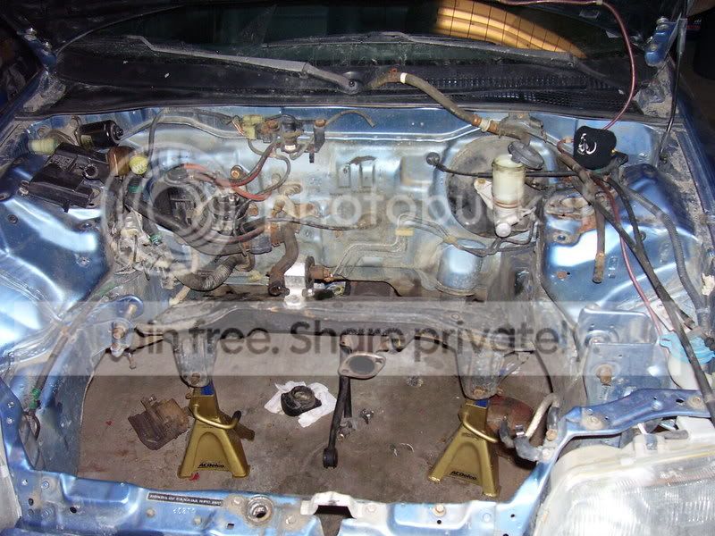

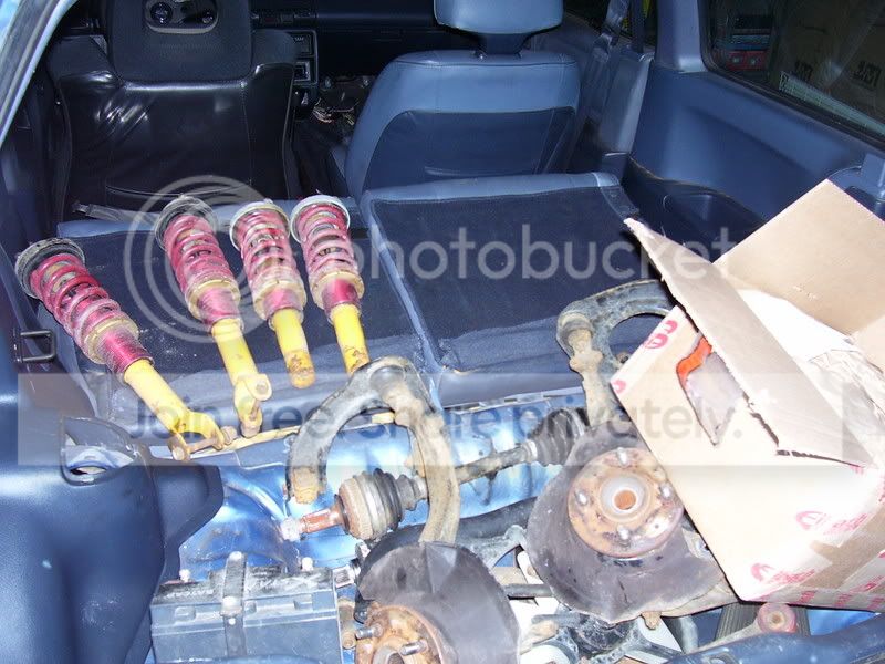

But this year I want to be faster. So I sold my B16 and got a B18C GSR long block from HMO with a Y21 w/lsd. Also sold my St sway bar and replaced it with the new ASR road race 32mm one. I had 450f/550r spring rates with is good for a STS car but for SM I went with 700f/700r.
As of right now the car is apart. Should receive new engine today.
Parts I am reusing:
CRX SI disc conversion

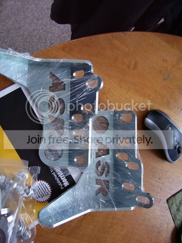

New parts shelf:

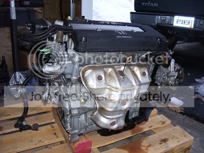

Freight truck just dropped off the B18C

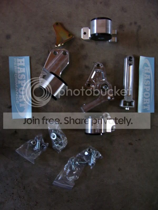

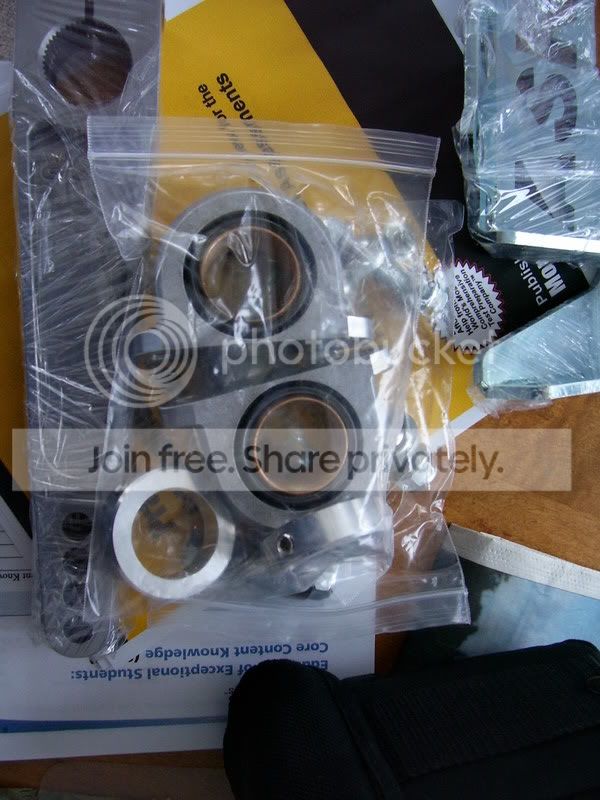

More new parts

Just figured out I will need a DA rear bracket and left side engine mount bracket. Had to order it from Prime Acura in NH because their are no Acura dealers in Maine.

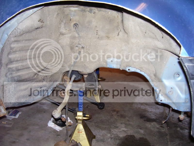

Old Mar 13, 2008 | 01:51 PM
welfarepc's Avatar
Posts: 2,946
lol @ the cut up fender. gotta do what you gotta do....
i picked up an 88 crx for $400 and the guy cut the **** out of the rear quarters and had some HUGE 15 inch 60 series tires on it... lol

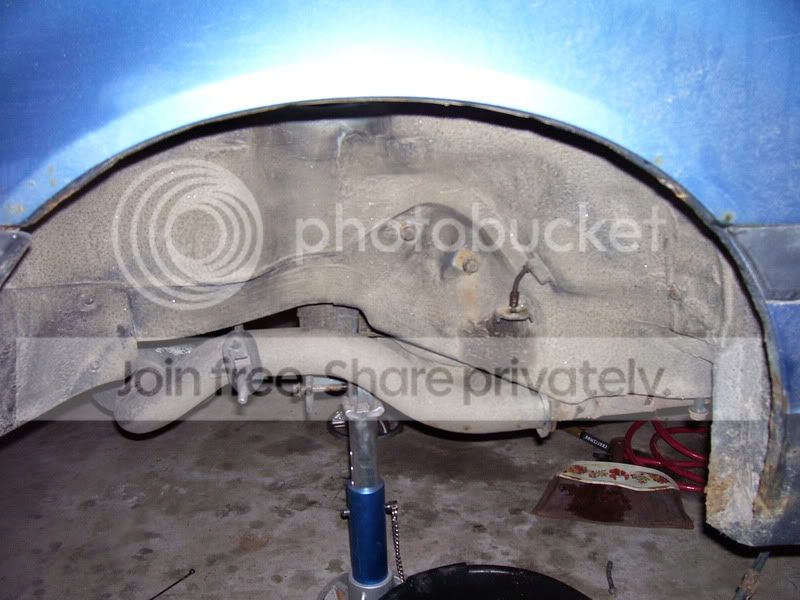

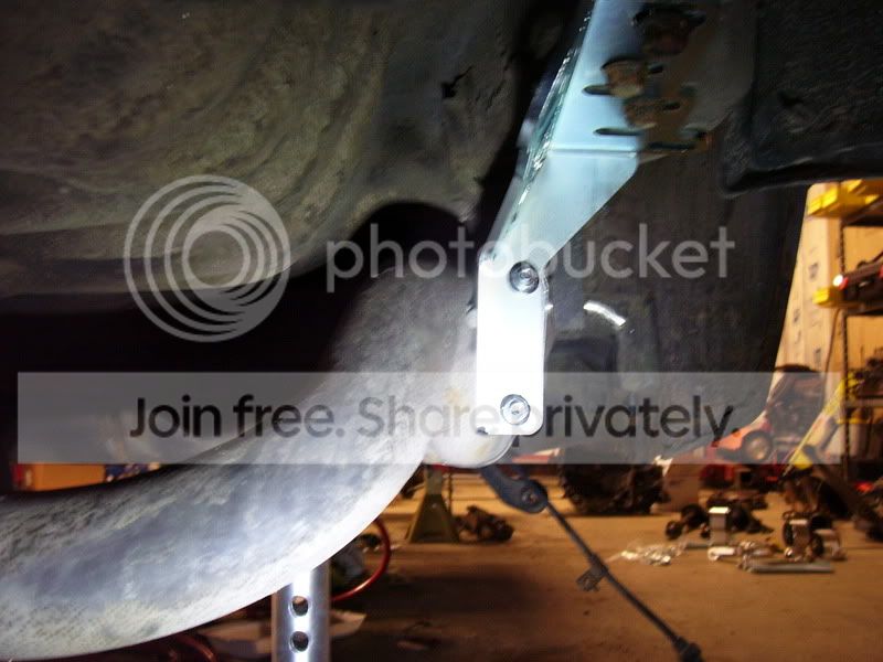

Installed the ASR RSB tonight. The only thing I noticed is that I can't run a muffler at all. Hopefully no new lots have db requirements.
As you can see the exhaust is right behind the opening in the bar hole.

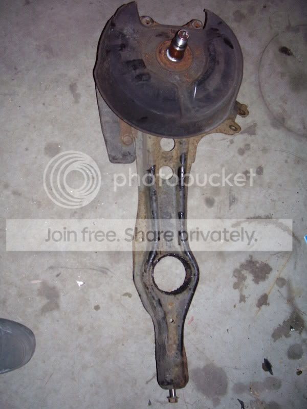

with the CRX SI LCA
Modified by b16a1eg6 at 5:28 AM 3/17/2008

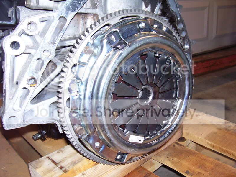

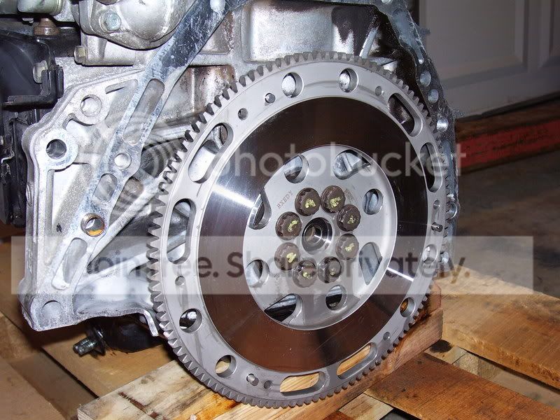

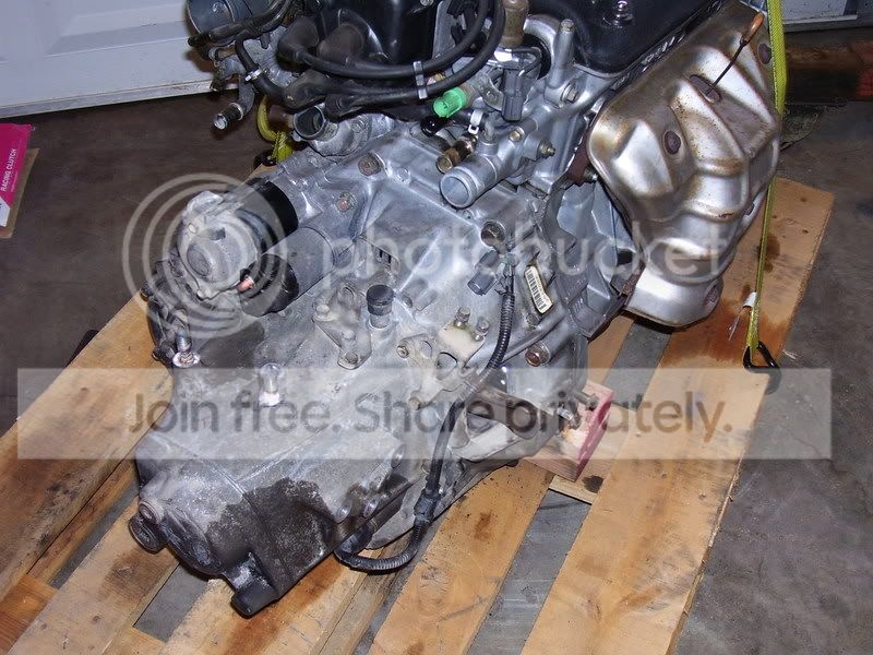

Flywheel installed
Clutch installed
Trans bolted to engine
Cable to Hydro Conversion installed

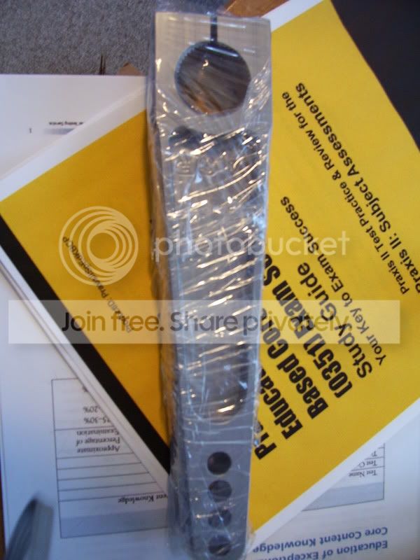

Coming along nicely. How much was the asr rear subrframe bar if I may ask?
Old Mar 17, 2008 | 11:30 AM
b16a1eg6's Avatar
Posts: 379
From: augusta, maine, usa
Default Re: (thevtecnician)
$510 from King motorsports

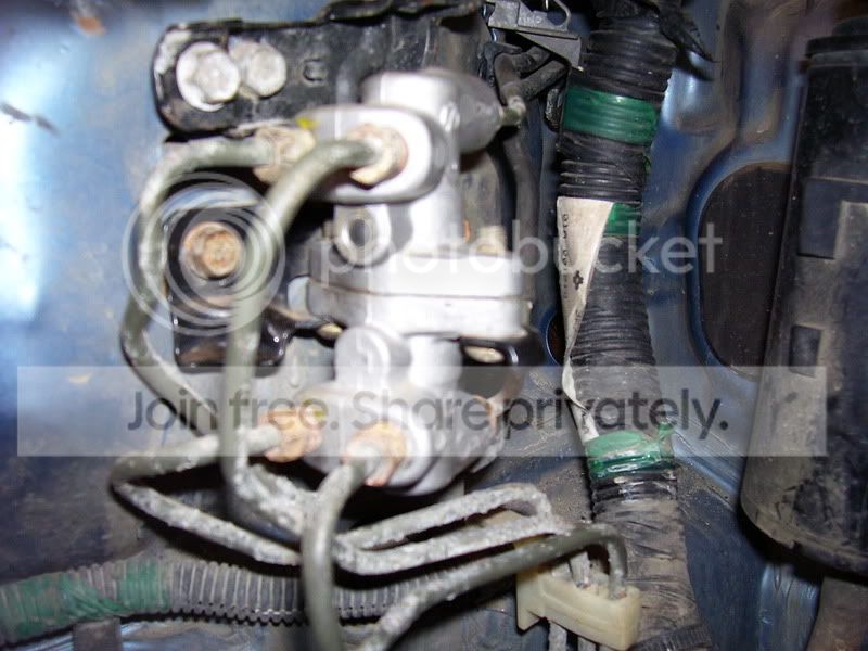

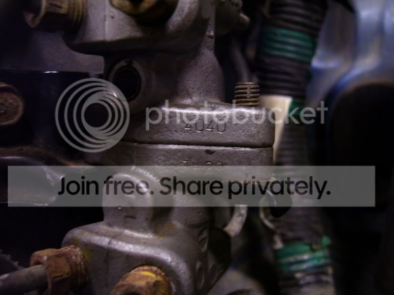

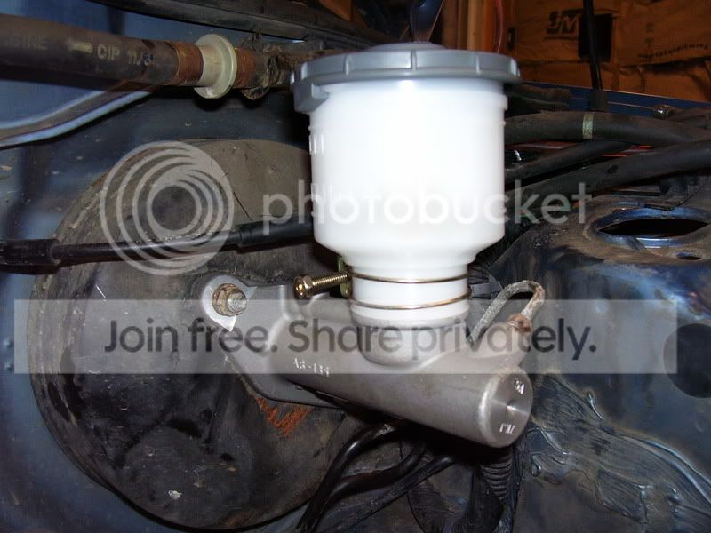

Installed a 15/16 M/C last night;
And a 4040 prop valve
