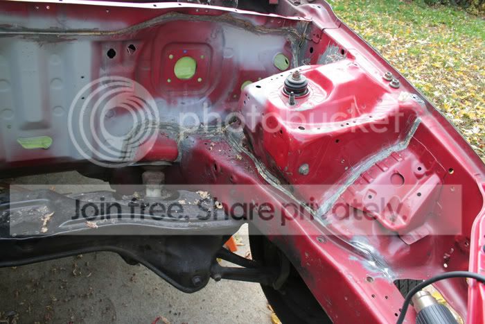

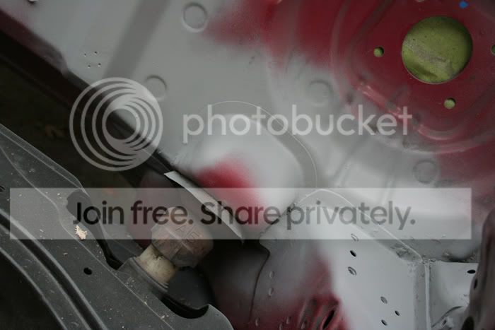

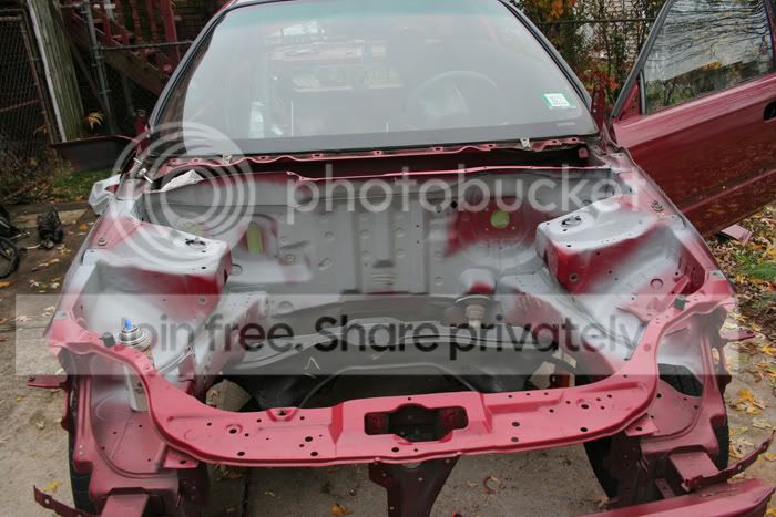

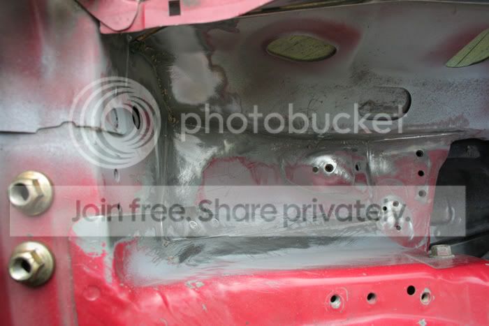

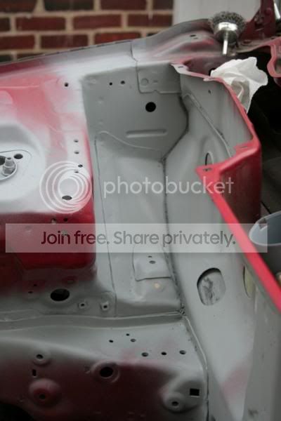

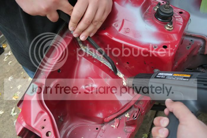

<FONT SIZE=""6""><FONT COLOR=""Red"">Update</FONT></FONT>

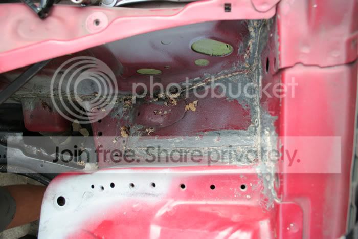

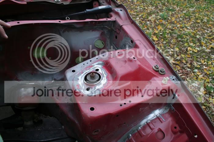

I got more progress done in the engine bay the other day.

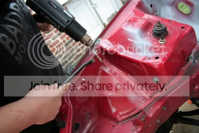

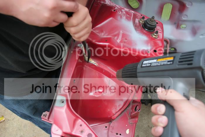

I removed all the factory seam sealer.
Heat gun and pry bar works wonders.

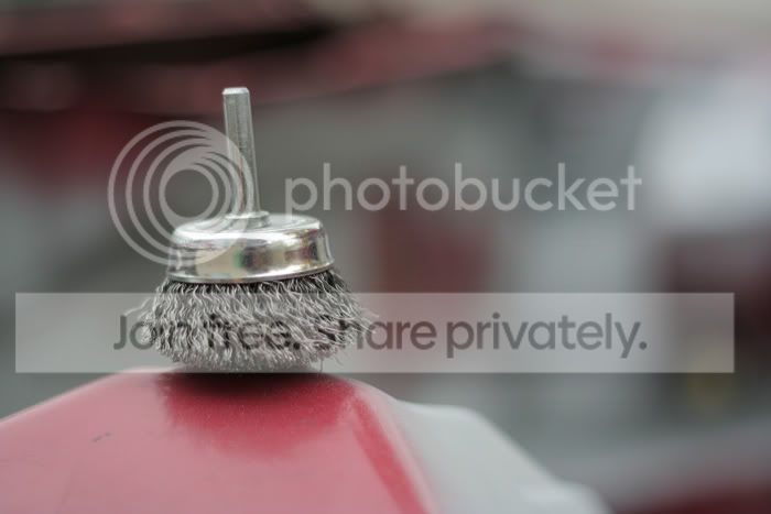

Then just finish it up with a wire wheel.

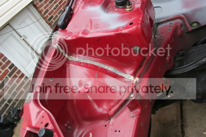

I'll be laying down some new seam sealer back down. Just only behind the strut towers.
Enough talk here are some pics.
Keep in mind still not completely done. Still have to lay down the new seam sealer. The car should be at paint by Friday. :goodjob:
An extra hand is always good.

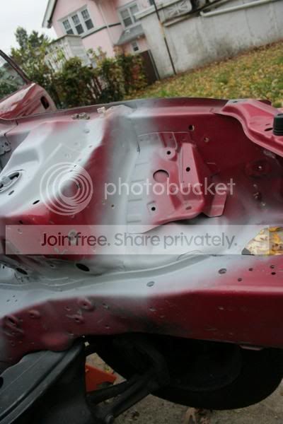

What a mess!!!!

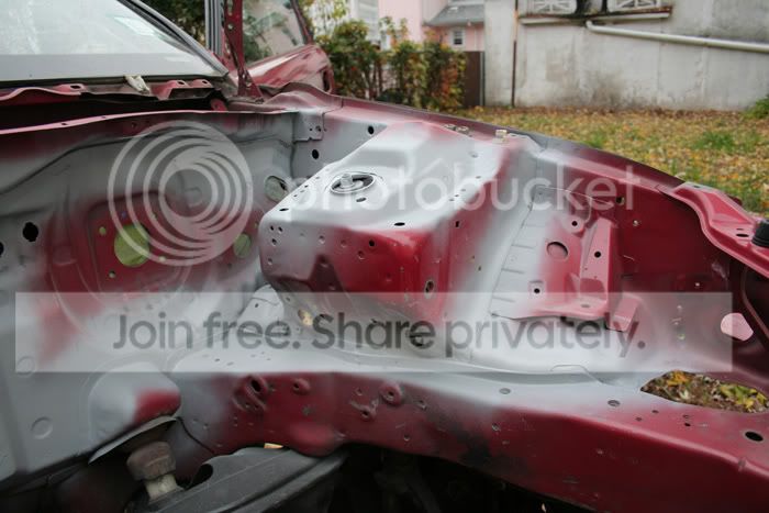

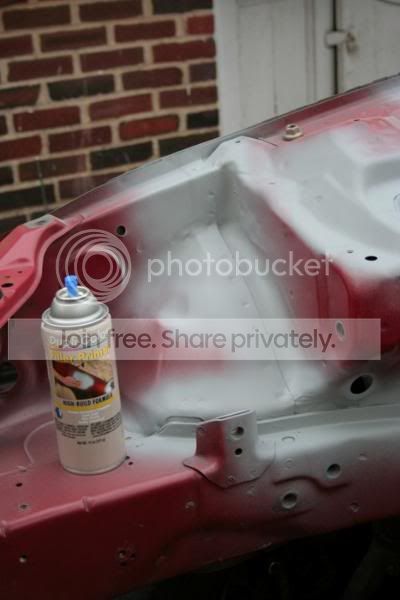

Can't forget the sealer on the strut towers.

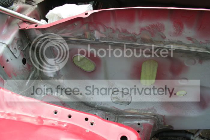

Laid down some primer just the keep it from rusting.
The body shop will handle the rest.
Keep in mind I'm no body work expert.

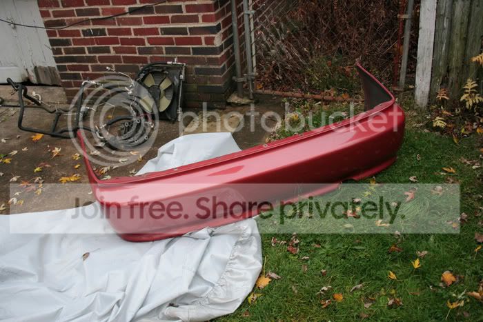

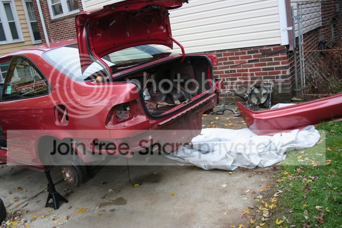

Just removing a few more items before paint.
I was going to remove windows but, storing them would suck.
So I'll just have the shop deal with that.

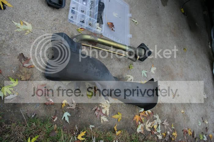

Gas Tank filler neck.
Thats all she wrote.
