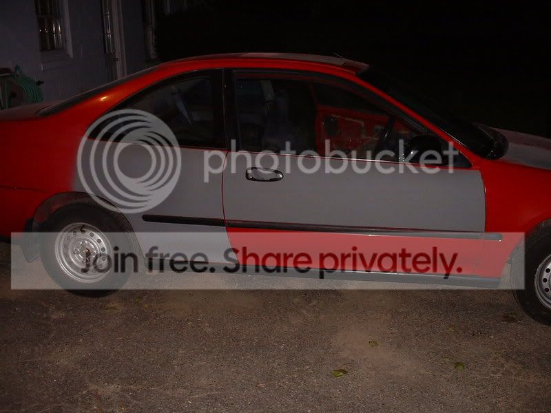

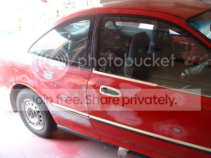

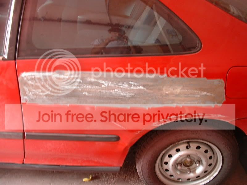

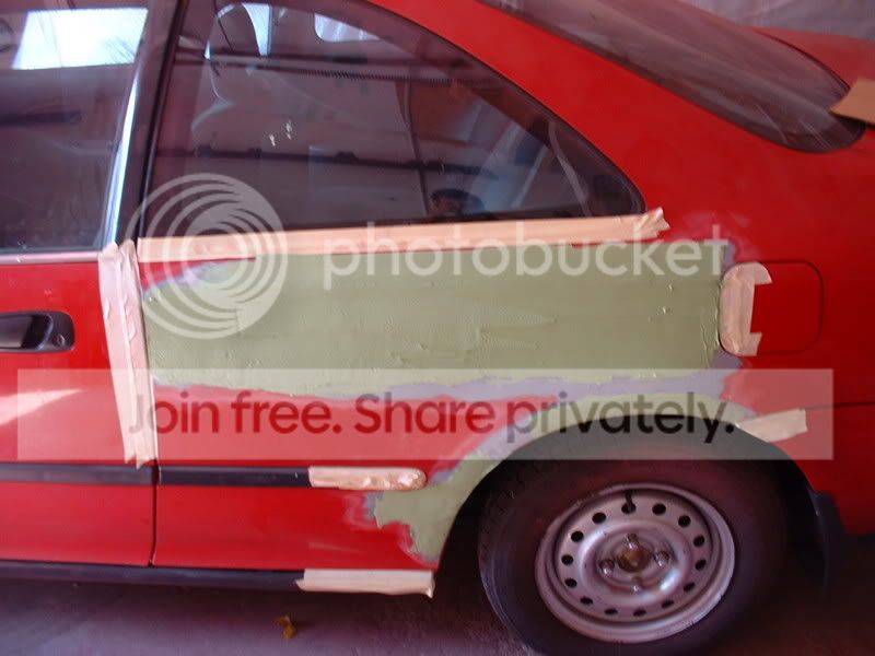

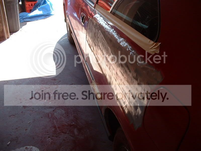

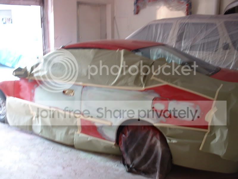

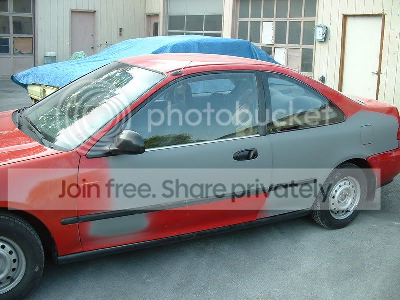

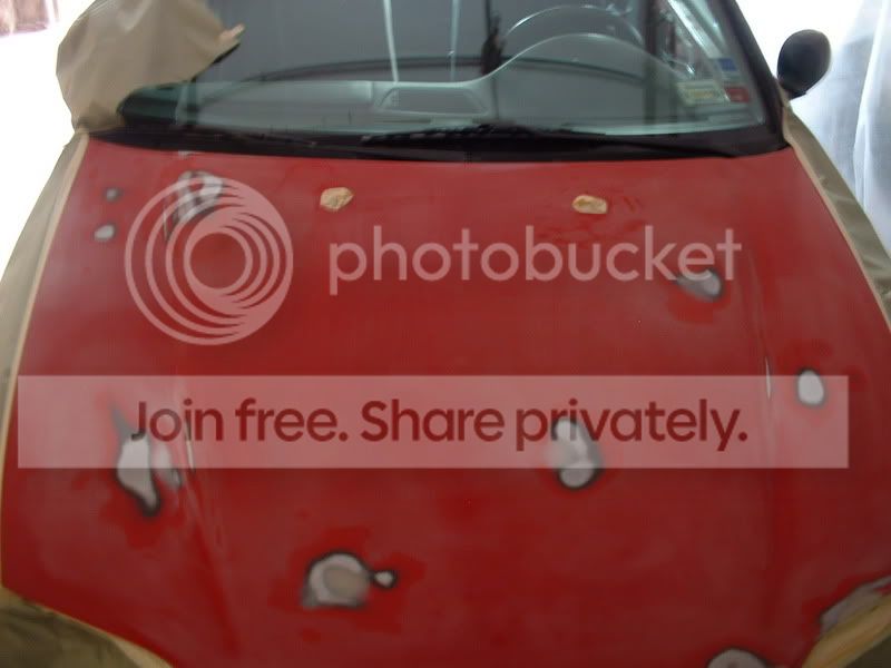

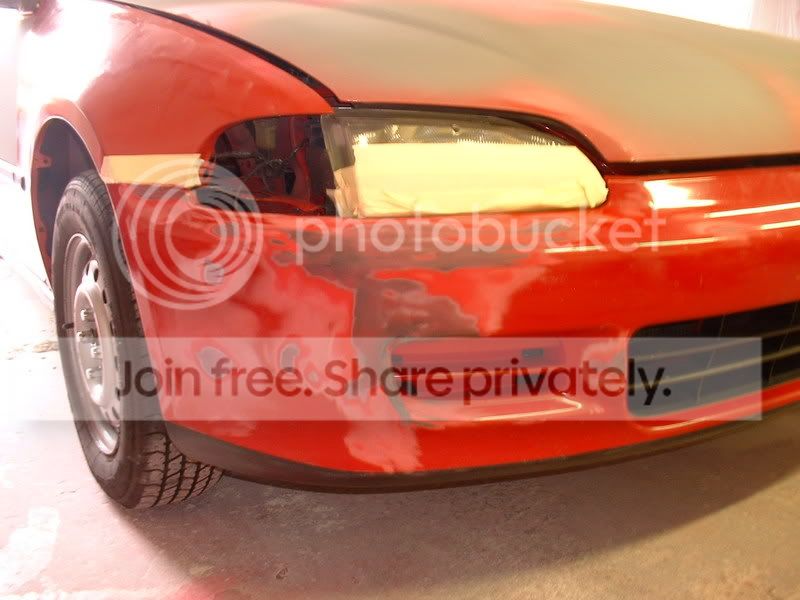

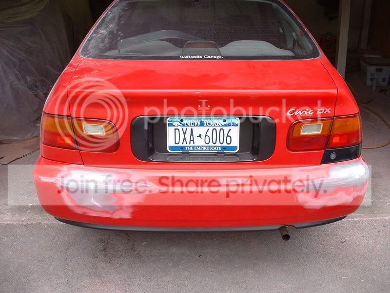

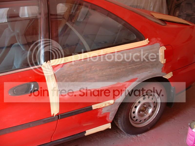

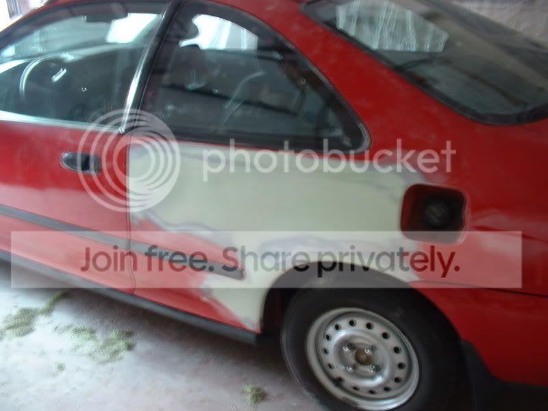

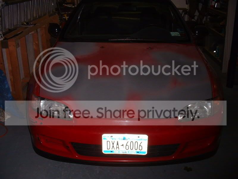

So this week after saving up some money, I decided I was going to paint my car. I got a job at a body shop about 3 months ago and have been learning as much as possible since then. On Tuesday I brought my car to shop and started on the body work and Im trying to take as many pictures as possible. Excpet for the fact that i forgot to take close-up before pictures of the dents oh well.
--Tuesday Grinded down the area of the dents on the quarter.
--Pulled the dents (they were pretty bad)
--Applied the filler.
--Sanded it down.

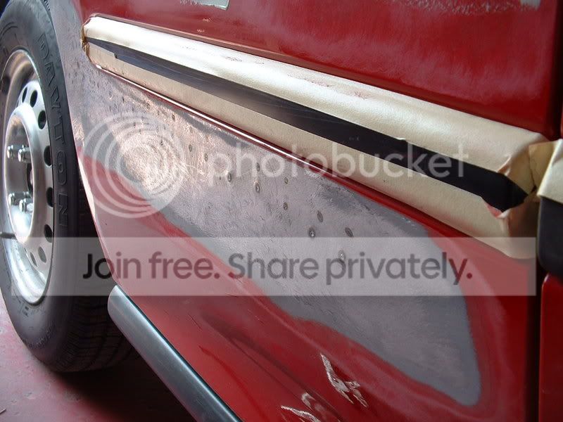

--Wednesday, started grinding down the dents on the door.
--Sanding down the filler.
--Everything sanded and ready for primer.

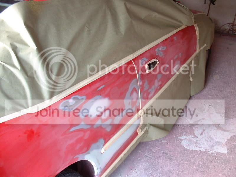

--All primed.

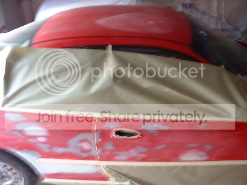

--Thursday, started the dents on the passenger side door/roof.
--Pulled the dents on the lower part of the quarter.
--Hood, Door, Roof, ready to be primed.
--All primed.
--Tomorrow I will be doing the body work on the front and rear bumper and then wet sanding the car to get ready for paint.

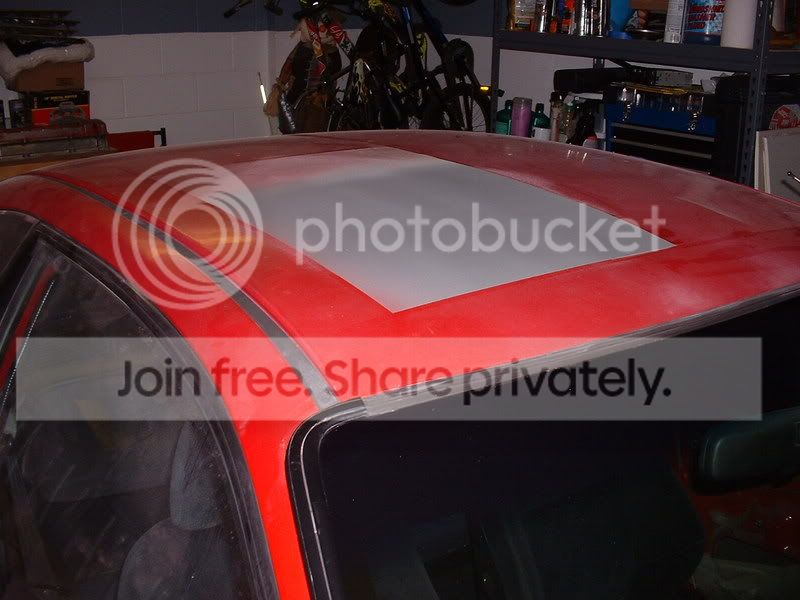

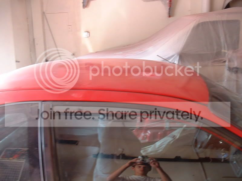

never do hard tape lines like you did on the roof because they might show through the final paint.
looks good and good luck

<TABLE WIDTH="90%" CELLSPACING=0 CELLPADDING=0 ALIGN=CENTER><TR><TD>Quote, originally posted by built562 &raquo;</TD></TR><TR><TD CLASS="quote">never do hard tape lines like you did on the roof because they might show through the final paint.
looks good and good luck</TD></TR></TABLE>
Thanks, and I think I will be good though once everything is wet sanded those lines will be gone.
Old Aug 30, 2007 | 07:13 PM
Bigblockhatch's Avatar
Posts: 297
From: Johnson City, Tn, USA
Default Re: (SHG_Riley)
<TABLE WIDTH="90%" CELLSPACING=0 CELLPADDING=0 ALIGN=CENTER><TR><TD>Quote, originally posted by SHG_Riley &raquo;</TD></TR><TR><TD CLASS="quote">
Thanks, and I think I will be good though once everything is wet sanded those lines will be gone.</TD></TR></TABLE>Wrong...You can never get rid of HARDLINES completely..You need to block it and then reprime and block again.You should always roll and edge 4-6" from where you plan to stop primeing to keep from having a hardline.

Alright, thanks for the info, well see how it comes out tomorrow.

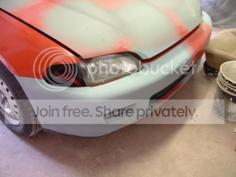

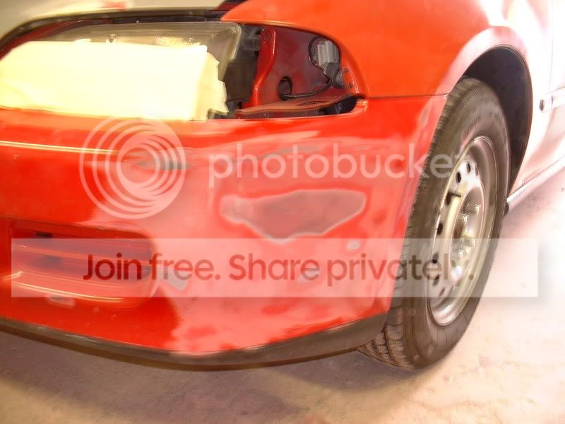

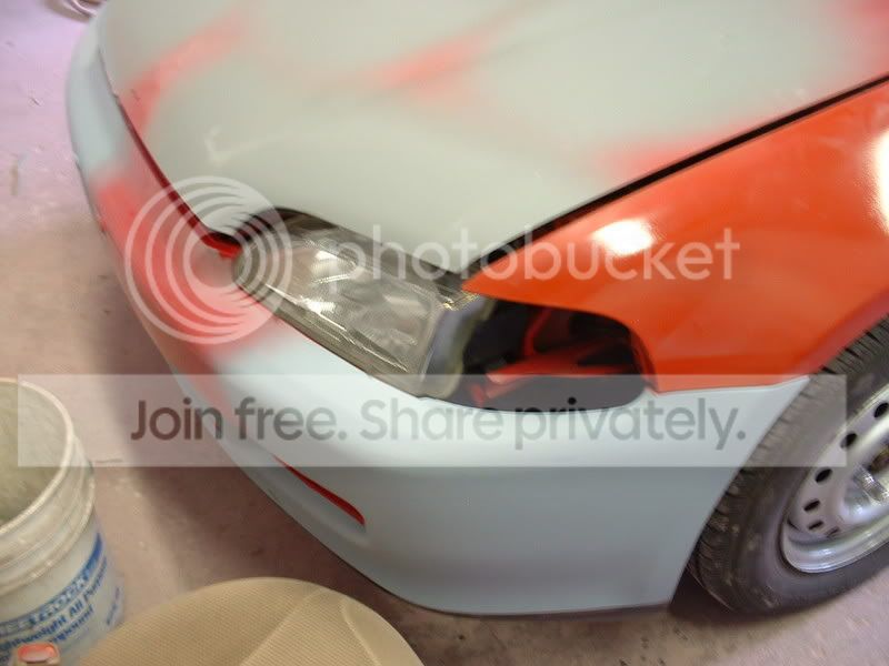

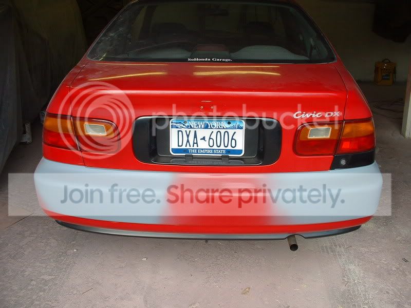

Today was kind of a slow day, very tired, and a little behind schedule. Theres always more and more things you run into.
--Started on the front and rear bumper.
--Front and rear bumper primed.
--Thats all for today, tomorrow wet sanding the whole car and going to tape it up for paint, if theirs enough time might be spraying it, but most likely Sunday.

Ok, here it goes. If I recall correctly, primer traps in moisture and can actually cause the build up of rust... pretty fast. Look into that a little more on the net, there might be something better to use for the time being. I'm not 100% sure that was what I remember correctly so take that for what its worth.
Don't do that, no matter how much you sand the area down and it feels smooth, it won't be smooth when you paint it. Your going to see the square marks when you paint it... ask me how I know . What you want to do is sand the whole roof down, yes more work but in the long run it will come out better.

That's what ive heard too, not to tape off like that, when touching up a spot or when doing anything i guess... owell, im sure it will come out awesome.... it would probably help to prime around all those hard lines, fade it out, sand, prime again, sand. idk, seems like that would help fill in the difference.

I wouldn't use a grinder to get the paint off. It is a hassle feathering the deep cut.
