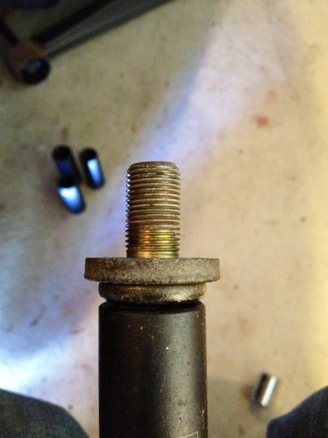

Since the EG is down the mean time, I have the opportunity to do some side work on it while the parts are on their way so Monday I started cleaning up my Function and Form Type Is and got 1 disassembled. Since they will be going back in the car for the winter. Look at them and you will see why. I want my N+ to stay mint so having the F&Fs as a winter setup on winter tires and decent wheels is a nice setup IMO!
The perches are obviously seized but WD40/PB Blaster and a heat gun never fail. Slowly heating around the perches makes them expand and with the help of a flathead+hammer they come loose. 2 spanner wrenches spinning opposite of one another unlocks the upper and lower perches.

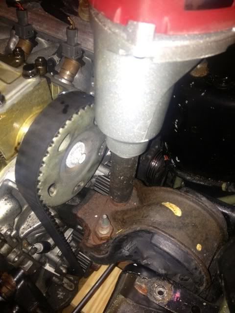

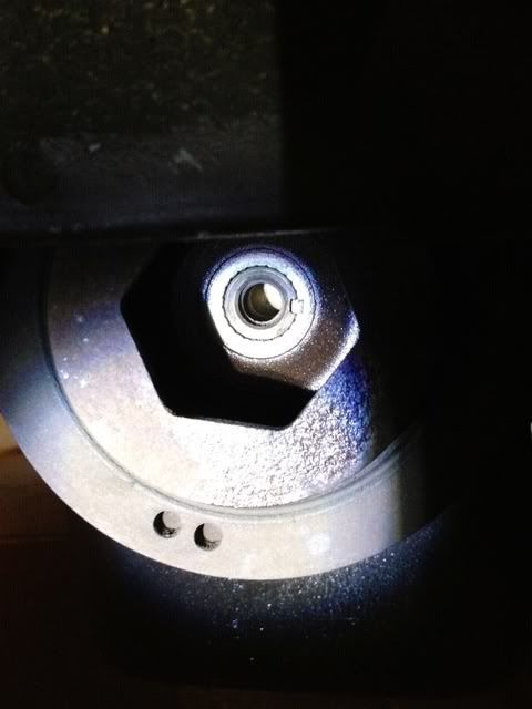

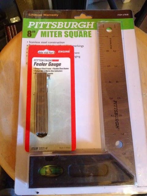

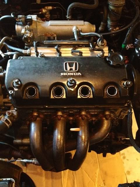

Update:
I sold my Cobra Imola 2 bucket seat this weekend and also picked up some new tools/supplies. I got a straightedge and feeler gauges to measure any warpage on the head and block, 7mm thick nitrile gloves, 230 ft-lbs electric impact wrench and a 16,000 btu propane space heater. Now I just need to pick up a propane tank.
I needed go get 1/2'' extensions to reach outside of the wheel well for removing the crank pulley bolt but instead I opted for the impact wrench. If it didn't work then I could just return it. I used it to remove the lug nuts and they came right off. I jacked up the drivers side and got to work on the crank pulley bolt. I was expecting a challenge but I soaked it in WD-40 and used my heat gun on it for a little bit, then got my 17mm impact socket with impact wrench on it and it fought for half a second and came off. Cake!
Notice the little pin inside there. Its called a woodruff key, don't loose it!

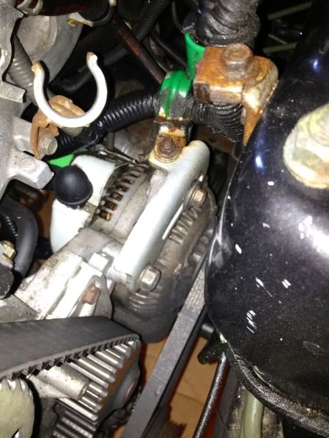

Now that the "difficult" part was out of the way, I jacked up the car all around to the highest setting so that theres good room to work with underneath.

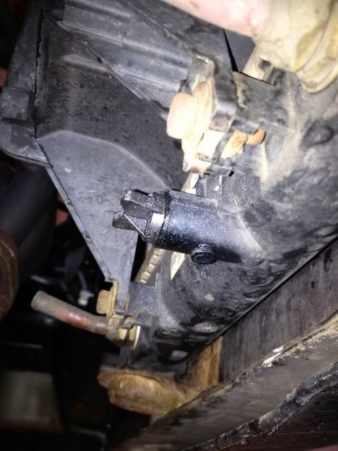

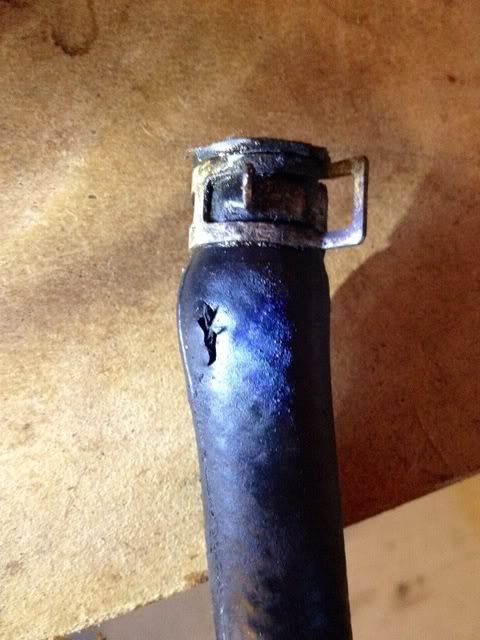

First things first, disconnect battery ground and drain all the coolant (remove the wingnut) and remove radiator hoses.
I took off the heater hose as well (goes in above the tranny) and surprise surprise.
It has a nice hole in it like I had suspected. It explains the coolant loss but I am I still confident that the headgasket is blown due to the loss of power and felt like it was hydrolocking. However I ended up forgetting to order a new heater hose even though I got new radiator hoses so I will need to place another order. I called today to check the status and its all ready but being held up by the timing cover that they are waiting for. I still have to get the head checked so the parts wait isn't causing a delay yet.
Next I took off the spark wires, plugs, intake, VC bolts and ground.
Cruise control box out.
Alternator bolt loosened and belt removed.

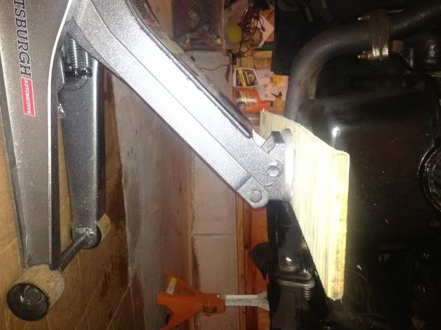

Oil pan supported.
Motor mount out.

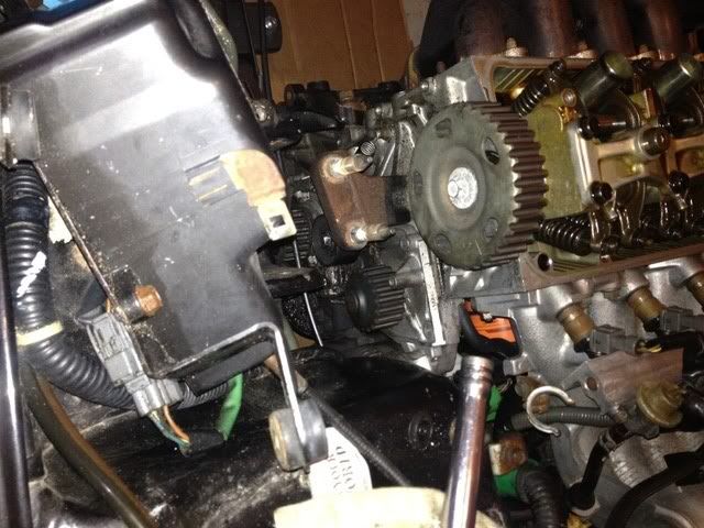

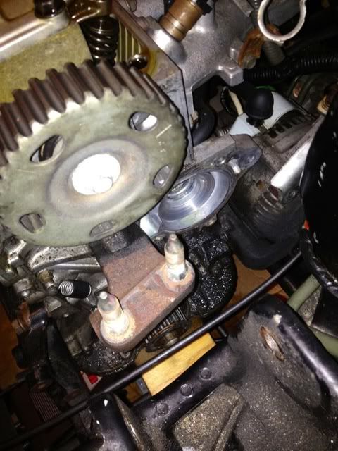

Pulley off and timing belt out. Now is where things get fun, the tensioner bolt gets rounded off for no reason and I'll need bolt extractor sockets to get it out. Good thing I ordered a new bolt but this sucks. Wasn't expecting an issue here. No biggie.
Onto the next, water pump. (If you ever do this make sure you have a bucket under for coolant to fall on)
Throttle cable comes off, injector harness, PS cable and fuel return pulled from intake manifold brackets and fuel cable to the rail (coming from the fuel filter).
Then I removed every plug attached to the manifold. Probably some 8 plugs like distributor, map sensor, VTEC solenoid, etc.
Now I need to remove the header but one of the bolts that connected to the cat is stripped because it won't loosen or tighten, it just spins (I already knew this going in). I ordered a new bolt/nut for it and just need to take a sawzall to cut it off.
After thats done the head can come off and be checked/sent out. In the meanwhile I'll get a propane tank, place the new order and deal with getting the tensioner bolt off.
More soon...

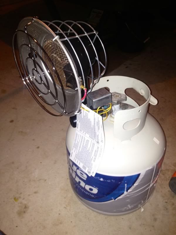

Update:

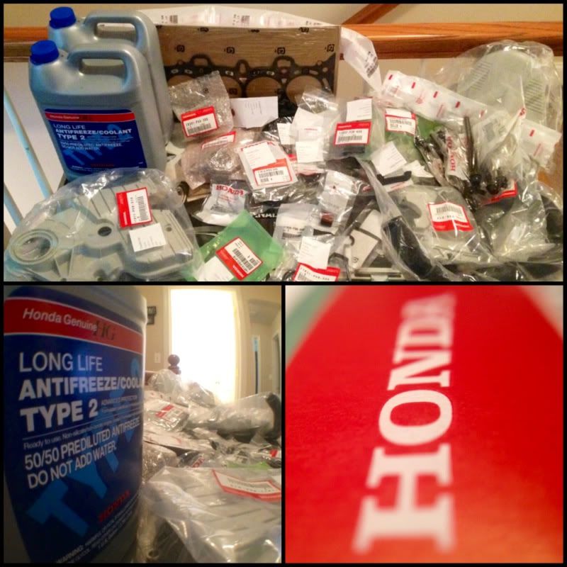

My Honda order came in
I went ahead and picked up a propane tank as well. Haven't needed to use it but will be trying it out today. "We ain't cold no more either breh"
Borrowed a sawzall from the homie to cut the old header bolt off and an o2 sensor socket that slips over the o2 sensor wiring and with a little heat and WD came off.
So the header is out and all that needs to be done right now is remove the head bolts and pull the head to send off.
The tensioner bolt is turning out to be a headache. I borrowed a bolt extractor kit but its very hard to lock it in the bolt because there isn't enough space to hammer it. I'm going to give it another try but if that doesn't get the socket in then I'll have to drop that side of the motor to get access, hammer it in and use an impact.

I dropped the drivers side of the engine down to get better access and still couldn't do it so I'm picking up a propane torch today and hopefully that does the trick.
I also got a quote for the resurface and will drop it off today or tomorrow.
I am also placing an for more parts today since I didn't order the heater hose and I need to remove the intake manifold for the resurface which I didn't think would be needed so I'll need a new gasket for that as well.
My goal is to have this buttoned up on Thanksgiving but if not by this weekend at the latest.

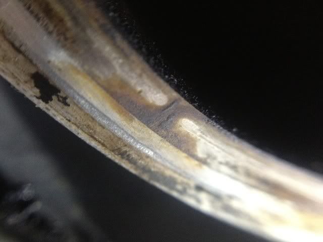

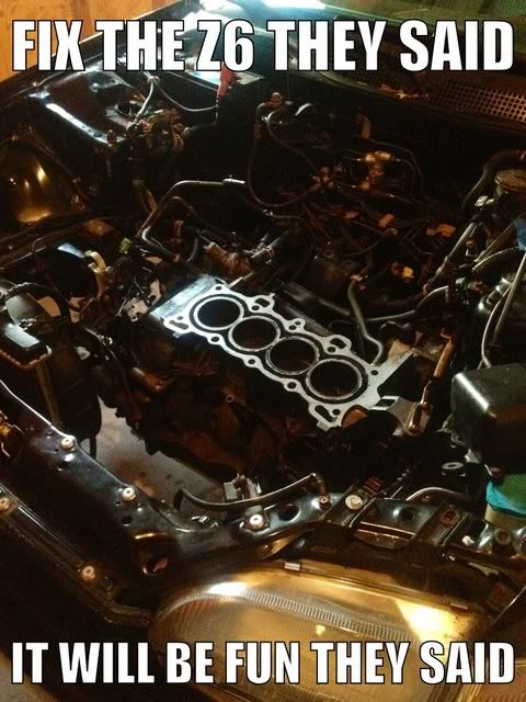

Update:

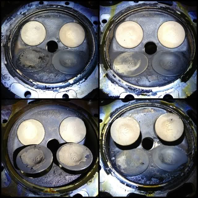

To sum up the issue, I'm pretty certain of what happened. Somehow my heater hose got cut, coolant leaked out, engine overheated and as a result the HG blew. The HG was a secondary problem so I would say that this was partially my fault. I pulled over quickly but should of just stayed there until I got some water instead of limping the rest of the way to work stopping and going for a little bit every 15 minutes.
Anyways, I got some work done on Tuesday. I unbolted the headbolts 1/3 turn each at a time as indicated in the Helms manual and then careful not to scratch the block I gently took the head off.
Then I unbolted the intake manifold off and inspected the combustion chamber.
In the bottom left picture, you can see where the HG was leaking. In the bottom middle where theres some extra oil. The HG was a little bent in that same spot. As far as I know this was the only place that it was leaky but it could have been in other places as well.
Upclose on the block. The only area that has deposits like that.
I then got to business and checked the block for warpage and it was fine. Then I checked the head according to the manual and it was within the .002mm limit. I wanted to be 100% sure so I took it to my local machine shop and the guy there was pretty cool. He checked it and said it was good everywhere and in the worst parts if was just under .002'' if not at .002''.
So it passed the service limit test so I will not be getting it resurfaced which will save me some money but most importantly time.
In the meantime I went and attempted once more to get the tensioner bolt out but this time I brought my friend Mr. Map along
Heated the tensioner bolt very well and it still didn't get the bolt off. My next resort will be to cut off the head, remove the tensioner and then I'll be able to heat the bolt directly at the thread and using locking pliers it should definitely come out.

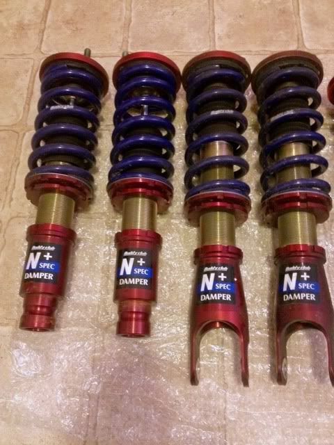

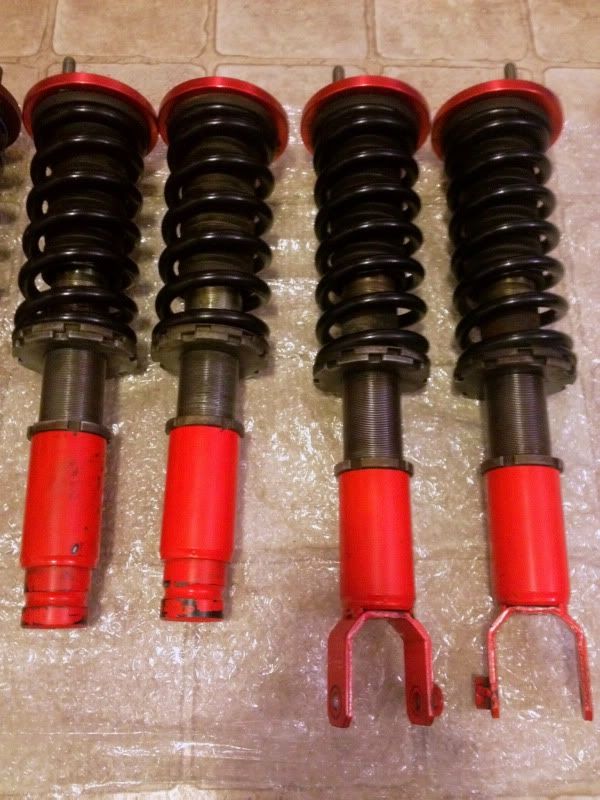

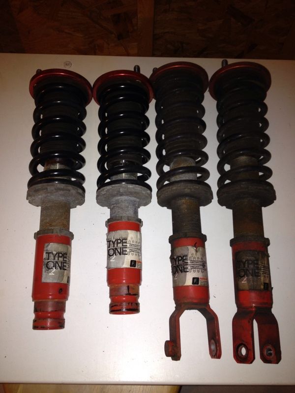

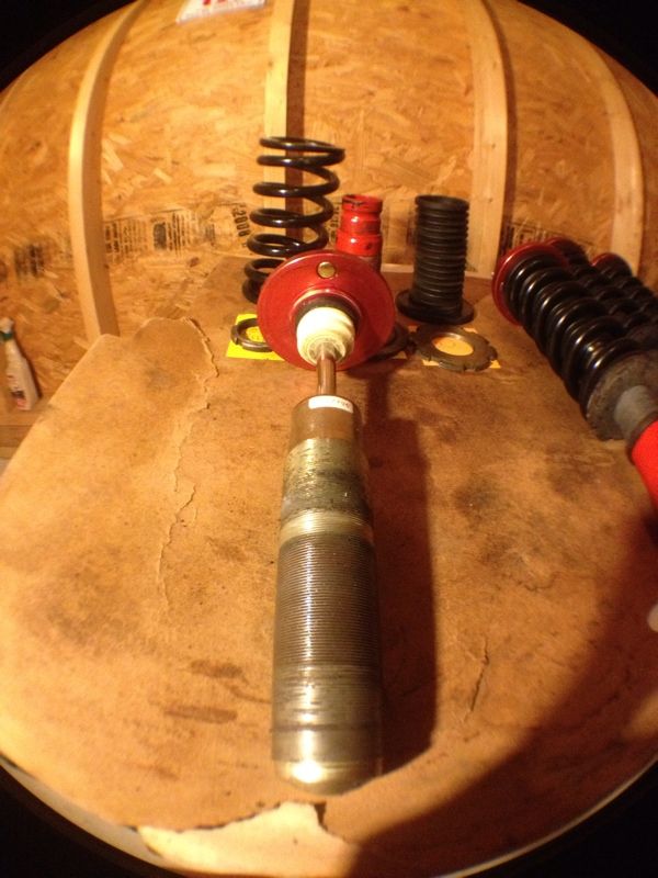

Today I went ahead and disassembled the other 3 F&F coilovers. I cleaned them and lubricated with silicone spray. After I reset the preload and estimated the ride height.
Removed the N+.
I installed the F&Fs and used one washer for each rear side to account for the slightly shaved OEM lca bushing and it fits nice and snug without play.
