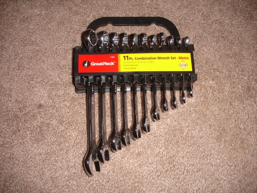

Awesome post man...pretty much hit everything dead on. I have a Great Neck torque wrench and it works fine. I recently obtained a 309 piece Craftsman tool set (wrenches, ratchets, sockets) for Christmas cuz I was tired of breaking cheap tools. It can really be a pain and cause needless bloody knuckles.
One of the best tools in my box is a nice 1/2" drive Husky breaker bar, coupled with PB B'Laster. I haven't encountered a fastener that that combo wouldn't undo (except my axle nut...but hey, that's an axle nut).
Good advice for everyone though man, thanks for the super informative post

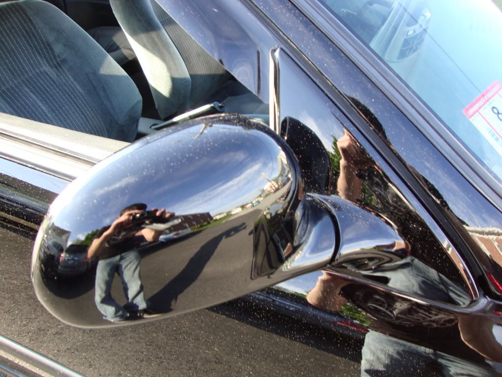

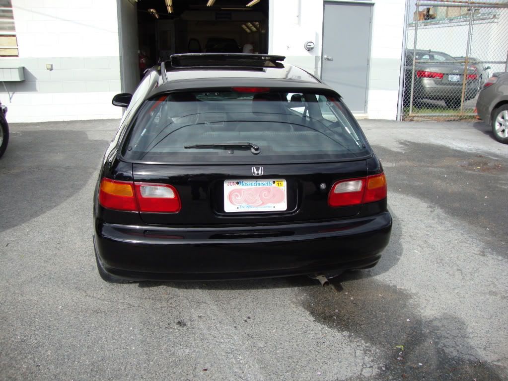

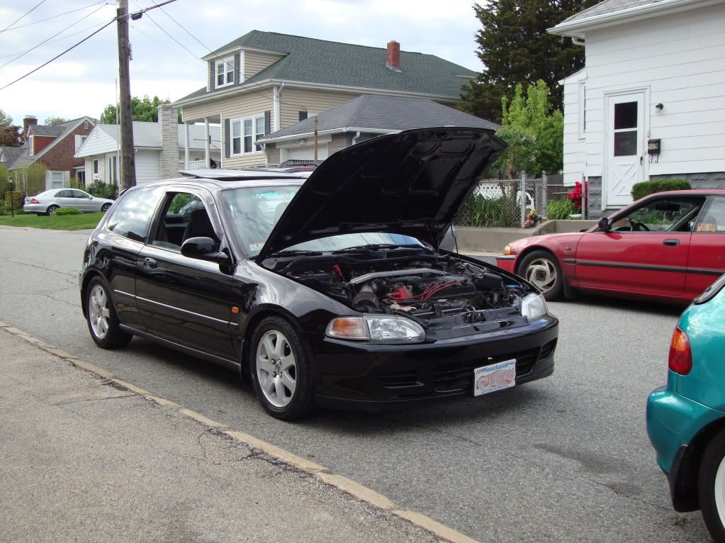

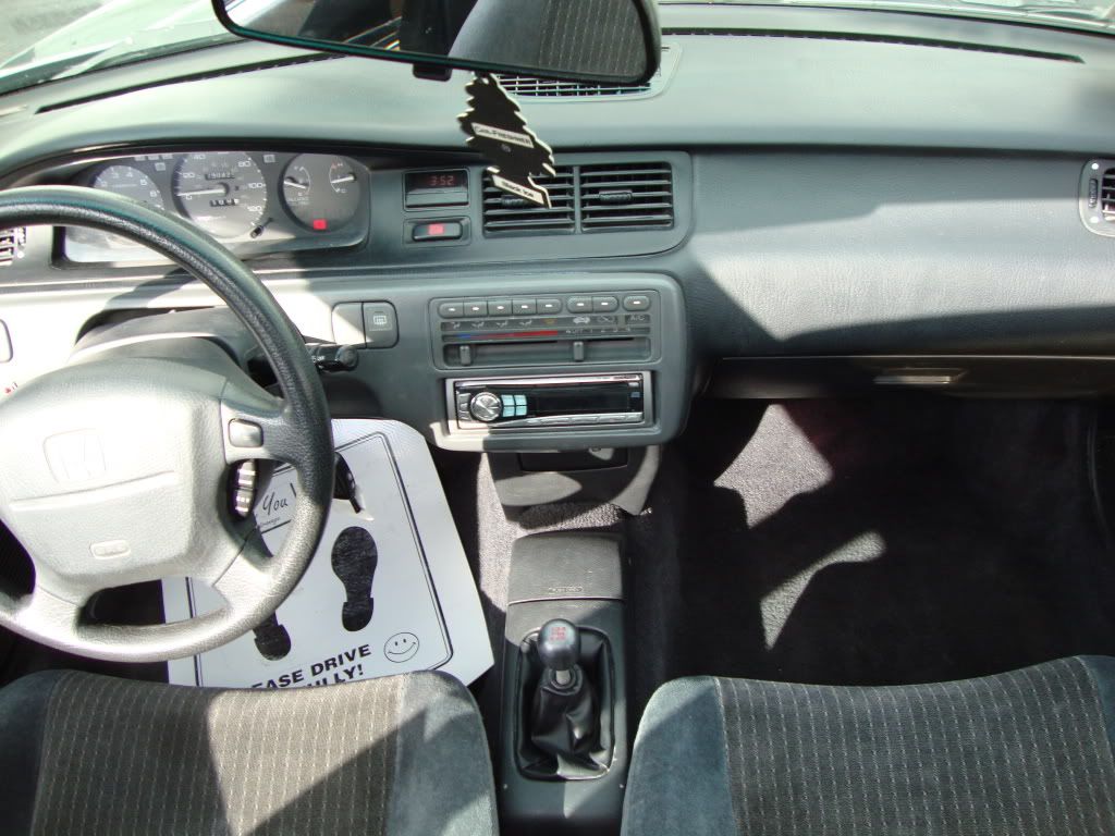

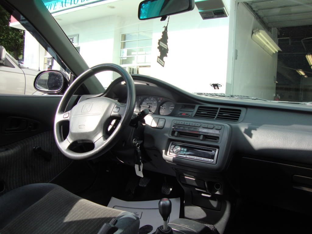

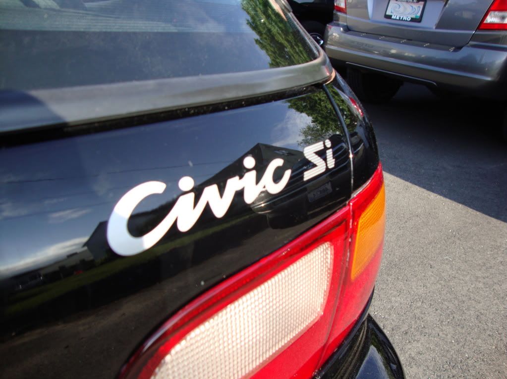

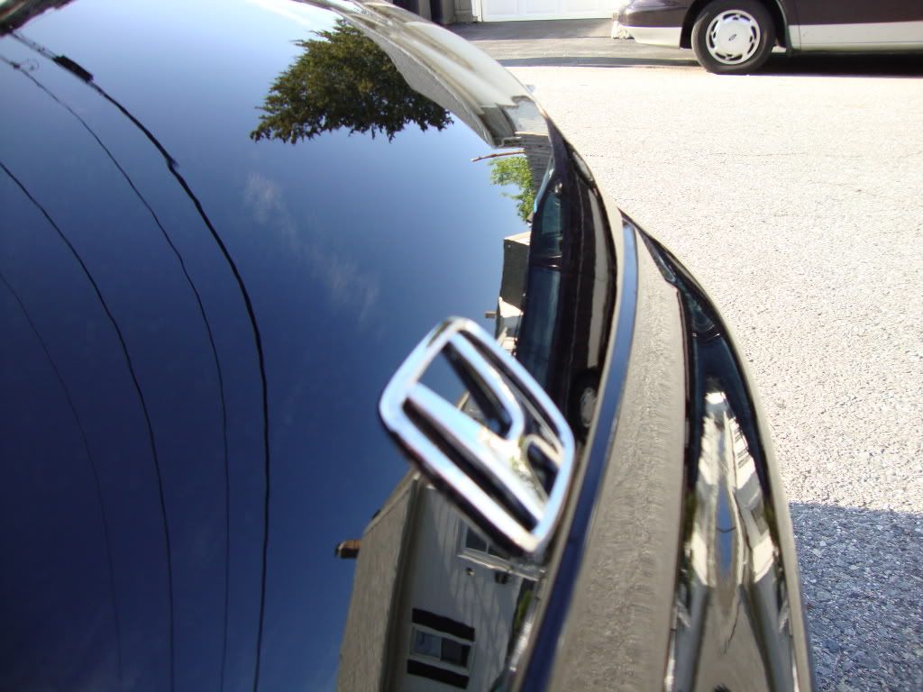

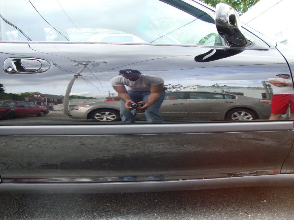

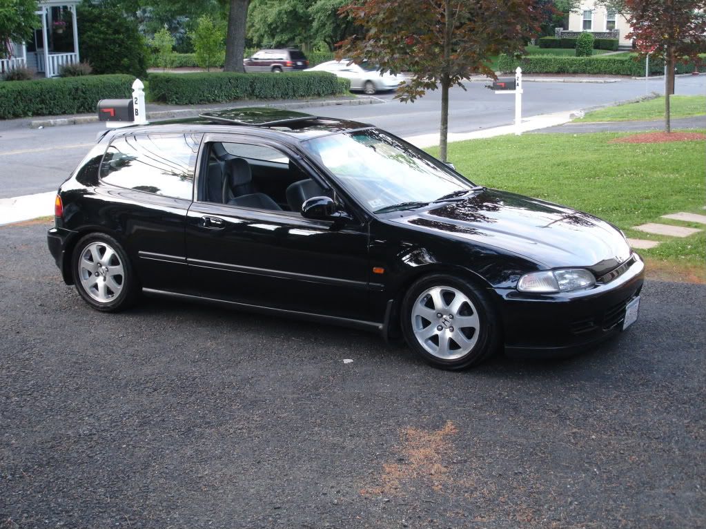

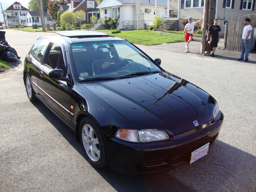

My buddy that gave me a ride to pick up my car from the bodyshop brought his camera and I had completely forgotten about them and I asked him for it and luckily for me he still had em! Here they are, the car looked stunning when I picked it up, I was stoked! Barely any orange peel whatsoever.
I wanted to put the sticker on myself when I picked it up as a finishing touch but realized I should of had given it to the painter lol. So my Jesse's friend's dad used to do bodywork and we drove up the street and he put it on for me =]
Mad dusty already lol... Here are the homies chillin!

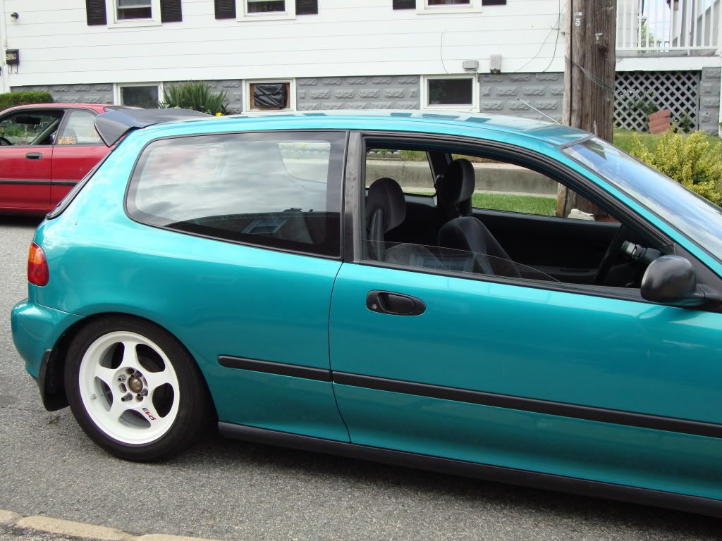

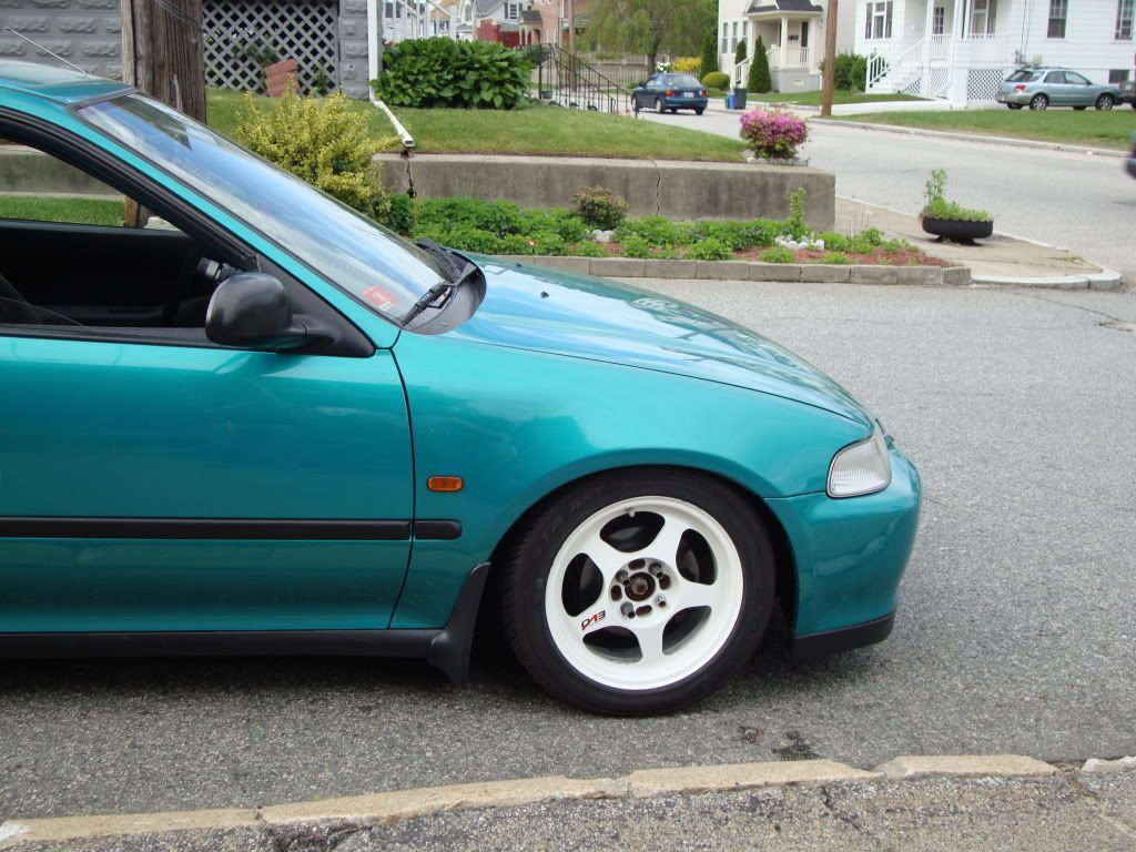

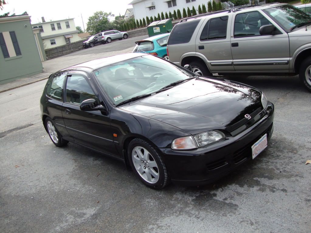

Heres a shot of Jesse's hatch, he had it painted in the same shop, thats why I went there, looks super clean and I don't think it had ever been washed since he picked it up 2 months before lol. Super fresh. They do great work over there.

That shop does good work man, the car looks great!
Old Jan 18, 2011 | 07:25 PM
  #556
fernando.'s Avatar
Joined: Dec 2008
Posts: 4,156
Default Re: HBKFanatic's EG Hatch Build Thread
Wow, both yours and his looks amazing.

Yeah from bimmers to bentleys to benzes and hatches

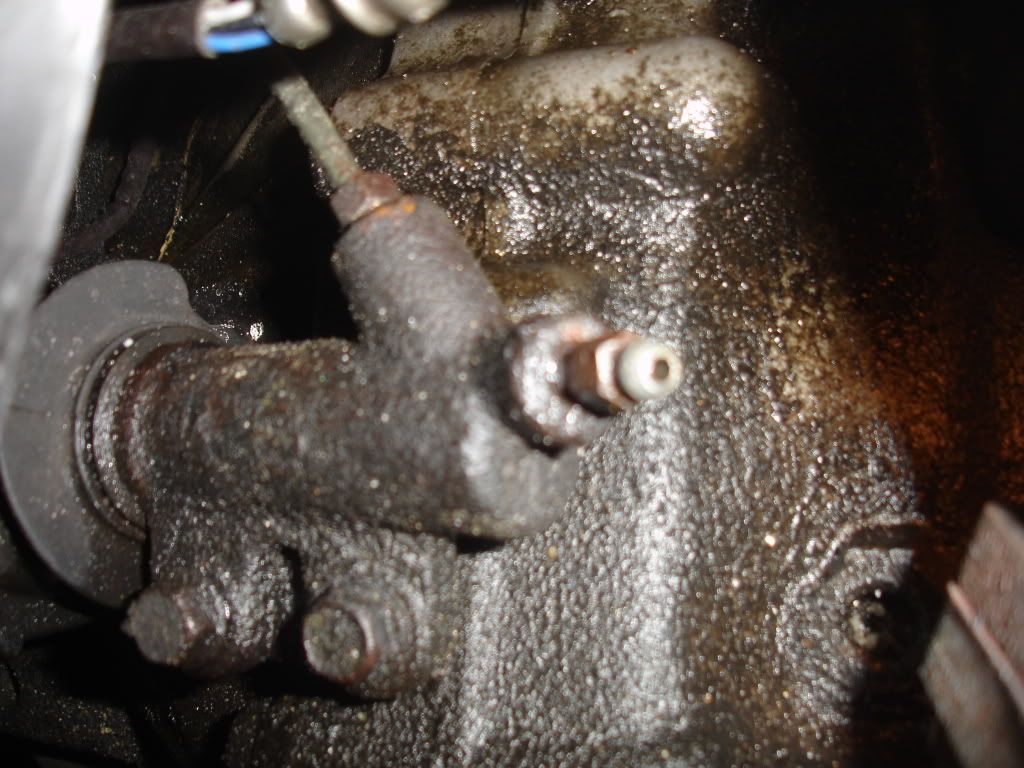

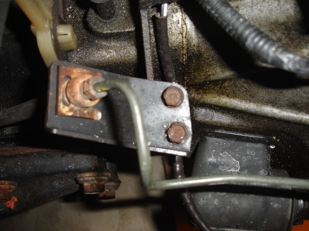

Updates:

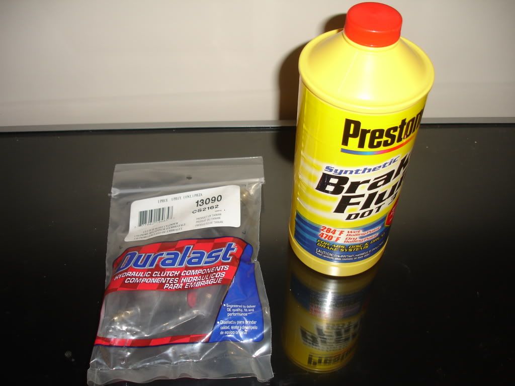

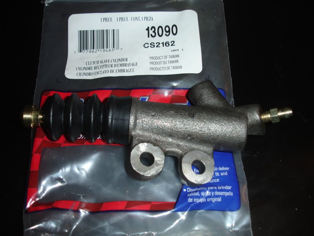

Picked up a new slave cylinder at Autozone for $18 bucks for anyone wondering and a bottle of brake fluid just to be sure I didn't run out but I ended up having plenty.
Should of gotten this a long time ago.

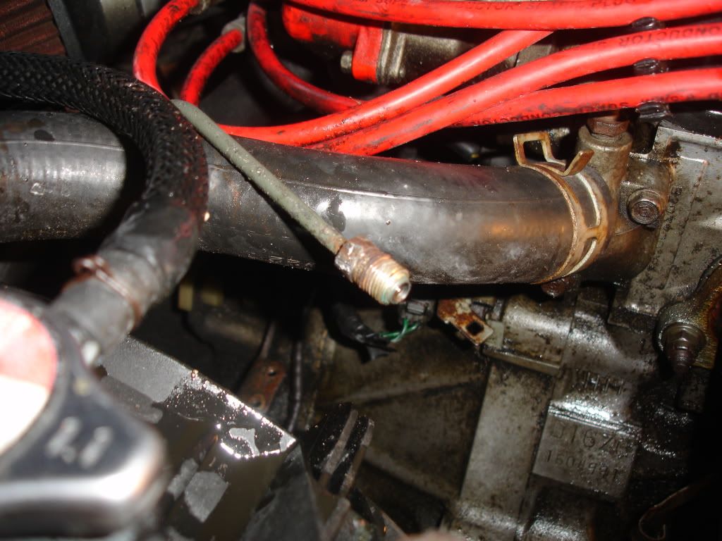

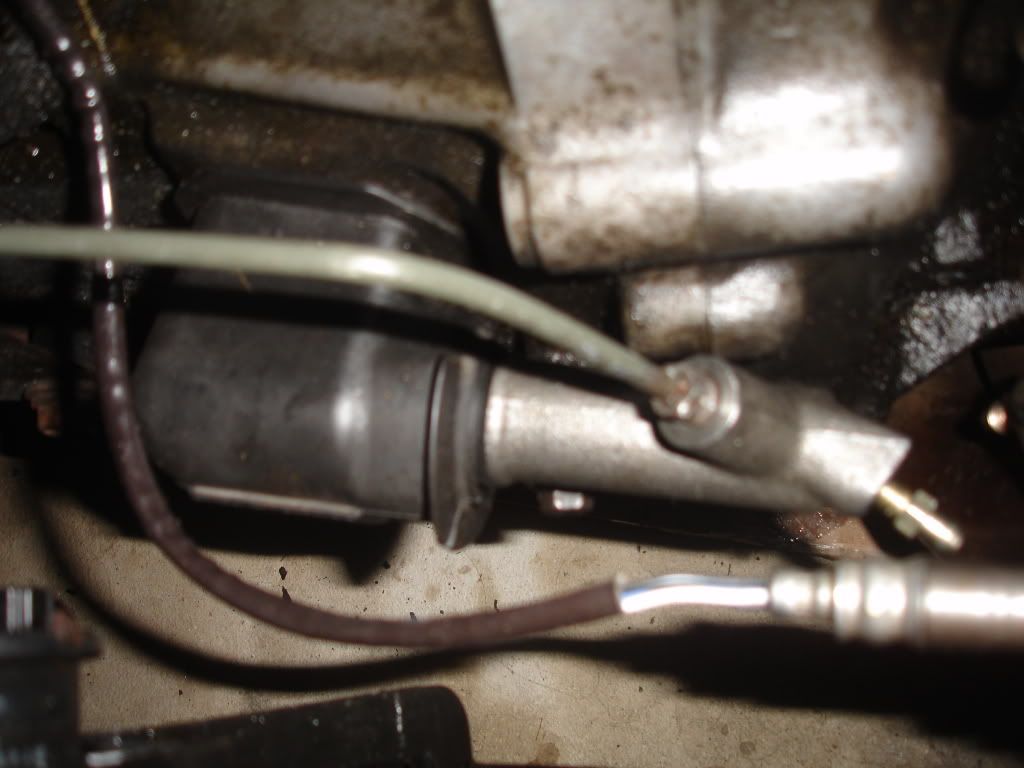

Leaky icky slave cylinder and valve cover making everything super dirty. It was pretty hard to get the line out because it was seized in there and I ended up having to use vicegrips. It was a pain in the *** but I was able to after I sprayed some PB blaster a few times. Overall it wasn't that bad and anyone can do it. Remove those 2 12mm bolts and then the 2 10mm bolts on the line bracket.

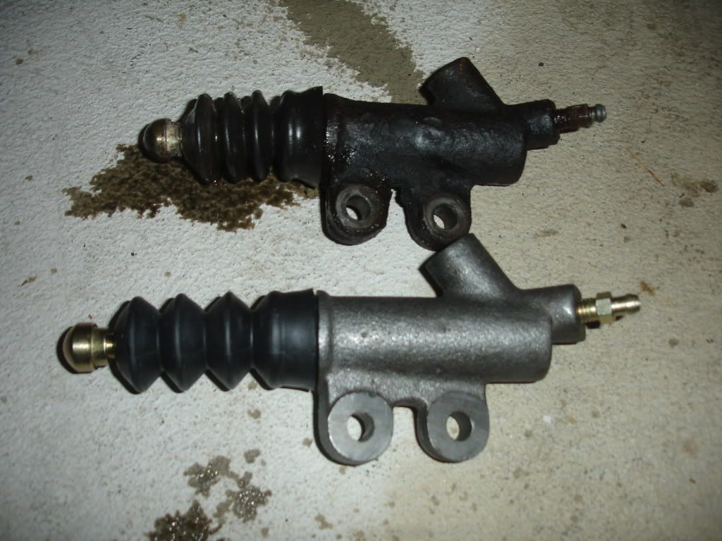

Side by side, no difference. Fits great.
Beat up the fitting nut but it doesn't matter, next time I mess with it is will be for replacing it haha.
I kept having a problem getting the bracket to meet the tranny bracket and I found out it was because the fitting twisted the line a bit when I got it off but I twisted it back and problem solved. Put some fresh grease on the shift fork and put the cover over, tightened everything back up and bled the clutch. Still haven't driven it but its working and no leaks

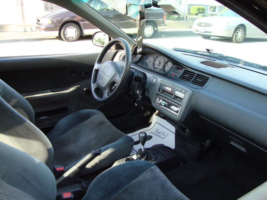

Car is looking mighty fresh man good work so minty I could eat out off it love how your interior is soo clean...

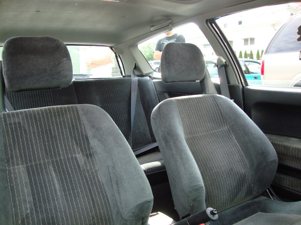

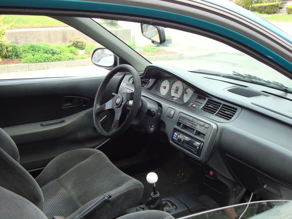

I dont no how you lasted that long with stock eg front seats. I hated those seats with a passion!

Yeah I had a bit of a problem because I have scoliosis and my lower back just hurts sitting on these seats. I was happy to get a bucket seat, it was much more comfortable. They're not that bad though, I noticed that my seats are pretty firm compared to other OEM EG seats. I'll be putting the bucket back in the spring and have been contemplating selling my seat and my interior which would pretty much pay for an EG6 interior conversion. Just not sure if I'm willing to give up my minty interior for a beat up EG6 one. I like the bucket too but just don't feel its right without the harness being tight against my lap. I need to do something like Evan did and get the buckle to mount lower. Ideally I think for a street interior I would love to have some JDM Recaros (black) with the rear ITR DB8 seats. I like how the striped pattern interior looks though and its actually one of the things my car that doesn't really need to change anytime soon.
