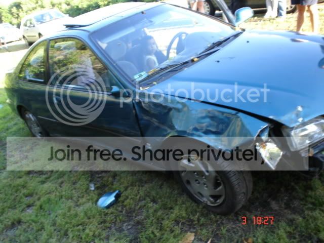

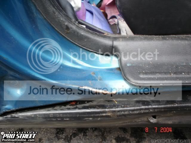

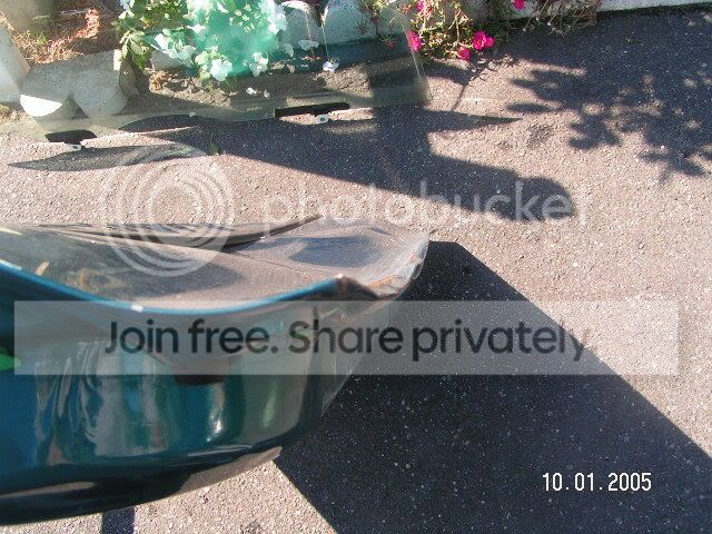

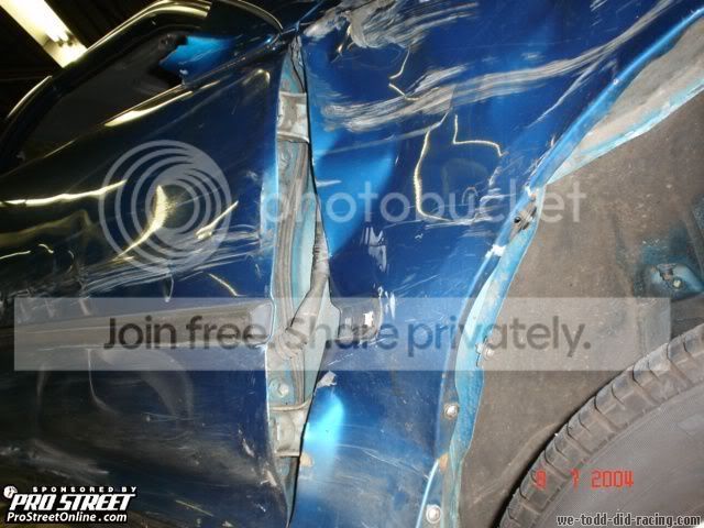

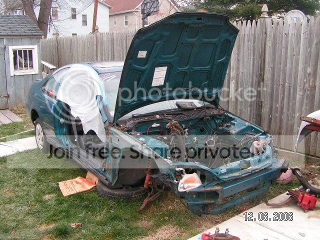

Default Re: (Riced-EL)
<TABLE WIDTH="90%" CELLSPACING=0 CELLPADDING=0 ALIGN=CENTER><TR><TD>Quote, originally posted by Riced-EL &raquo;</TD></TR><TR><TD CLASS="quote">sorry, didnt read it all, but how come u didnt, just work on the green coupe? wats the point of doing everything to the white 1, when the green coupe seemed fine?</TD></TR></TABLE>
This is why
