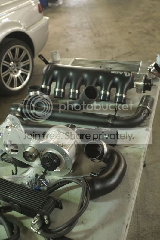

It's an Active Autowerke Gen 3 Level 2 kit with a Snow Performance Stage 2 Boost Cooler methanol injection system.
Install is being completed by Eurowise in Charlotte, NC. Should be done by Saturday granted a few small things I'm waiting for come in and it should be on a dyno the same day. I'll be pushing 9psi and methanol daily.

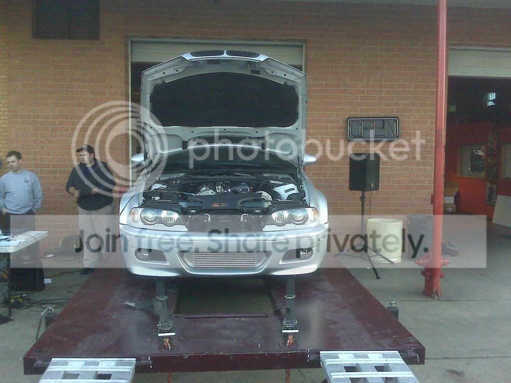

First off ... I need a new front bumper. It was drilled for front plates and I live in a state where they aren't required and when it was being dynod, the tie down straps pulled out one or two of the mounting tabs, hence the driver side isn't fitting that well. Also, the front bumper is covered in bugs

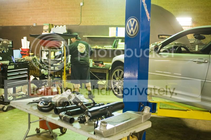

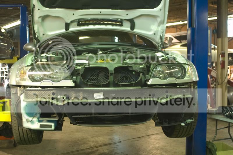

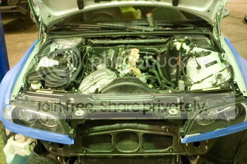

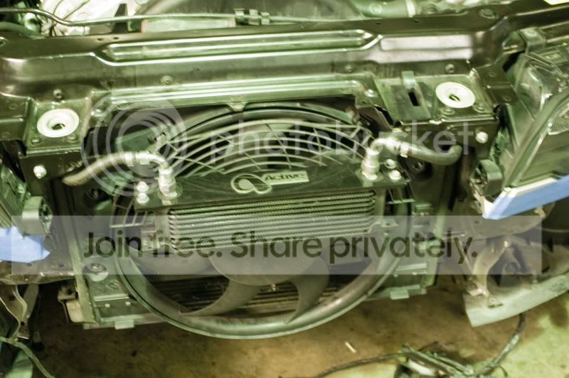

A few new pics..
Meth lines
Meth pump and progressive meth controller and supercharger oil reservoir
light damage on the backside of the intercooler that needed a quick TIG
FMIC mounted up
The "competition" at the shop
Random shop pic

Here she is on the dyno. Had a few problems ... 2 coils burnt out, the AFR was really rich, the meth made me instantly lose 100 ft/lb tq, etc etc etc. I was not impressed at all with the numbers, so I won't even bother posting them. I fixed the coils, put a smaller meth nozzle on, and my fuel adaptation codes cleared by BMW, fixed a vacuum problem from the bypass valve .. and tomorrow I will be back on a dyno to figure out whats going on with my tune. I'll post dynos tomorrow!
