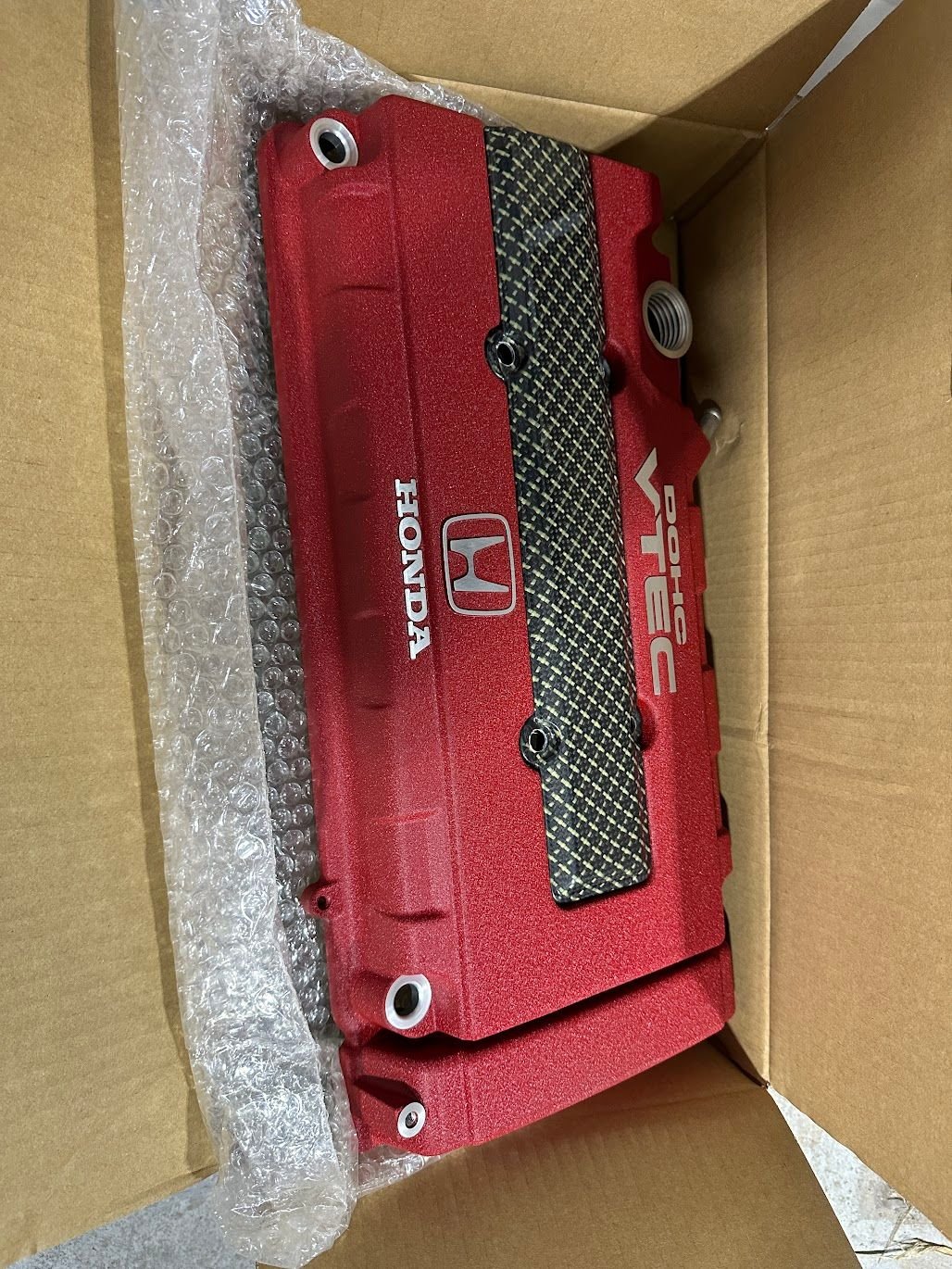

I picked up a new VC and spark plug cover from ICB.

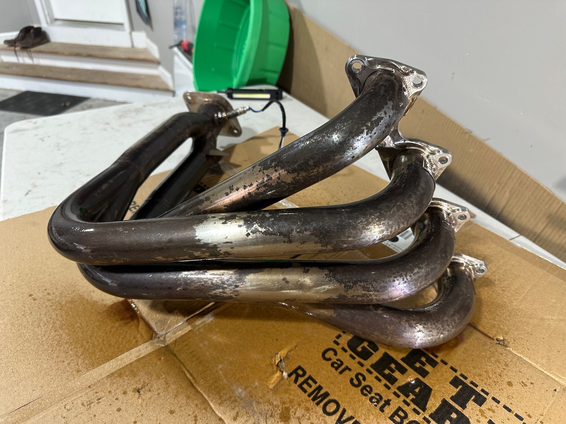

Next up was to address the header. It is a Maxim Works header that has seen its better days. I used a few things to try and bring it back with no luck. I ended up sanding and polishing. It turned out great.
The main issue is the tarnishing you'll see after polishing. Not the discoloration from heat. It seems like something on the metal baked on after heat cycles. Can't seem to figure that out. I cleaned the header really well with alcohol after.
I want to pull it back out and polish it again. Any tips on how to prevent this corrosion-looking stuff?

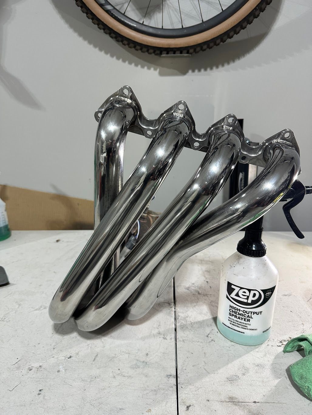

Here is the after! Few hours of hard work paid off.

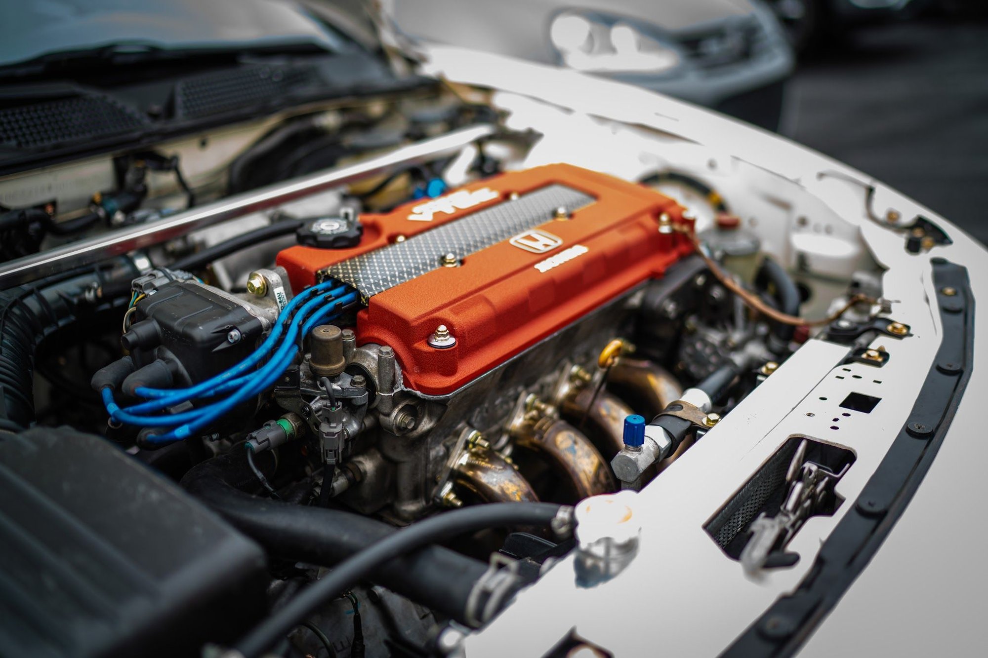

Here is the header and VC installed.
If you look at this photo, you can see the corrosion stuff on the header. This showed up after a couple of heat cycles. Not sure what it could be?

Its possible its just the steel itself. I have a Toda header I purchased brand new, wiped for install and after 6 years its started getting similar spots in the same area on the primaries. You could try wiping it down with Ospho or Lysol toilet bowl cleaner to remove it again, but its possible itll come back. Either way that is a significant transformation and now that the hard work is done, I imagine keeping it up wont be nearly as bad.

Have you considered coating it? understand if you prefer the stainless look though.

Not sure how close to original stock/OEM you're wanting on that valve cover, but that's not an OEM ITR VC. Looks more like a B16B CTR VC, or a re-powdercoated B16A VC. ITR was the same as the GSR but red (DOHC larger than VTEC, and no H logo, and said HONDA MOTOR COMPANY).
Also if you're interested in some nice stainless acorn nuts that won't mar up the polished grommets and the spark plug cover, Belmetric.com has 10mm polished stainless acorn nuts with a captured washer attached, so when you're tightening the nut, it's turning against the washer and not on the grommet or spark plug cover.
I understand what you are saying. I don't have a USDM b18c5 in this car. This is the JDM 98+ spec b18c with the 4.7 final drive. This being the JDM VC. ICB listed this VC as the JDM B18c which is also I think the b16b VC? I could only be somewhat accurate on this. My memory isn't as good as it used to be haha. The USDM cs JDM pic listed below. I decided to keep the JDM VC to show that it is a swap and not the original motor.
Thanks for the tip on the VC acorn nuts. I did switch them to stainless but I like the idea of the ones you recommended. I'll check those out and order them up!

I do like the stainless look even though coating it could help for heat and appearance.
I tried the Ospho, hearing nothing but good things about that stuff. I've not had much results from it. You're probably right though. Over time the heat cycles have probably just caused impurities to be exposed. Maybe I can chrome plate it? haha

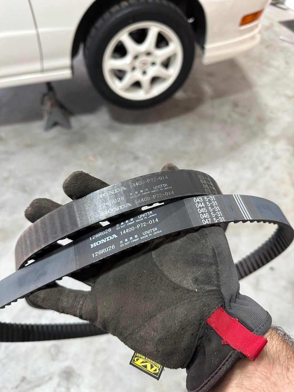

After swapping in the B18C, we performed routine maintenance tasks like changing the timing belt, tensioner, and water pump. Despite the low mileage, the timing belt had been in use for more than seven years, so I deemed it necessary to replace it along with the tensioner for added confidence at the track. Additionally, I purchased a new air conditioning vent to replace the old and worn-out one.
