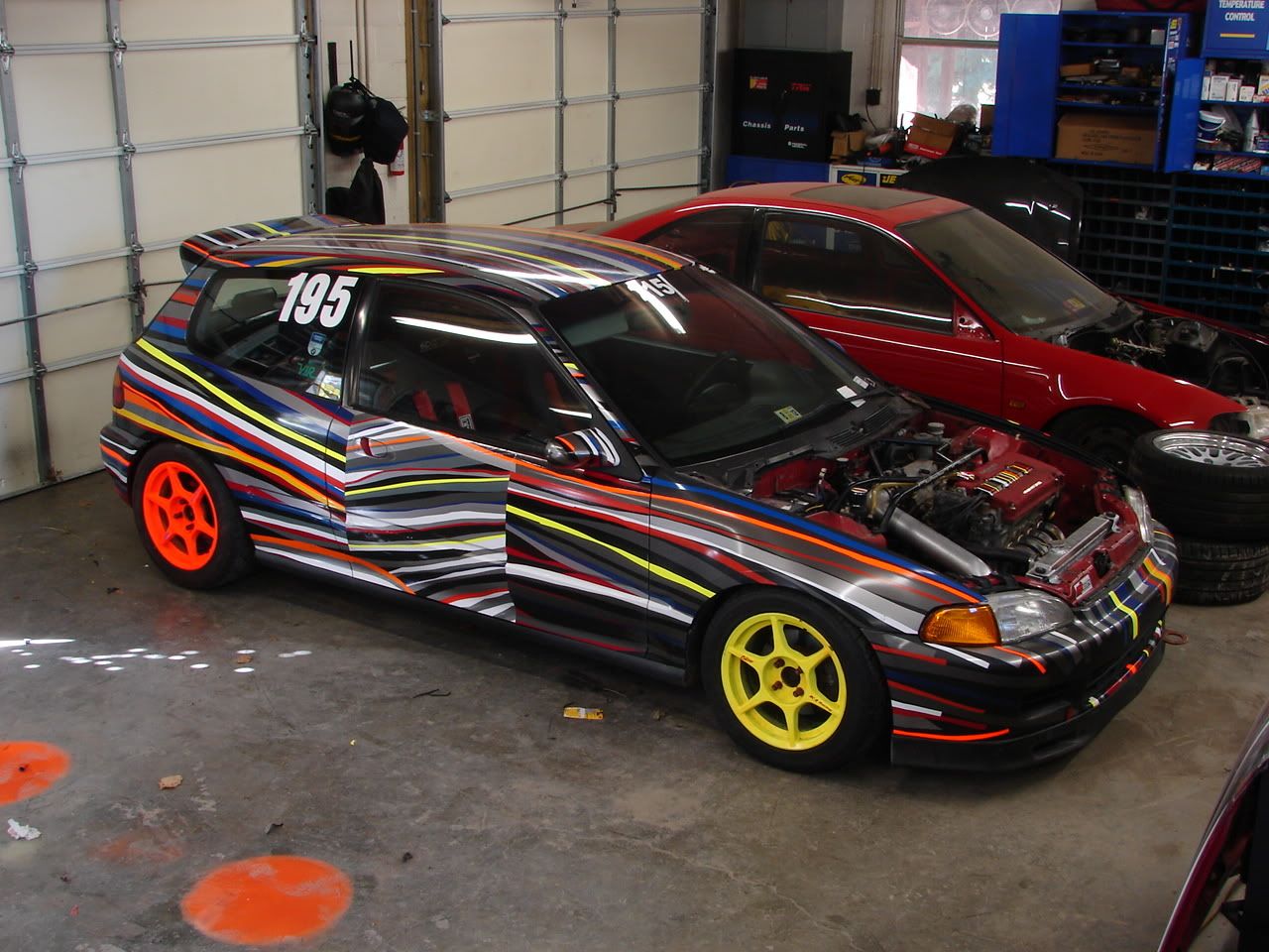

How the car will look for now(plus a hood,of course):

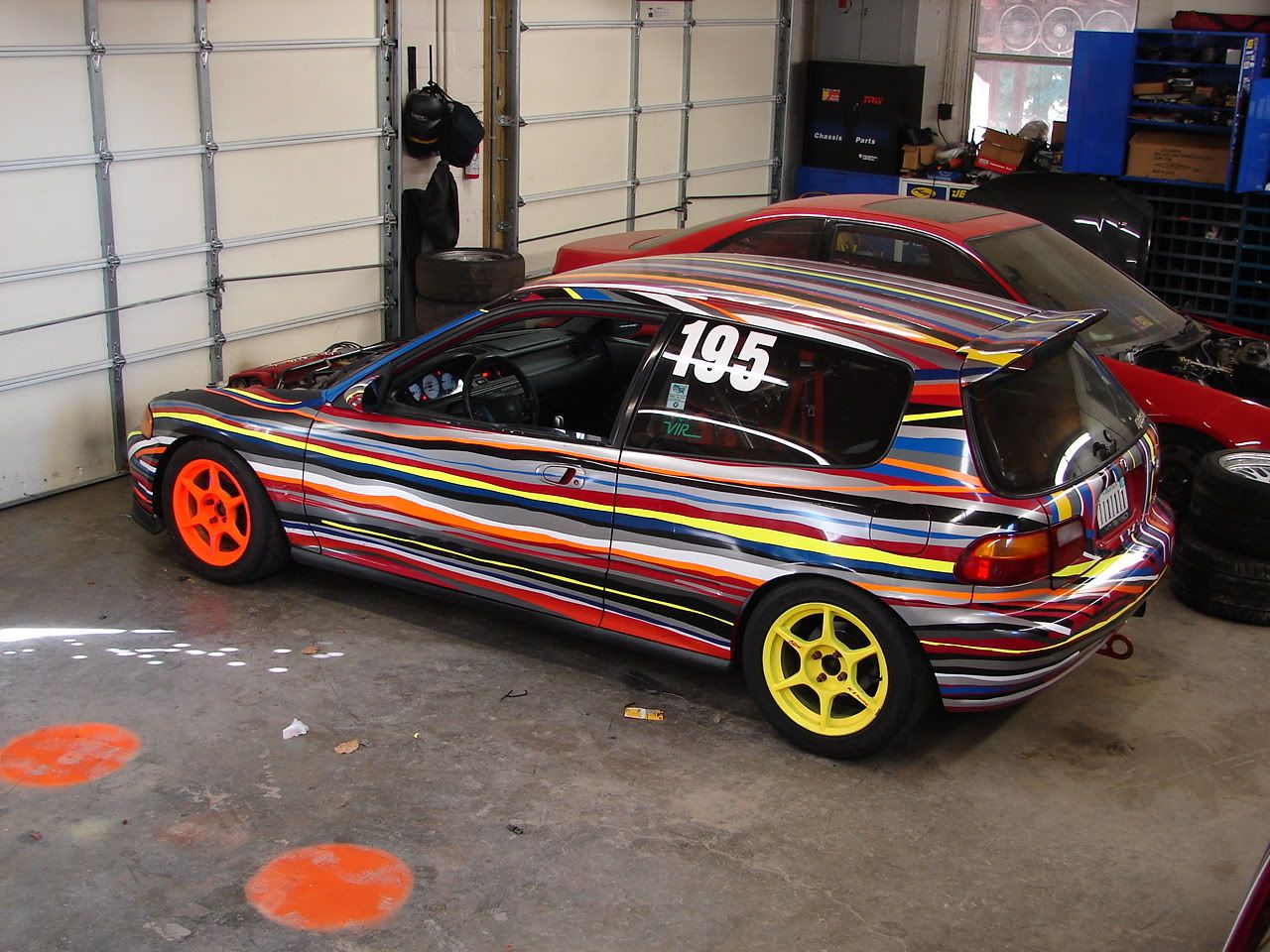

What do ya'll think?Gay or cool,not that gay is a bad thing,m'kay? Keep in mind it's a track car,not street car.
Started the graphics today.....So much more of a PITA than I figured.Spent about three hours on it today and almost finished half of it.

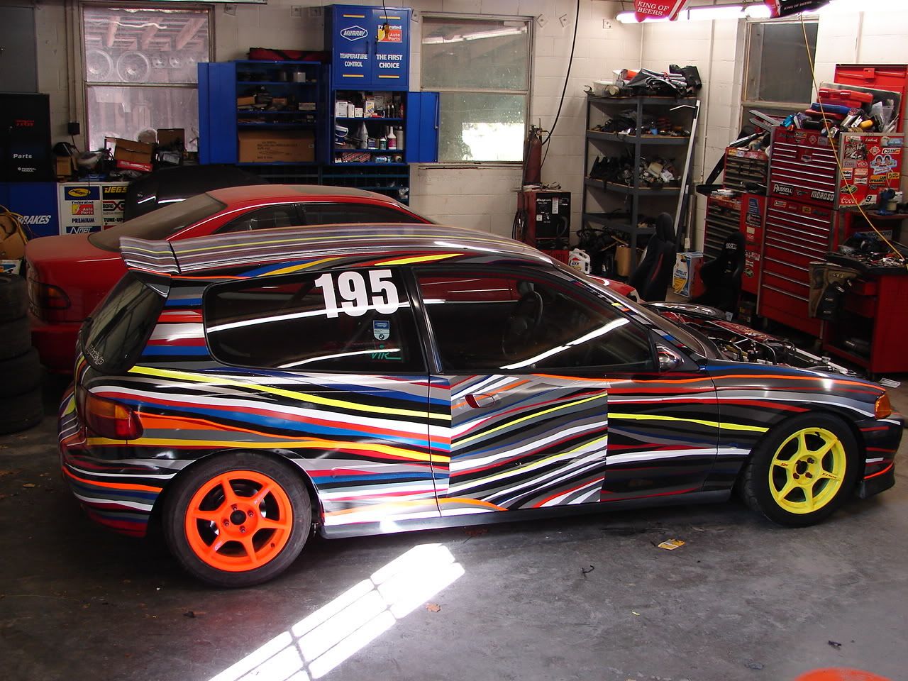

The point at which I quit today:
I need to add more color.Will be stopping by my friend's shop this week to pick up some yellow and more blue and red.

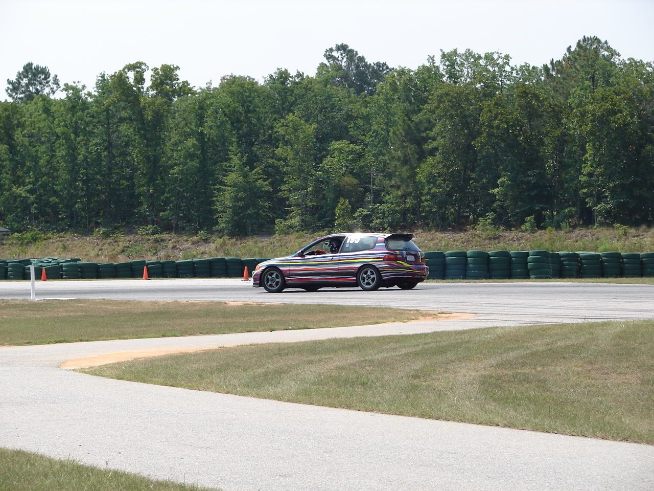

Took the car to VIR to shake it down.Everything went great,no issues at all.Sarge came down and took some kick-*** pics:
Thanks Sarge!BTW-he does shoots for very reasonable rates.Hit him up!

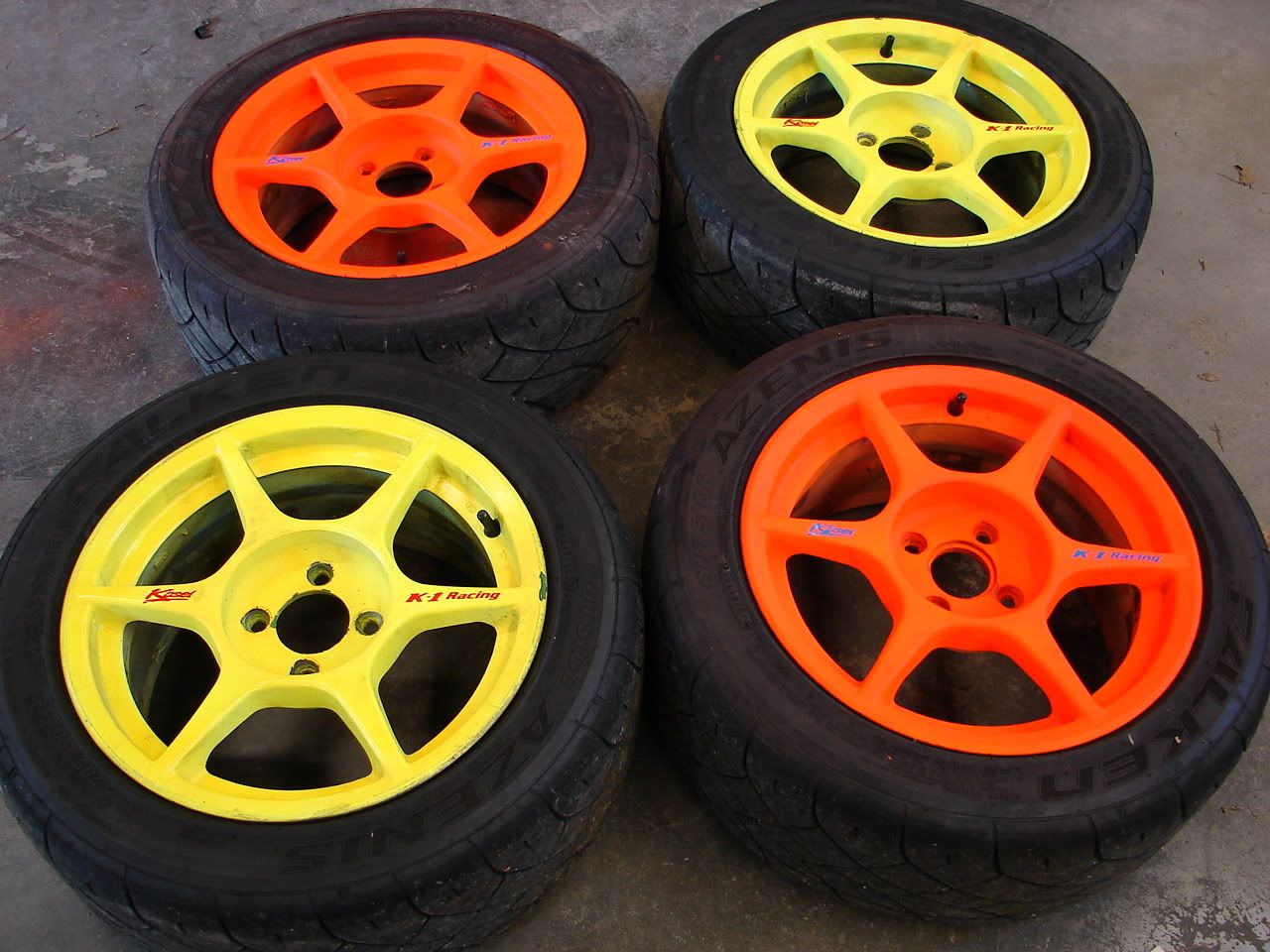

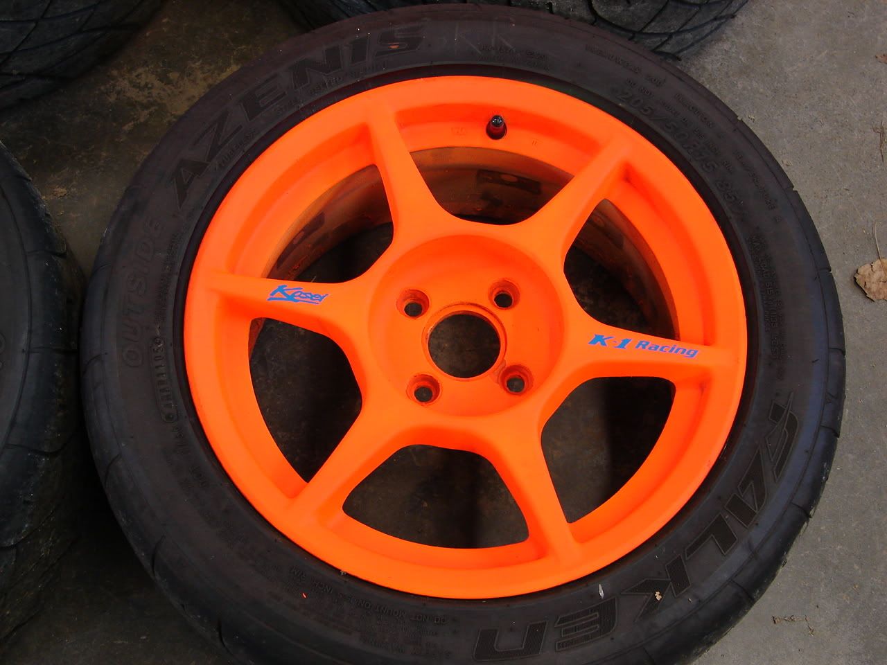

New wheels.
Yes,the paint job sucks.I started touching them up,and promptly said **** it.When/if I paint the car again I'll strip them and powdercoat them white.
Got some red Kosei stickers,and had to break out the ricer red aluminium lug nuts.Forgot to take the camera,so shitty cellphone pics.
UPDATE:

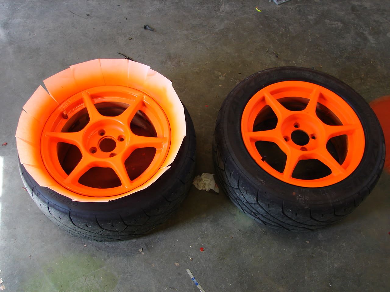

Car is now even more annoying.Two wheels painted safety orange.I have new Kosei stickers coming for these.Pics of them on the car next week.
On another note,today I started inspecting the car for next month's Trackdaze Grand event.Need front and rear pads,and both axles.Great.
New paint and stickers on wheels.

New wheels.
UPDATE:

This is about the best pic I can find at the moment:
It's a Neuspeed brace that I added the firewall bars to.You just tuck it up under the lip on the firewall,then over the UCA studs like a normal Neuspeed bar.The two bolts on the firewall thread into existing weldnuts,so no problem there.The biggest issue is I can't take the intake off without removing it(which has nothing to do with the bars I added).
