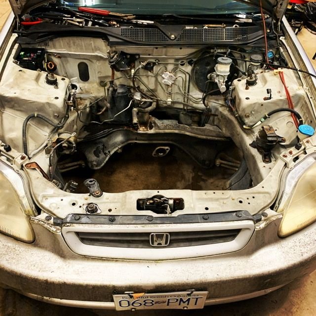

Made it home tonight, 35 minute drive at the tail end of rush hour traffic with a poor brakes and a mildly blown head gasket. Another update and my buddy's take on it.

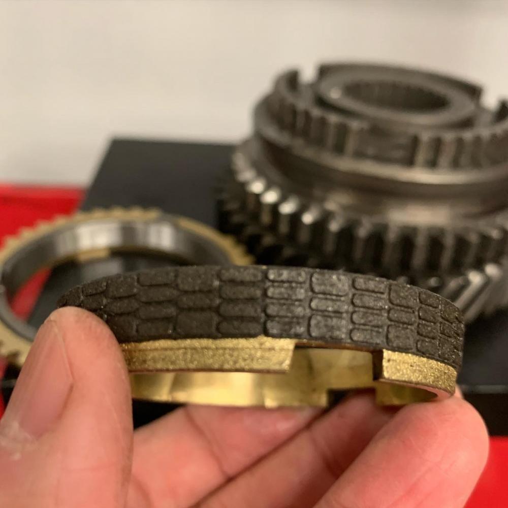

I swapped in a carbon 2nd gear synchro today, sucker bits hard, feels so tight. I kinda want to send it but reading some threads here and watching some vids I'm going to tear it down again. I'll swap the stock worn synchro in and see how it feels, if it's good then I'll take some 1500 grit to the synchro mating surface on the gear and reinstall the carbon one and see if it helps. I've done this so many times before but never spent so much time double checking things, lol.

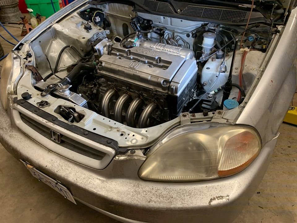

A little more progress. I Dug up a new OE distributor, feels odd putting new parts on this POS, Got the B series installed and bolted up a header and a catalytic converter!

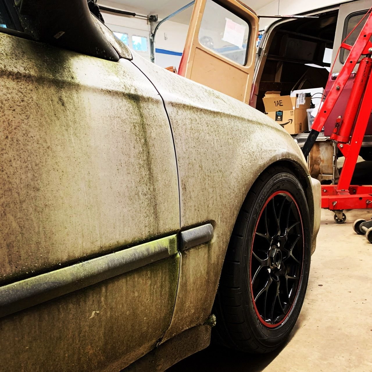

Test fitting NOS SSR type M

Default Re: My first EK, bringing this car back to life
That is going to be the most satisfying detail.

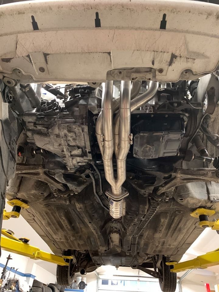

Damn I wish I had the skill and patience to weld. I spent maybe $150 cdn total this time around for the exhaust, bought some stuff, recycled some stuff.
The car is 100% together. New to me used wheels and recycled some year old 205-50-15's. After 10 minutes of trying to start I remembered I had drained the tank, lol. Now It's looking like I killed the pump, has bad pressure, I'm going to recycle an old walbro 255 and hoping it'll fire right up. I also threw an O2 sensor code, checked my O2 resistance and it's dead, I'll have to get a new O2 too, damn.

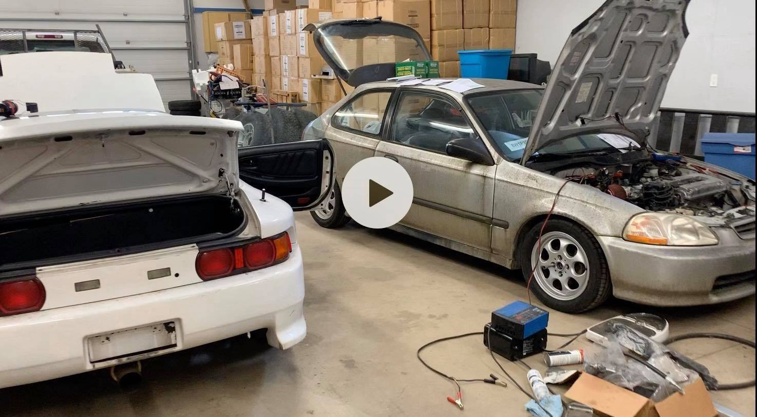

I figure I better get it running so it's easier to move in and out of the shop. Heres a vid of the first start.
My holley fuel pressure regulator was toast, I put on a new AEM FPR and for whatever reason it can't bring down fuel pressure to below 50psi, I swapped in the largest AEM return orifice and even checked the return line, its not plugged. I'm using a Walbro 255 pump. The other oddity is when applying vacuum or pressure to the regulator it does now change the psi, I'm going to take it apart and check to see if the vacuum/boost port if plugged. Anybody notice how the aem fpr port is really small, you can't fit a pin through it, maybe I'll drill it larger?? If not I'll just have to tune around it, as of now there is no way I can break in this fresh engine on a stock ecu. I was going to swap in a stock fuel pump for break in, I may as well just bite the bullet and tune it on the AEM EMS.

can you link IG here?
well it turns out the new AEM fuel pressure regulator vacuum/boost port was not drilled through, so I drilled it.
Set up the idle and fuel, the AFR is good enough to break in the engine on a jdm p30 ecu, also picked up a new ntk narrowband for it.
