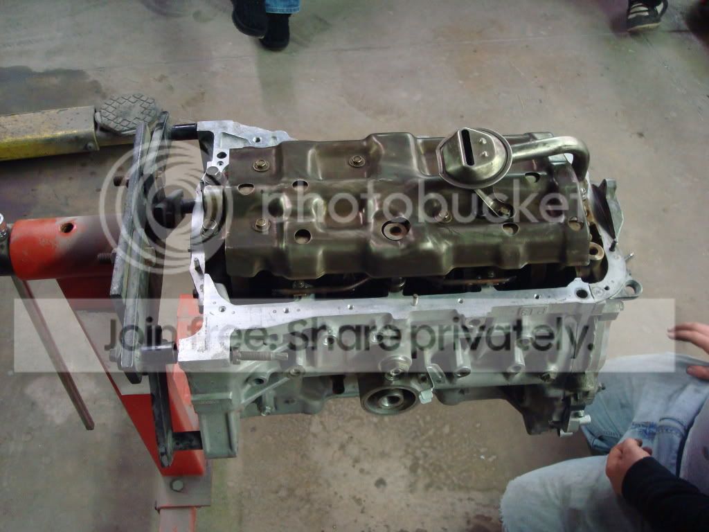

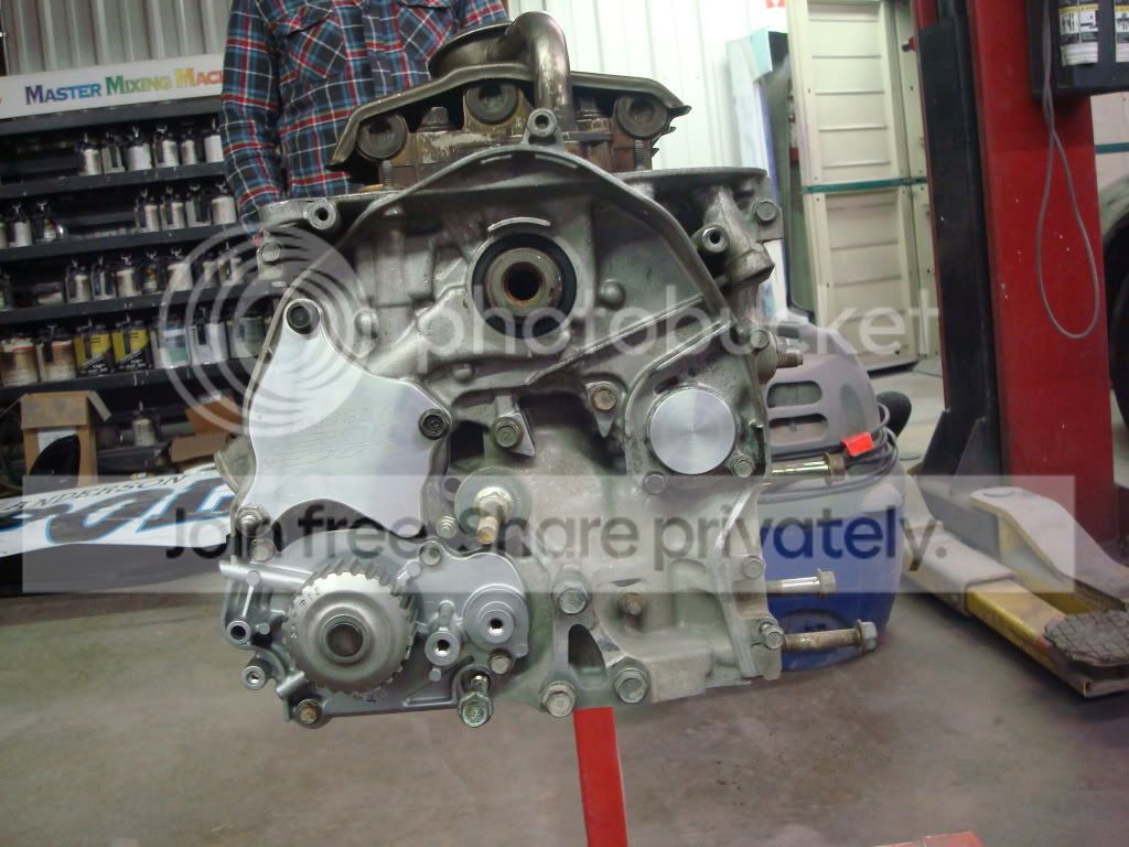

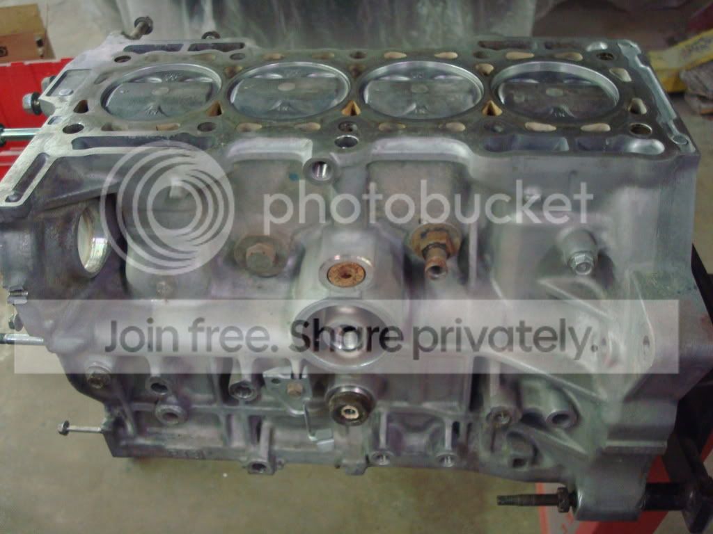

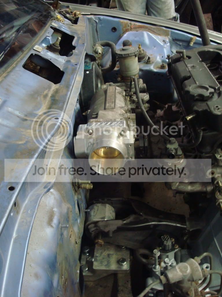

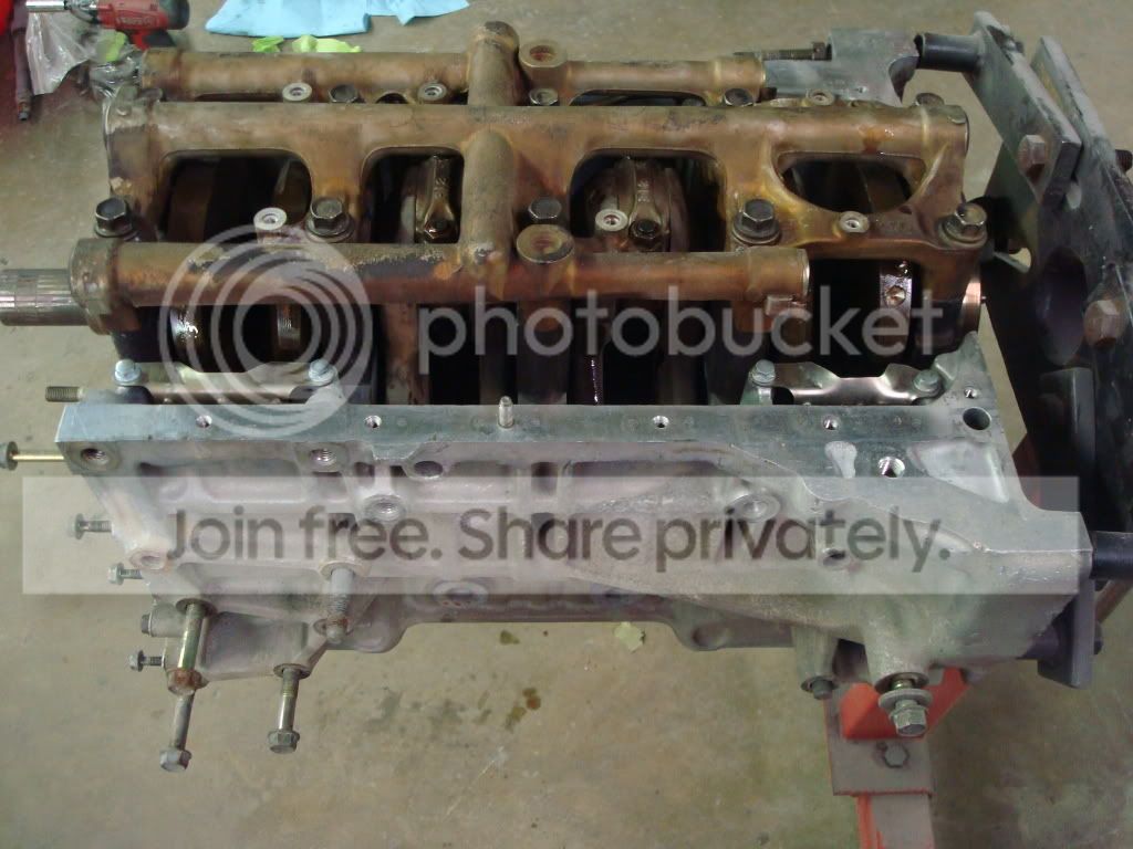

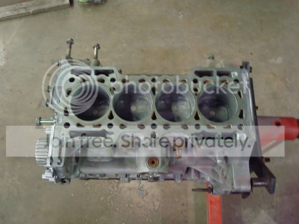

Picked up an H22 "with a little knock" it ended up being a big knock lol.
Some of the new parts. Manuel tensioner conversion, Kaizenspeed balance shaft eliminator, Type S pistons, and new gaskets, water pump, etc.
BDL Throttle Body

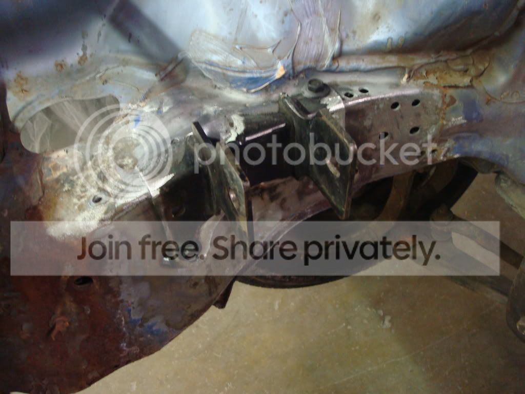

Rusty framerail to fix
Gonna replace the crossmember with one from Full Race
I'm planning on going pretty low so I thought I would try to get some more clearance for the control arms.

oh yea that bearing isnt to bad...lmao alil knock???just by lookin at that i can already tell what that sounded like looks alil worse than mine looked in my 23 and that **** sounded horrible like the car was about to completely fall apart

Originally Posted by MrM3
build looks awesome exept for the control arm clearance you need to make you towers higher, somethign like this:
Old Dec 2, 2009 | 05:26 AM
MrM3's Avatar
Joined: Mar 2009
Posts: 221
From: Indiana
Default Re: MrM3's Wagovan Mega Build
Ok thanks I'll check that out and see if what I'm doing will give me enough clearance or not. Luckily I haven't made it further than what's in the pic.
Old Dec 2, 2009 | 10:26 AM
misha's Avatar
Posts: 6,166
From: San Francisco, CA
word, yea just get a UCA up there nice and loose and move it up and down, you will know immediatley what you have to extend and what not

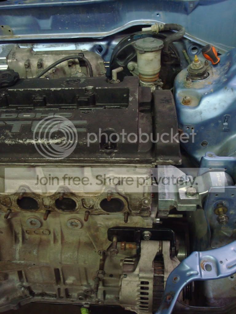

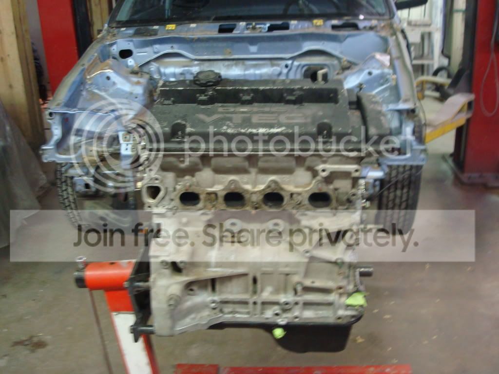

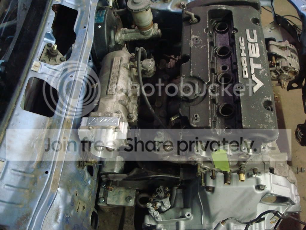

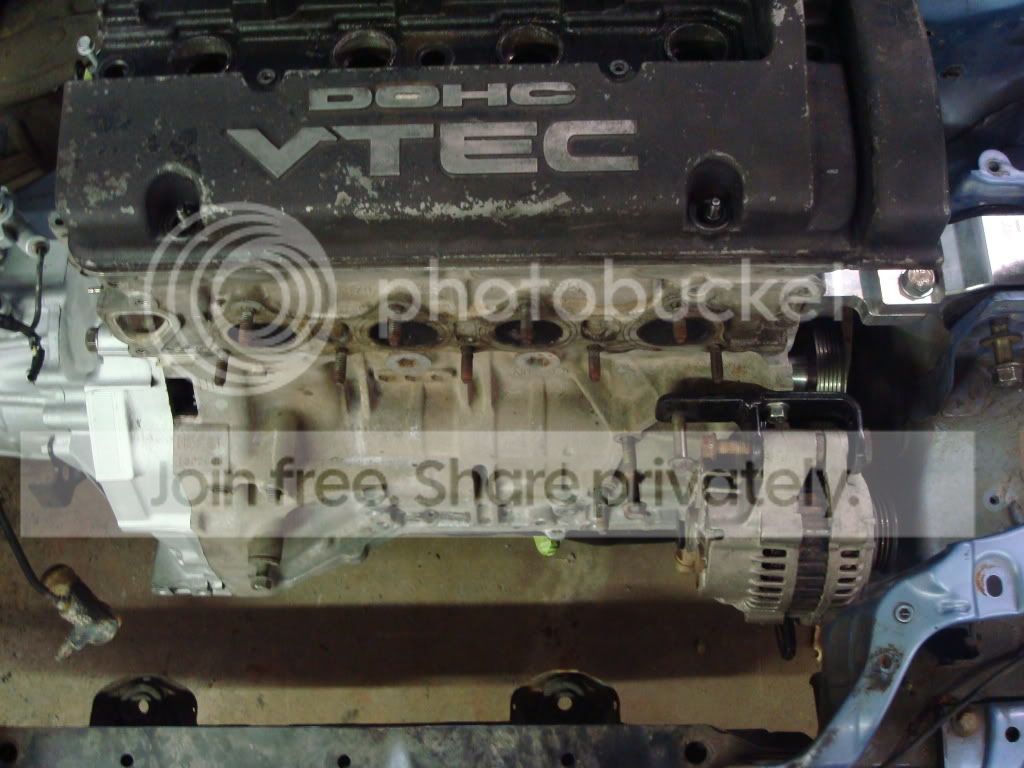

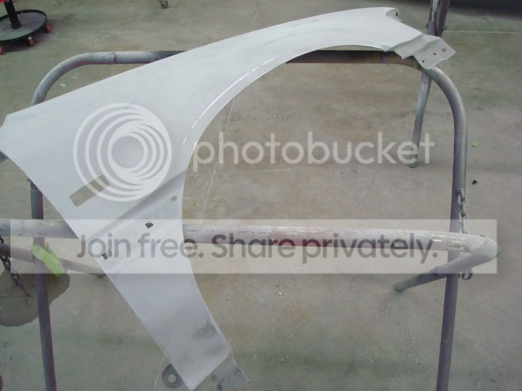

Finally made some progress on the car. It's been slow going with my birthday, shopping for Christmas, and then Christmas itself. Anyway got the internals on the engine done and trial fit in the car. I had to modify the passenger frame rail and the firewall for the intake to fit. Still need to modify the driver's headlight bucket for the alternator. The timing belt area on the valvecover just barely clears the hood so I'll have to wait to see if the carbon hood clears after I get it. It's scheduled to be delivered today, so I'm pretty excited for it. The next thing on the list to do is pull the engine back out and start repairing all the areas I modified. After that I'll be starting to clean up the bay so I can start the brake line tuck.

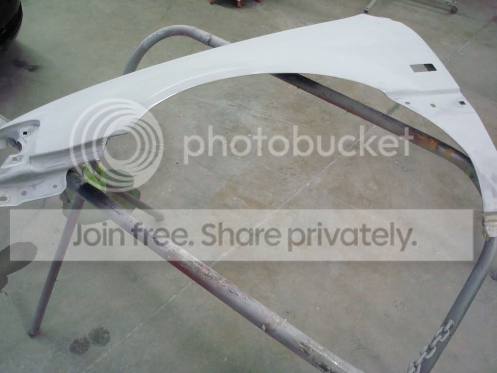

Also got the bodywork done on the fenders and bought two rust free doors and and a hatch so I'll be starting bodywork on them sometime soon.

is this the first h22 into a wagovan? Thats definantly a tight fit. Good luck and im excited to see what this thing is gonna turn into.
