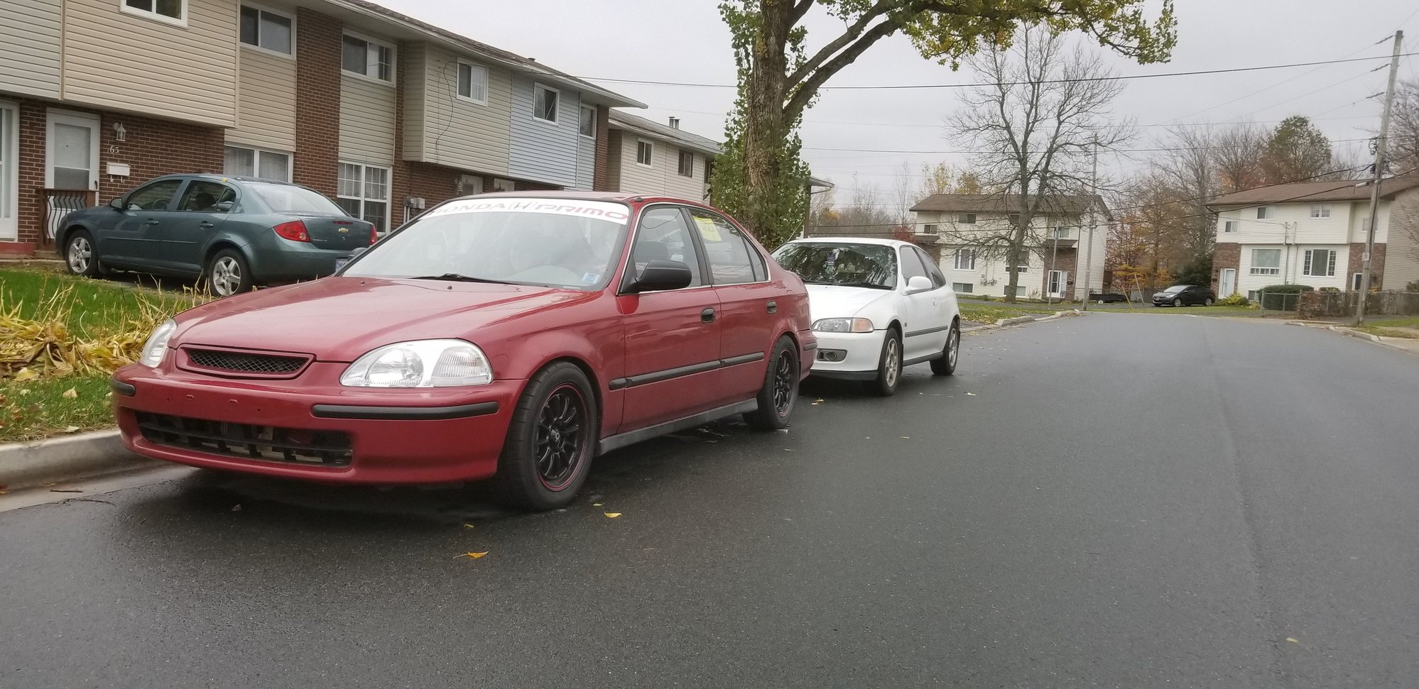

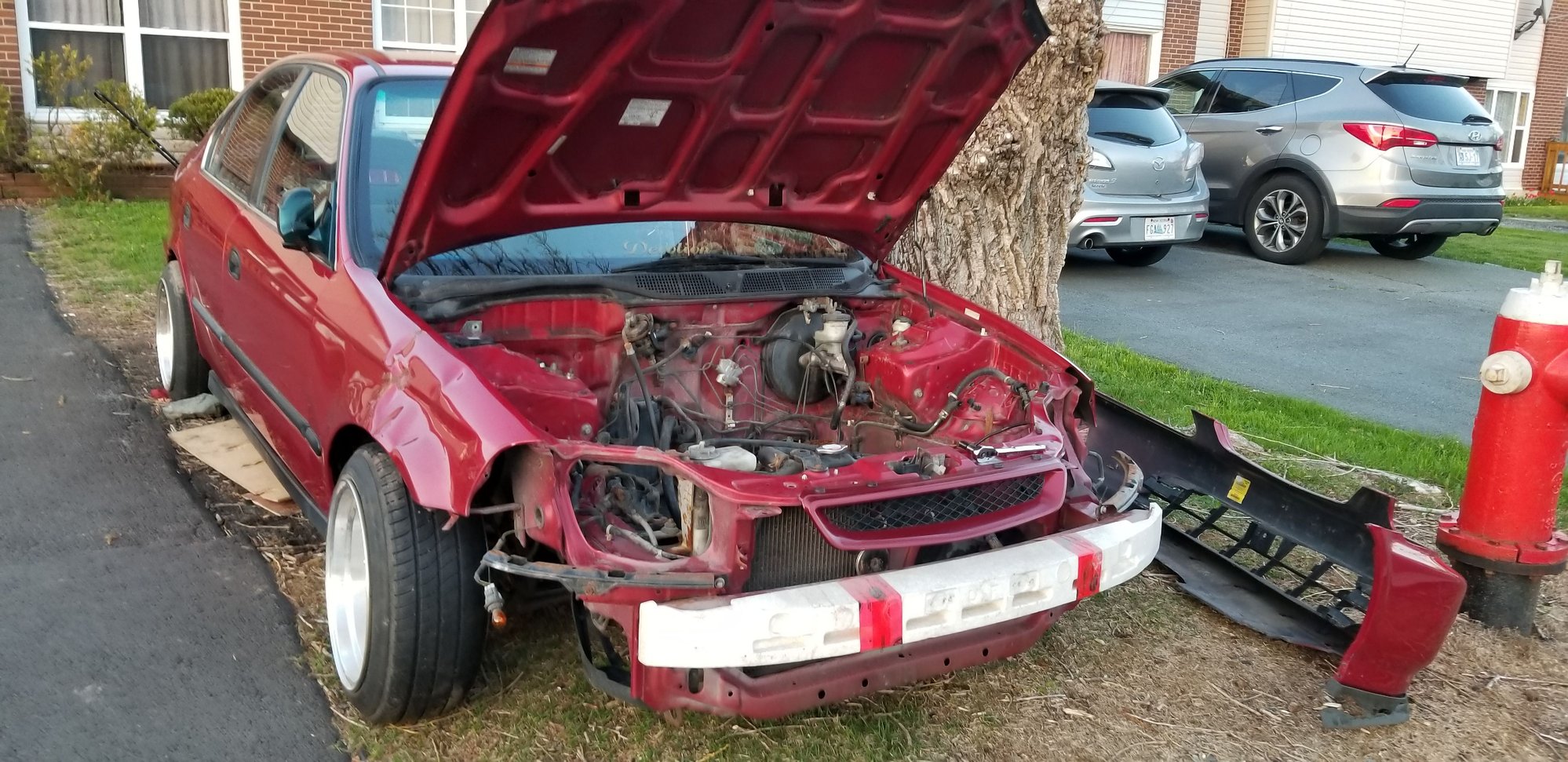

Hey guys, this is my first build, I'll start from when I got it and where I am now.
It's an Inza Red 1998 Civic LX sedan from Colorado. I live in Canada so Inza Red wasn't available here. Bought it stock except for an ugly Mugen rep lip and terrible coil sleeves. Here we go.
When I first bought it after the lip ripped off.
Next I installed my clear headlights and tailights.
Then I installed my SIR lip, Type R grille and mudguards.
Got a Skunk 2 Type R style ****.
Touched up the clear coat that was peeling on my rear bumper.
Painted my wheels because they needed some love. Also bought some Yonaka coilovers and installed those aswell, much better then those disgusting sleeves.
Deleted collars and adjusted the preload on the front coilovers to get it the same height as the rear. Also painted the lip around the grille.

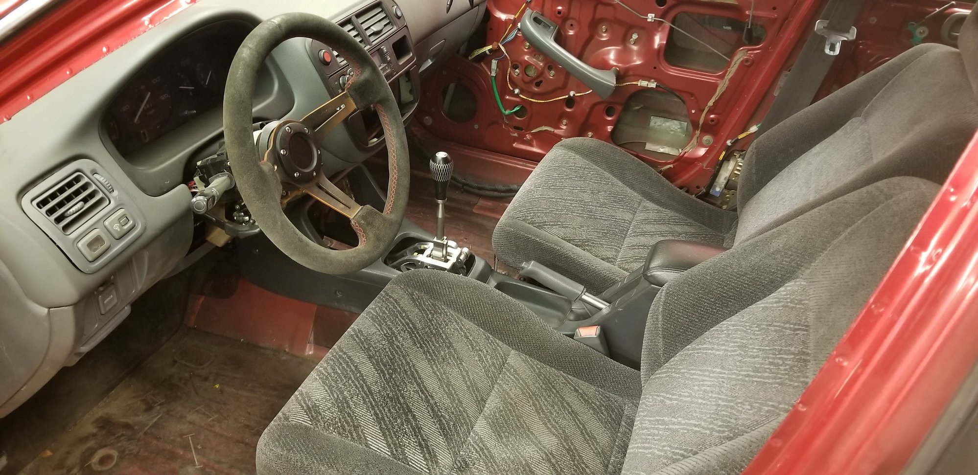

Got an NRG wheel, short hub, CRV seats and gutted my interior. Gutted it because it's getting painted over winter and the interior is getting redone, I also love driving gutted cars.

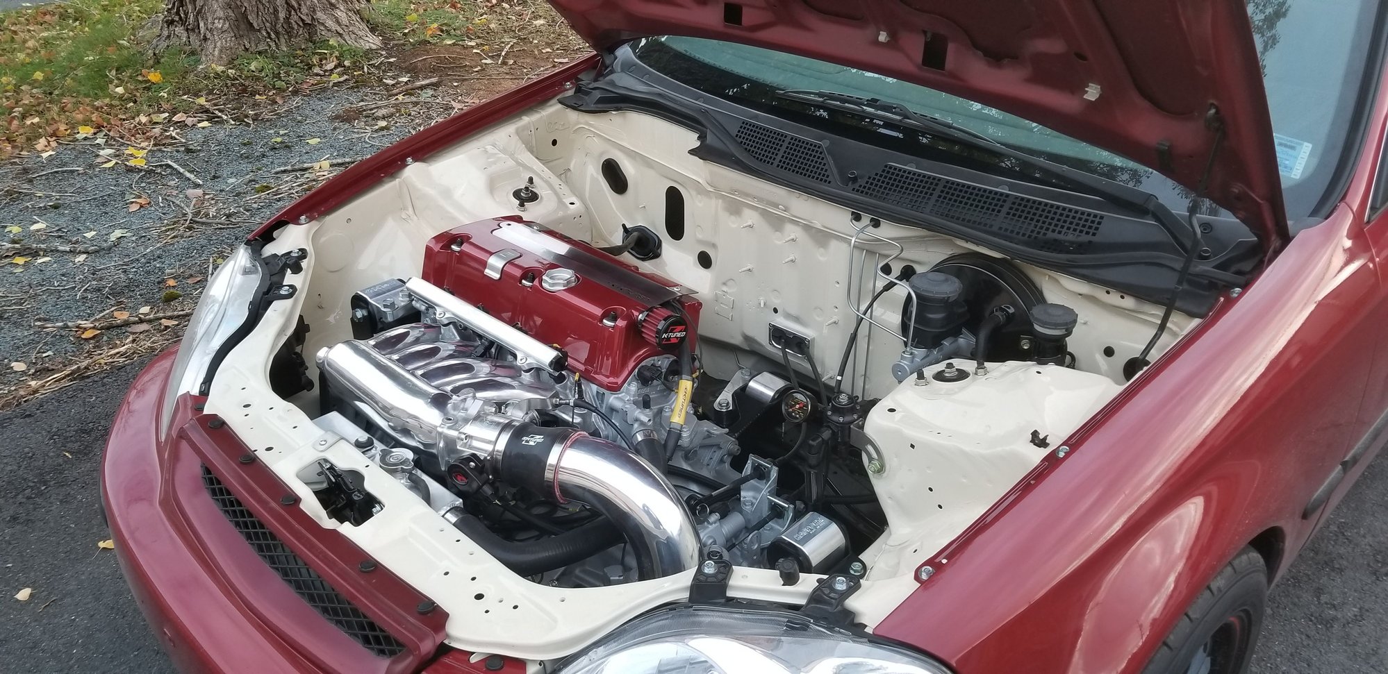

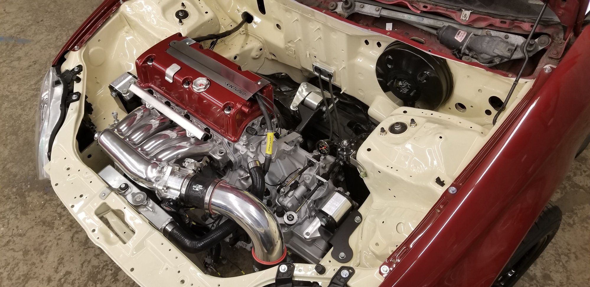

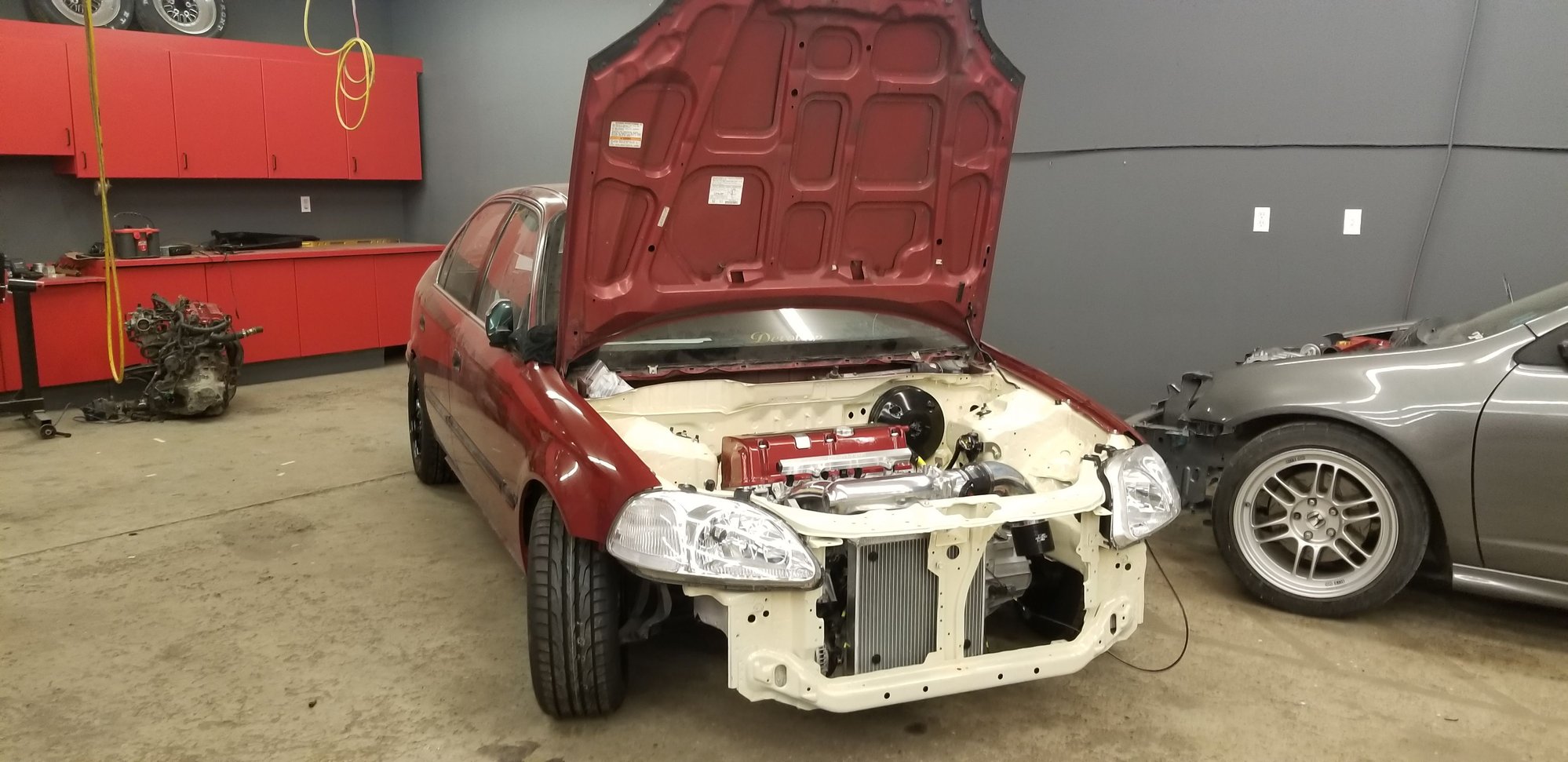

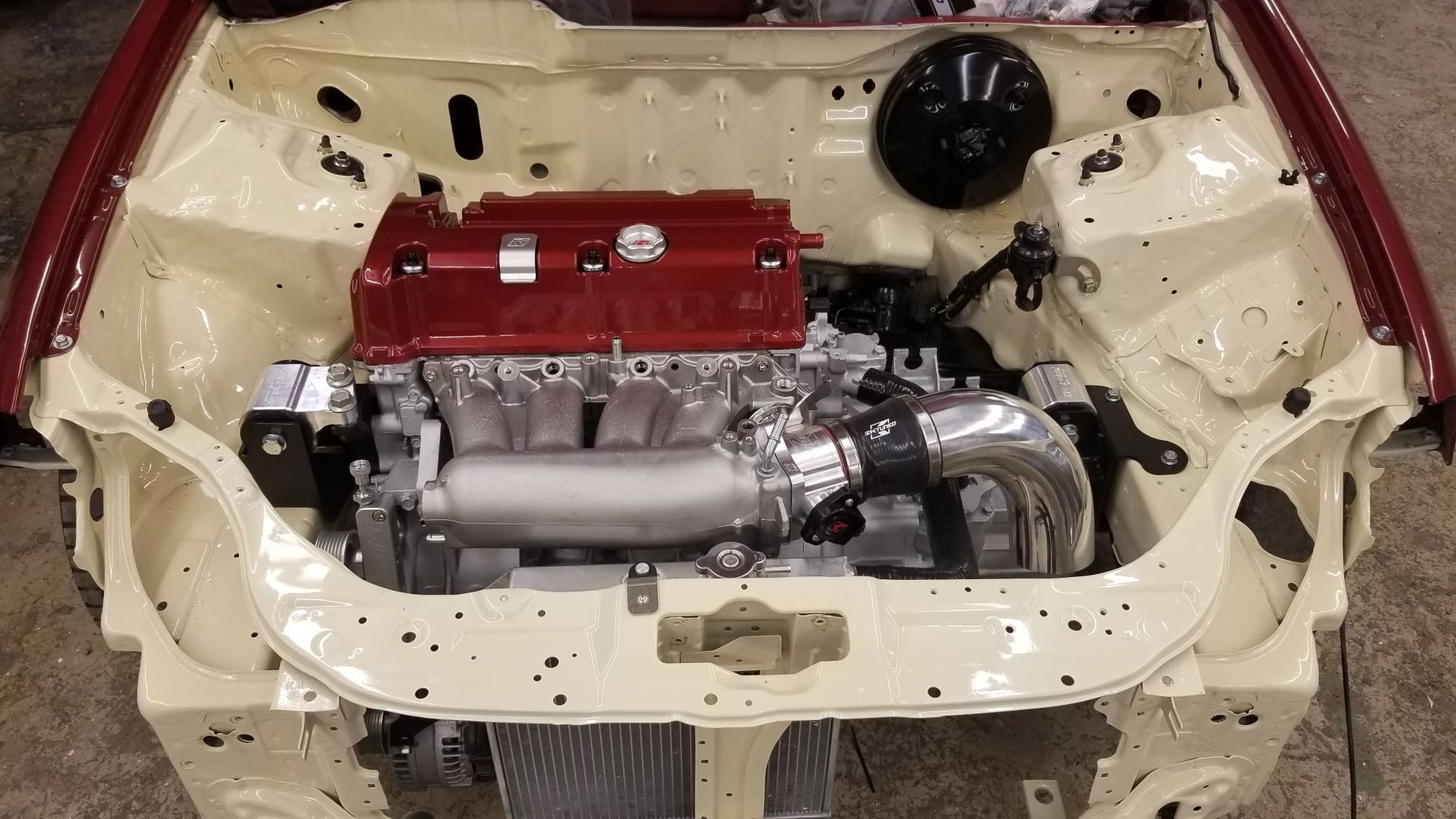

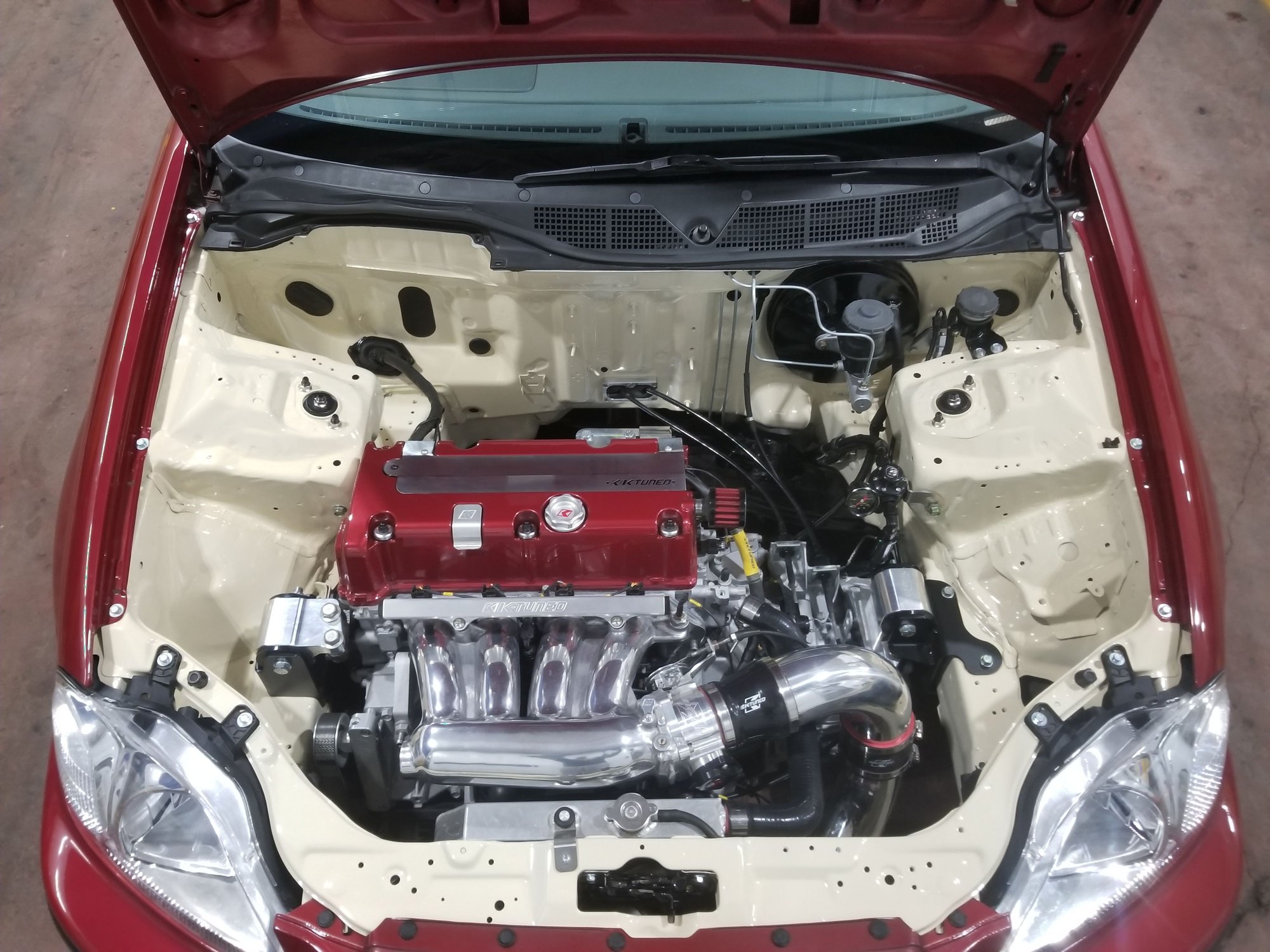

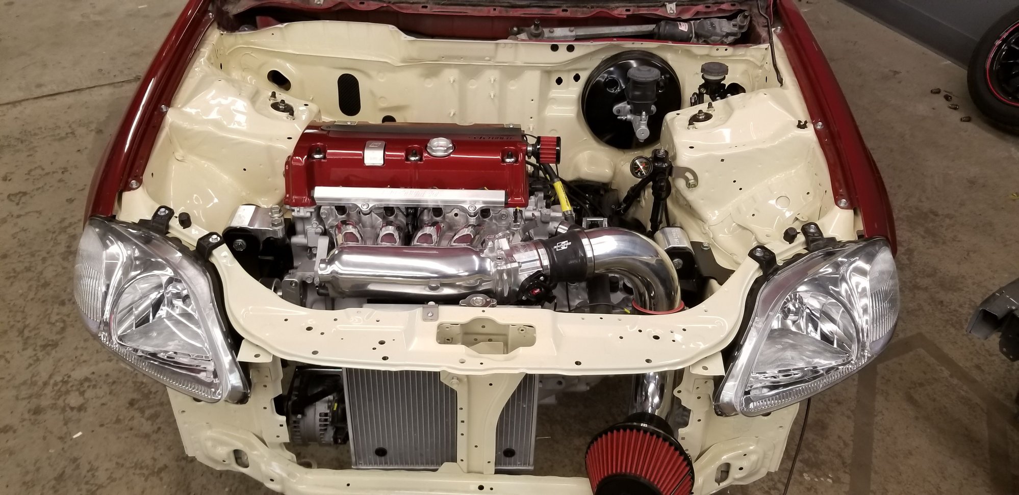

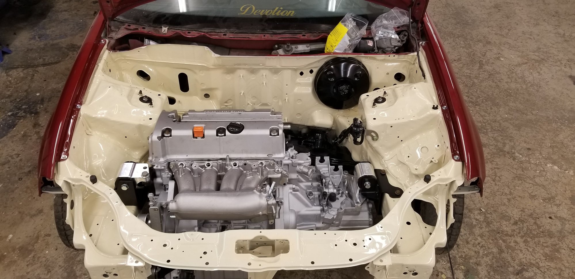

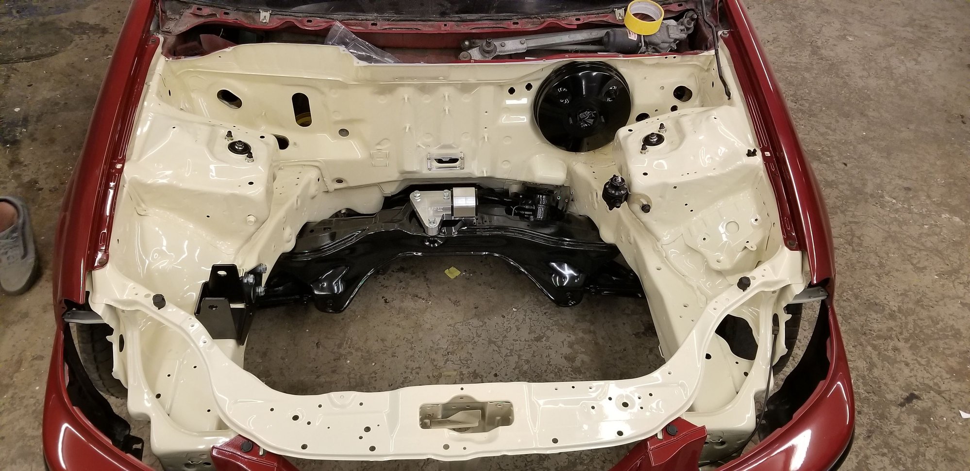

Well it's been a few years but the car is much better then it was before. I ended up pulling the D16 out and getting rid of it. Then the car sat for awhile, sent it to a local Honda shop and had it k swapped.
The sedan now has a K20Z3 engine/trans making 221whp and 165trq.

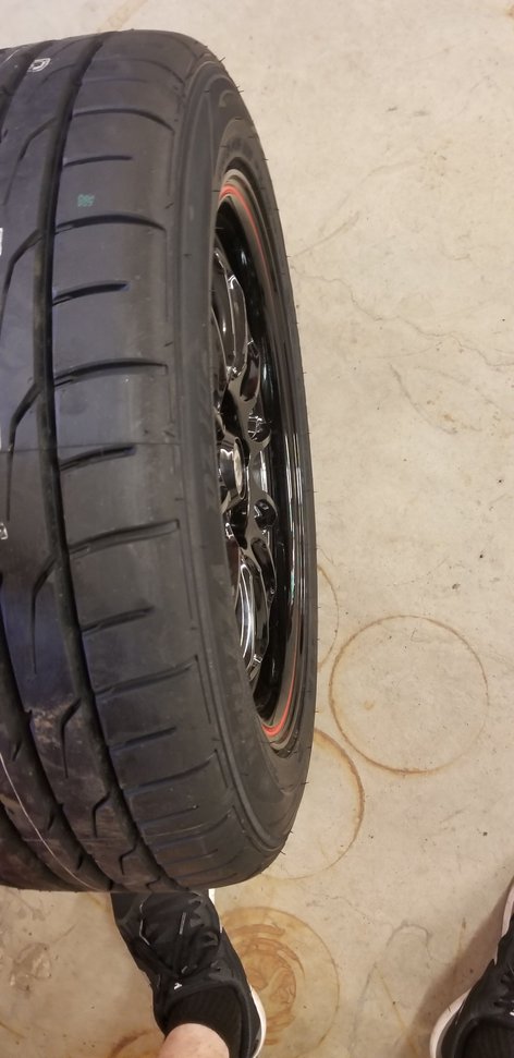

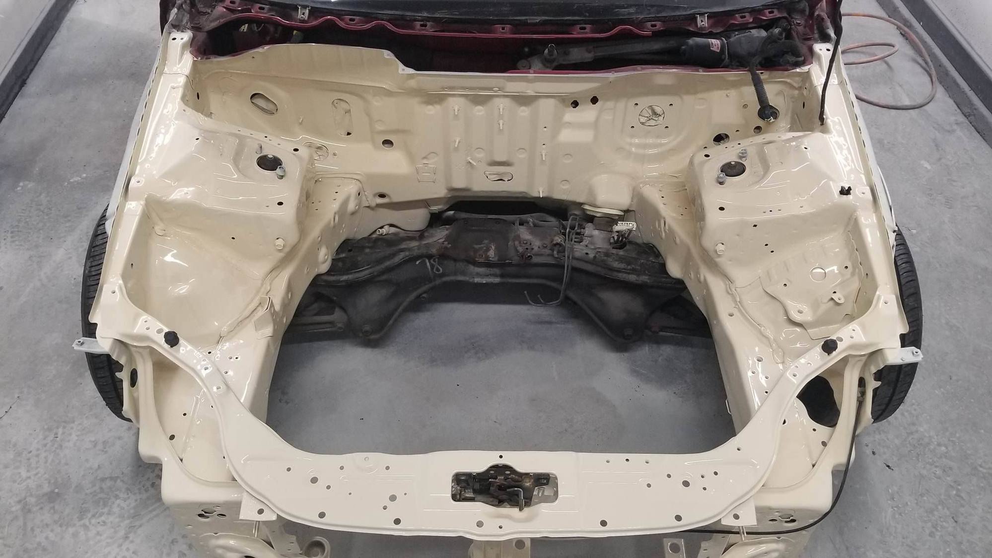

It has a 3.5 intake with a velocity stack, ktuned swap header, full 3 inch header back exhaust with a 3 inch ktuned muffler, hasport ekk1 mounts, new base rsx axles, ktuned fuel rail, fpr, grams 255lph fuel pump, ktuned tuck harness, brake line tuck, fuel line tuck, power steering, ac, washer fluid hoses is all deleted, bay got repainted, all new brakes, new konig wheels and 205/50 dunlop tires, new windshield, OEM SIR bumpers, fresh paint on bumpers and brand new fenders.
Hope you guys like, here's some pics.

Originally Posted by Josip.
That is some nice progress!
You're using EK subframe, or you swaped EG?
Yup EKK1 mounts, I do plan on swapping to the EKK2's and a type s oil pump and pan for better clearance though.

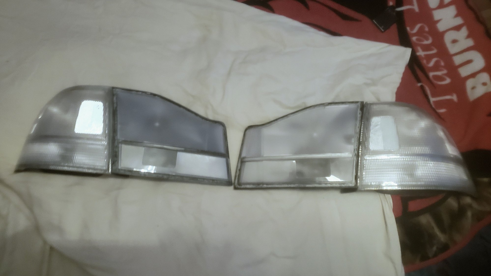

Not much updates, been enjoying the car. Got a bucket seat and a new wheel, a front lip and swapping to a Domani/EL trunk with clear lenses.
