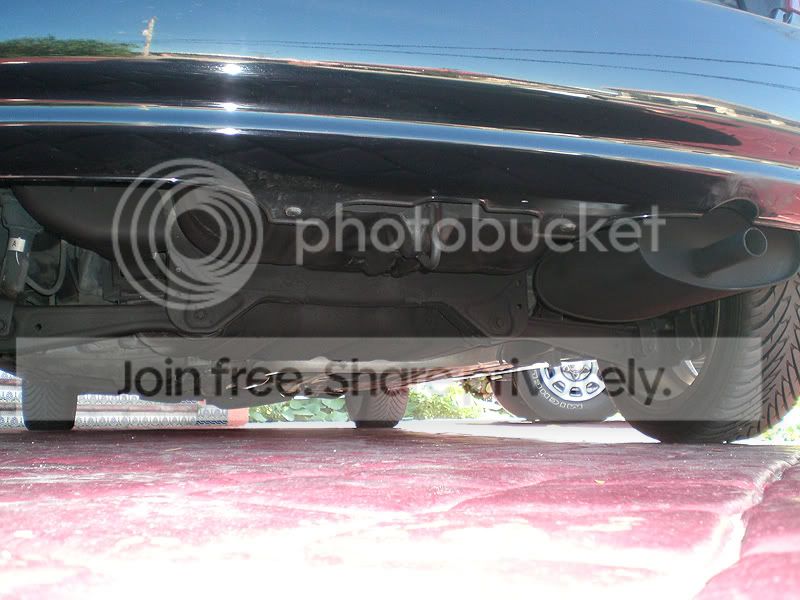

Well on thursday, I undercoated the rear end of the car for a cleaner look. It also eliminate some sound going inside the car.I also got my fog lights today from the mail..and I also installed them..but took a while, so all I got was a night picture..well, enjoy.

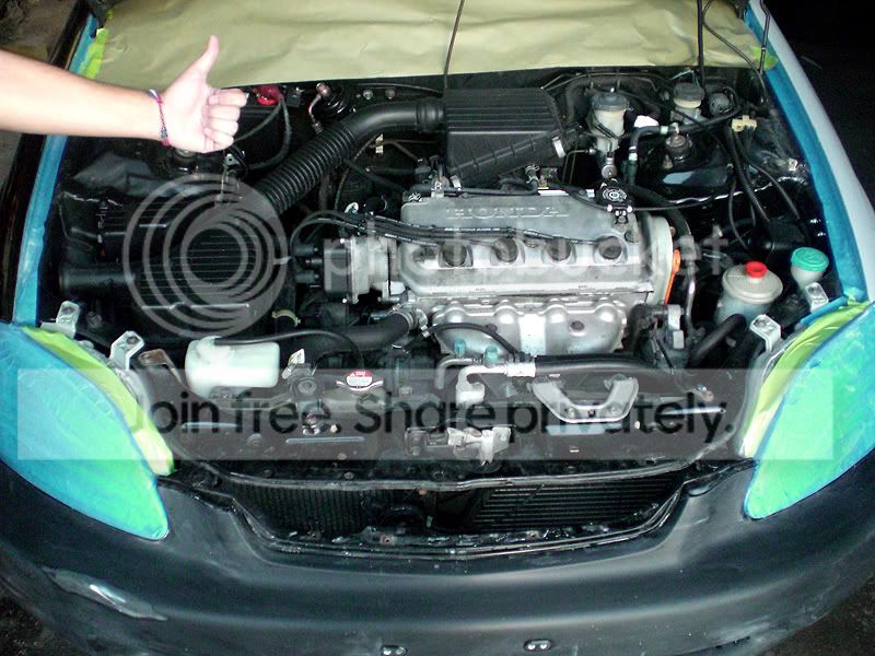

Here is some progress before doing the paint job.For now I fixed up all the small dents with bondo,and the smaller scratches with putty, than I sanded the rest with 600 wet.And now the body is SUPER SMOOTH..I just finished laying down the black primer, so I'll post more pics of the job 2morrow.
If you want the body work to come out great, Sometimes you just have to do the work yourself.
And thumbs up for an AWESOME engine...lol

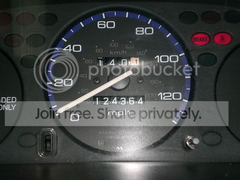

I finally got my Si cluster!!

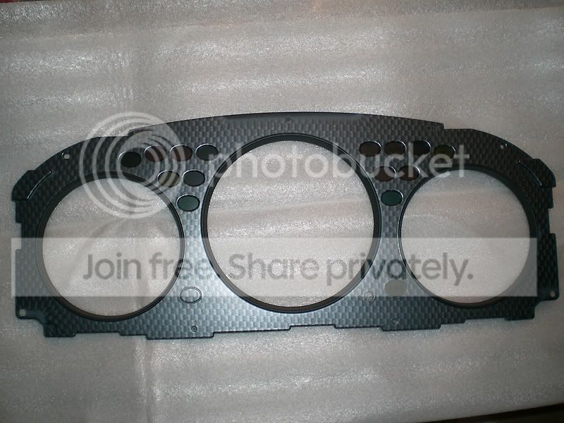

I finished installing the ctr carbon bezel over the si cluster..I had to rig it up alittle so that it would fit properly..But it fit great in the end,and it looked awesome.

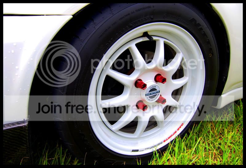

Here are the Gabs I bought off a friends they are 15x6.5 with some terrible rubber..lol.
7/4/08
Here's the picture of the new beefy tires.The previous were in pretty bad shape, plus they were 3 different brands of tires..lol.The old tire set-up was 195/60/15 in the front (very ugly, and too much tire) and the rear was 195/50/15 (way to small, and skinny..and a terrible brand) Now the new set-up is Nitto Neo Gen tires 205/50/15 (they are alittle bit wider, it hugs the lip to protect it from curb rash, and it just looks flat out mean.)

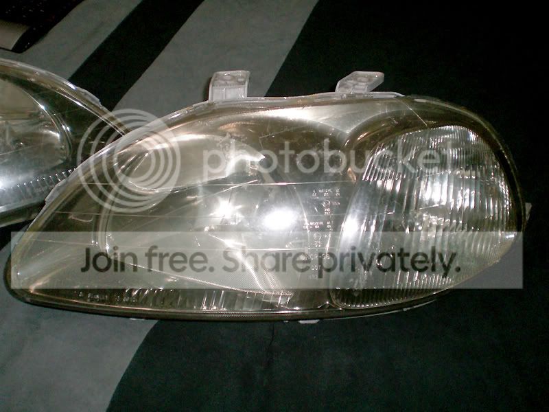

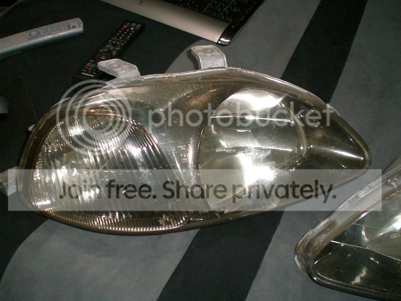

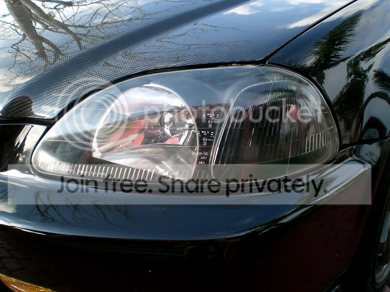

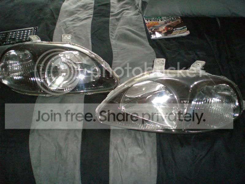

So I just happened to have come across these type R headlights..they looked pretty sh!tty when I got them.
BEFORE:
But since I'm a sick dude, I wet sanded them with 1000,1500 than 2000.After that, I gave it a sick buff to polish it up.And it came out like this.
AFTER:
