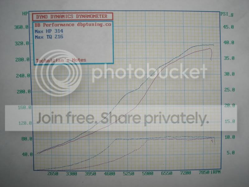

Before you decide on a topmount, you should look at your other options. I had a topmount on my stock block GSR and it added a good amount of lag to my setup. Personally i would stick to something with a shorter runner design. Here's my dyno graph comparison between my topmount and SLS shorty....the setup including the turbo is the same for both dyno runs. The only change was the manifold.
The Red line is the topmount; the blue is the SLS Shorty
