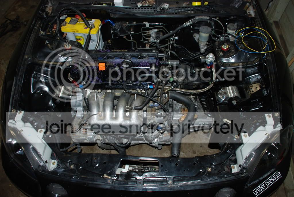

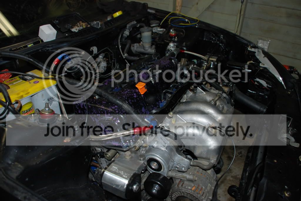

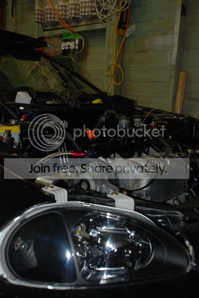

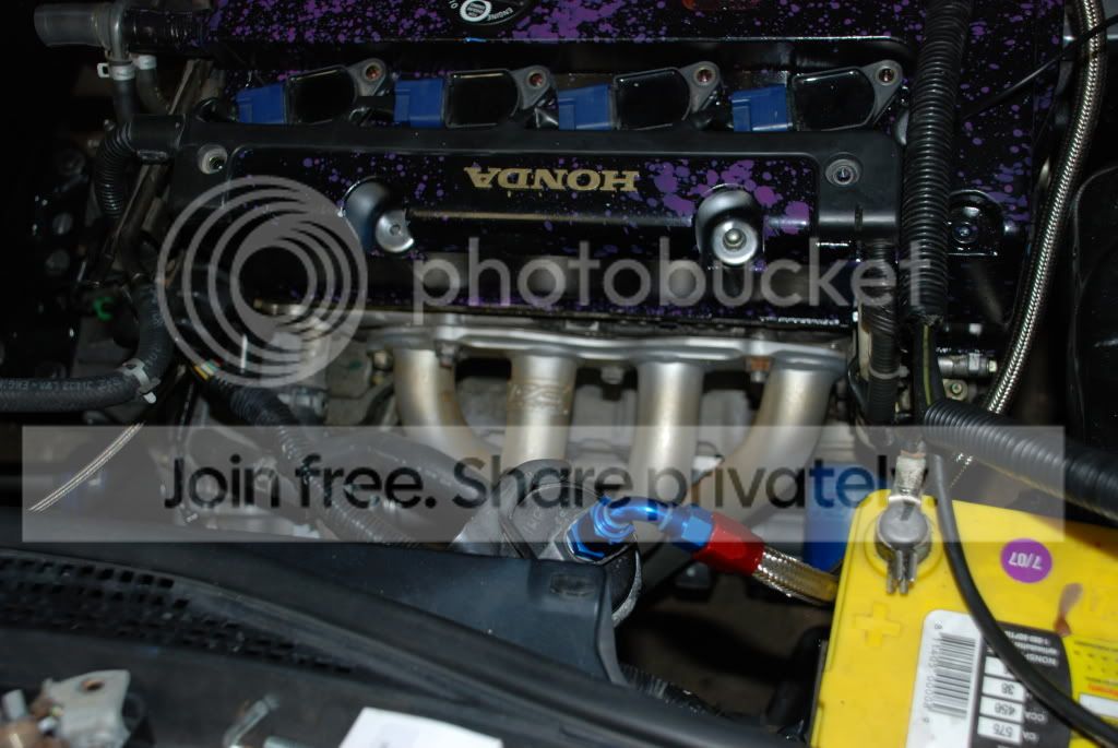

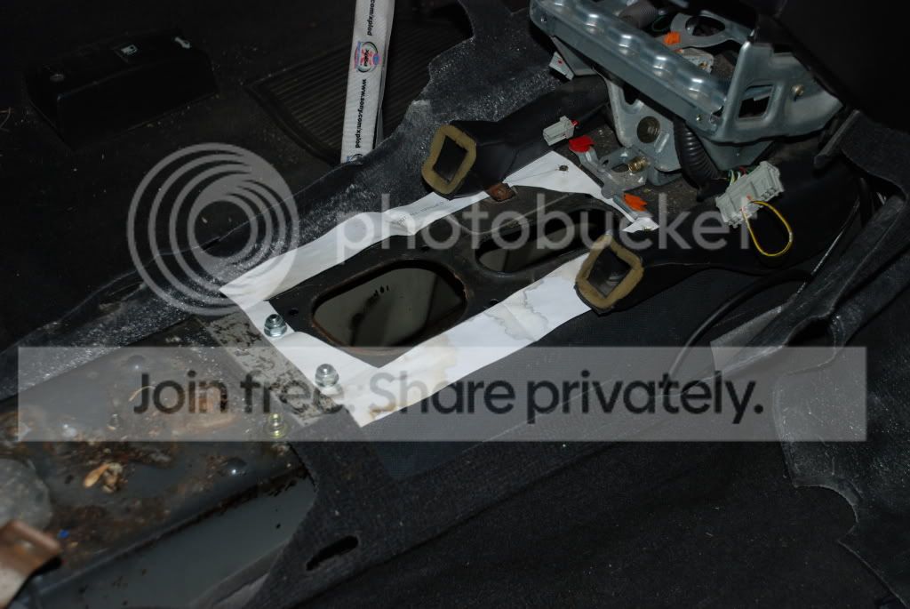

since the car is in my garage ill include the bay pics to help out..
side shot..
dc k header
still working on the box cut out since we finally got the right cut out sheet..
that K-pro boooooy
almost forgot your one piece head lamps
there ya go pal

Engine bay PIXXX!!!!!!

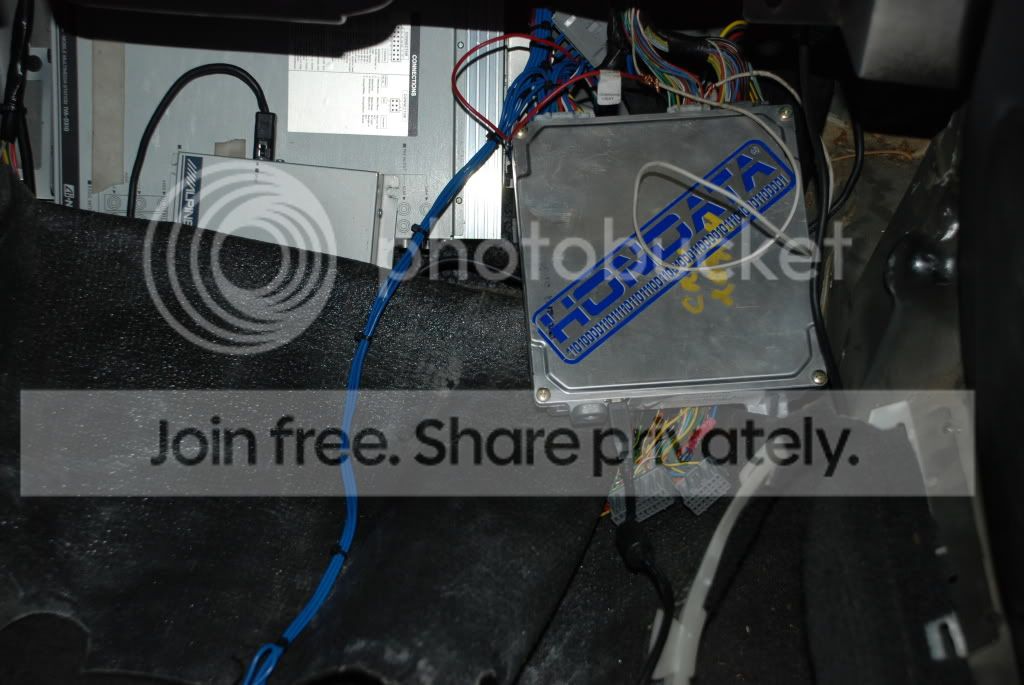

Default Re: (RegaDeliBoi69)
Old Nov 5, 2008 | 11:09 PM
RegaDeliBoi69's Avatar
Joined: Jul 2008
Posts: 123
From: NAPtown Indy
By the way the idler pulley in the pictures now are wrong the pix i will be putting up tmrw will have the correct pulley on it... NOTE: if you get a K20A2 out of an RSX Type-S the pulley is wrong and must be converted to an EP3 pulley... we learned this the hard way.. haha
