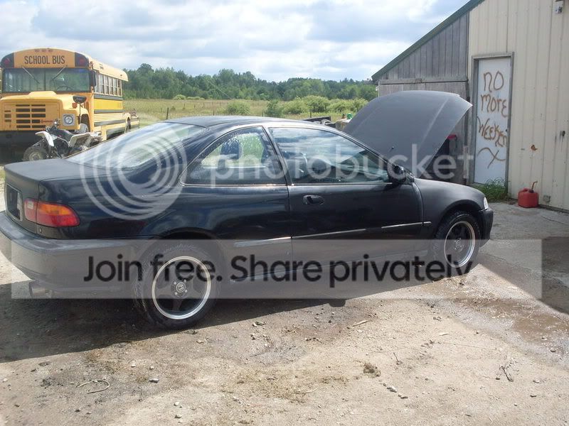

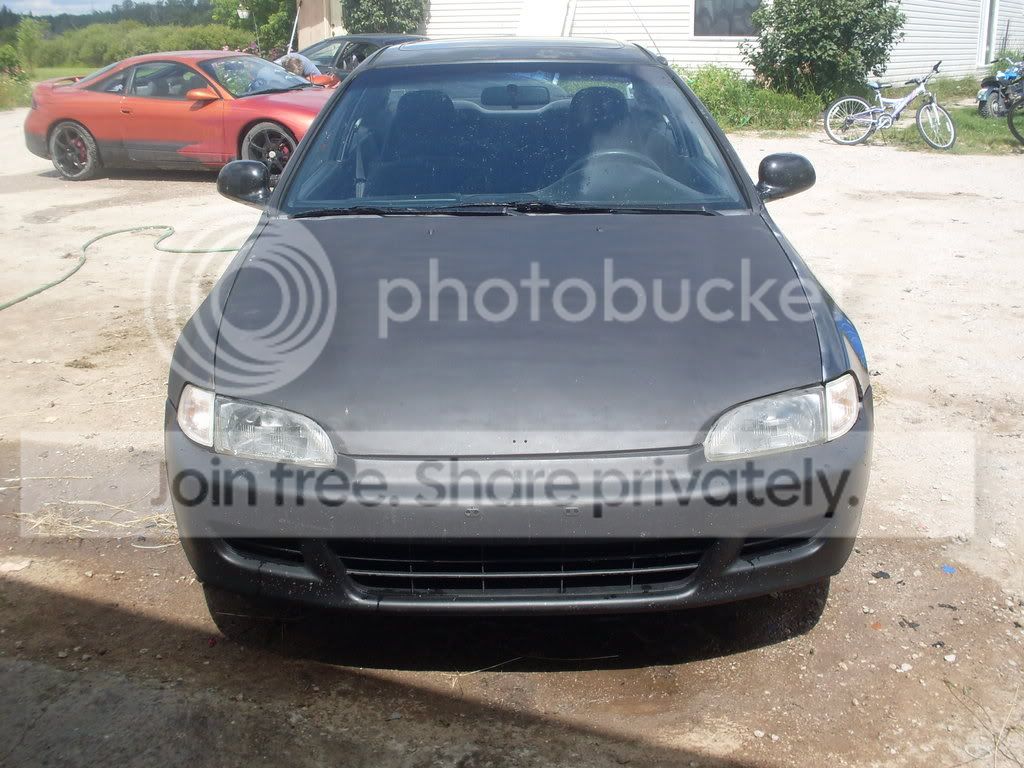

So i traded it for a 94 civic coupe and $300:

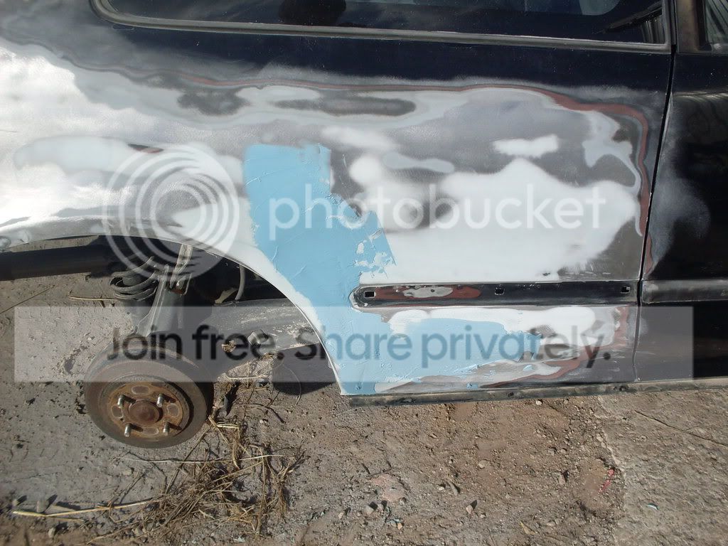

I knew when i got the car that the door had some bondo cause it had cracked but i didnt know that the entire quarter panel had been smashed. There was like 1/8" bondo that wasnt needed. I grinded it all out and started to put my own bondo in.
Its all done now. The door had a lot of bondo in it also. I just grinded the crack out and filled it back in. Im gonna look for a new door eventually.

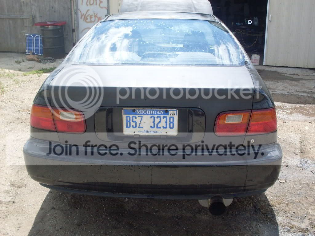

Someone had put a wing on the back and drilled holes in the trunk. They just filled them with bondo real quick and the bondo just cracked out. We filed out the bondo and welded the holes shut. It will need very little bondo to fill it in.
