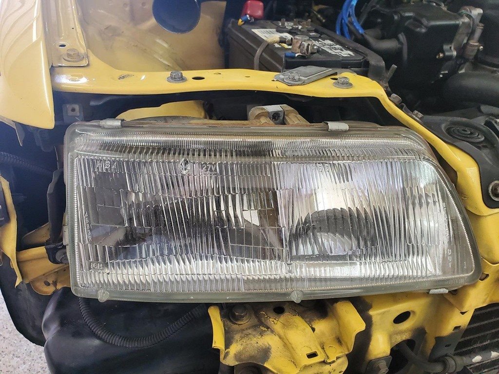

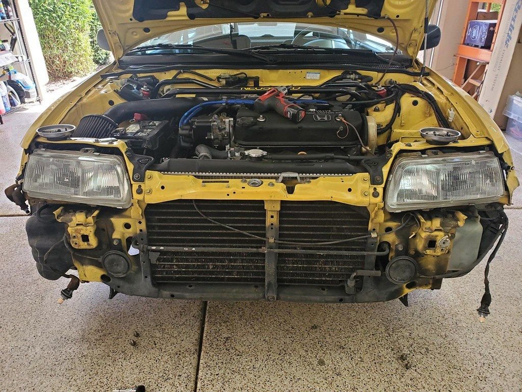

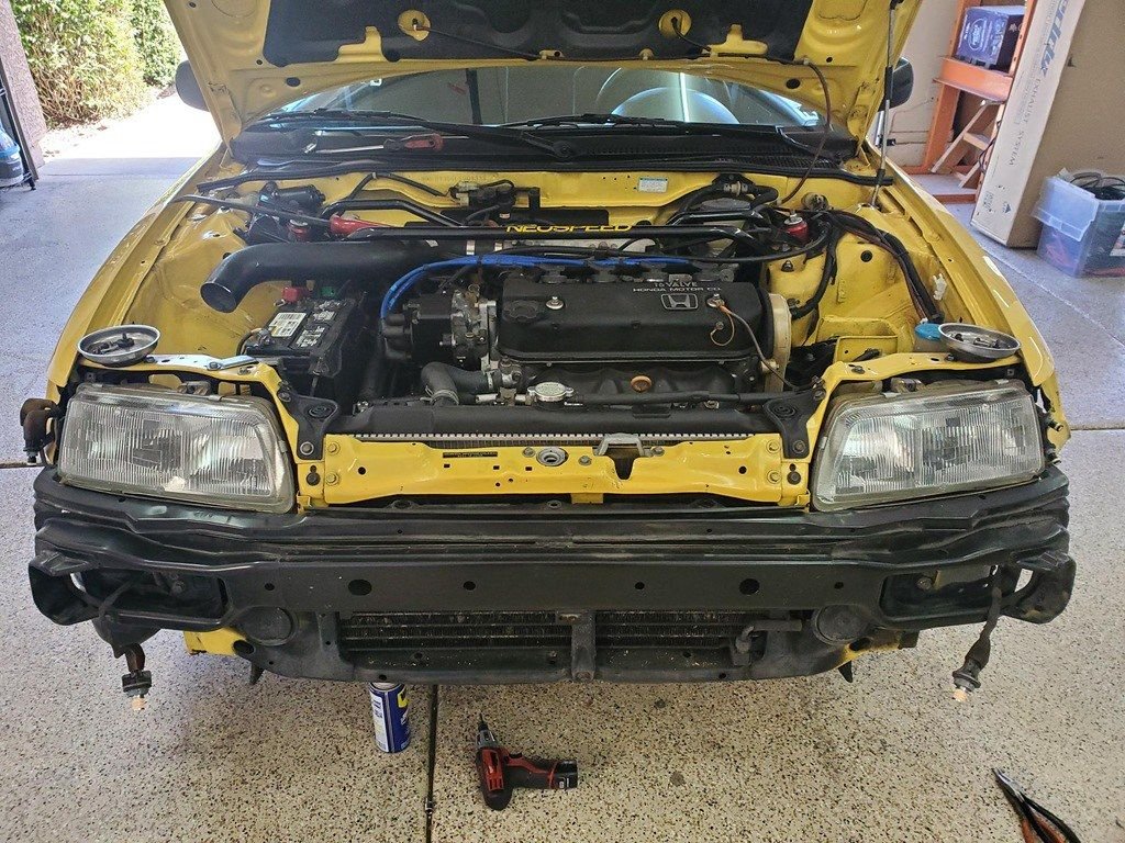

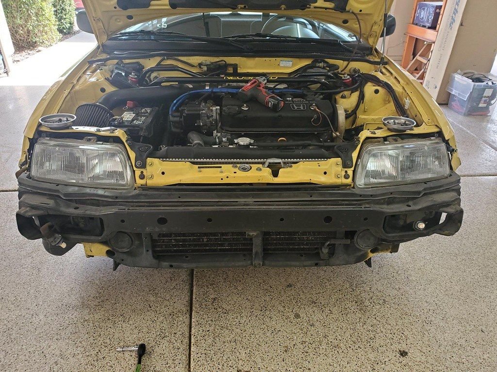

Spent some time with the CRX recently. I fixed the hatch release cable issue I was having. You pull the latch and the hatch does not unlock. Only way to get into the trunk was to turn the key and at the same time lift. So pull the trunk plastic out and took apart the mechanism, clean it, greased it and added a couple of shims to the cable. Now when you pull the level, the cable pull the lock open (click) and the hatch can open.
Moving forward, I wanted to play with the hood release cable.
I found that pulling the bumper cover and bumper off the car to gain access to the hatch release was fun. It works fine, the cable pulls the locking piece all the way open releasing the hood. But the hood does not pop open. So I am guessing its the spring and being old/tired.

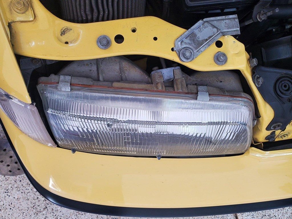

Passenger headlight was off about 2.5mm from the driver side headlight. So I adjusted/massaged the headlight and now I am within 0.1mm of the driver side headlight so I think that works.

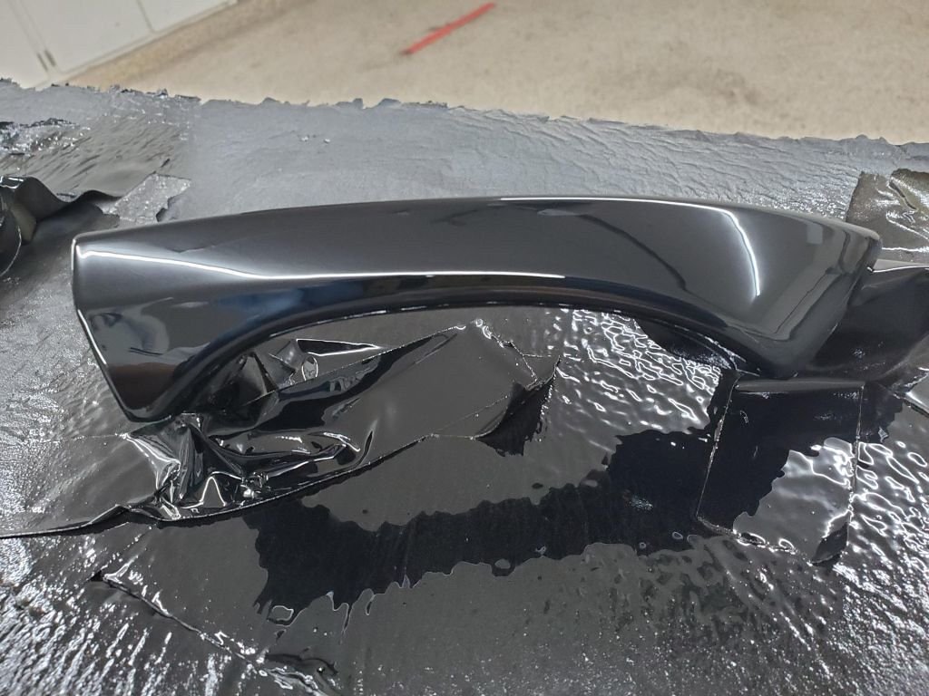

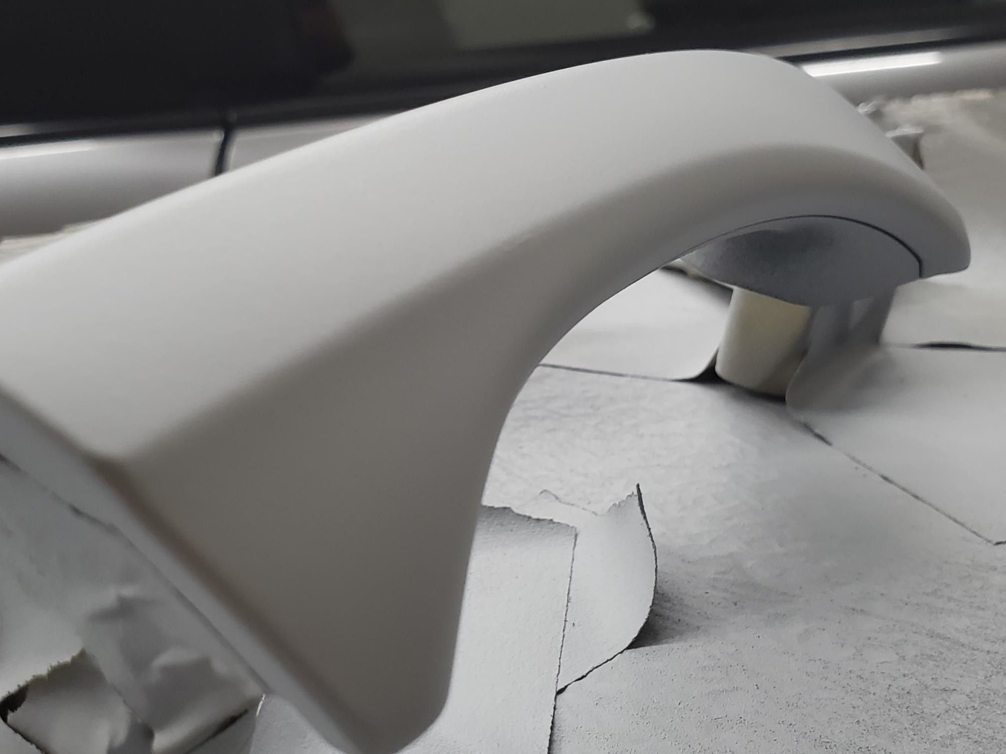

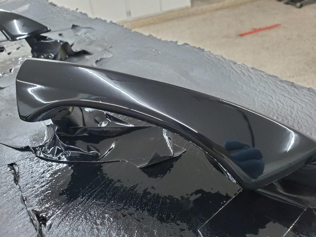

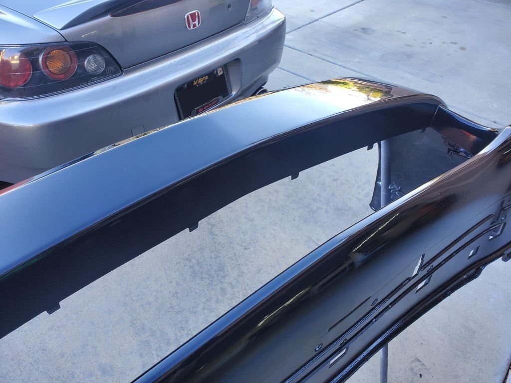

I got bored back in 2022-2023 and taught myself how to paint. So I've been picking up odd things for friends to get to a point where I can tackle the CRX. So with any luck, I will be repainting the CRX (Y-49) later this year. So this was a good refresher to go through. I plan to tackle this in manageable bites with the hood, front bumper and fenders coming first. Not to mention, the 90s pinstriping drives me nuts. Anyway... the pics...
Highlight painting pics:

Passenger headlight is not in alignment
Following the lines now
Buttoned back up
