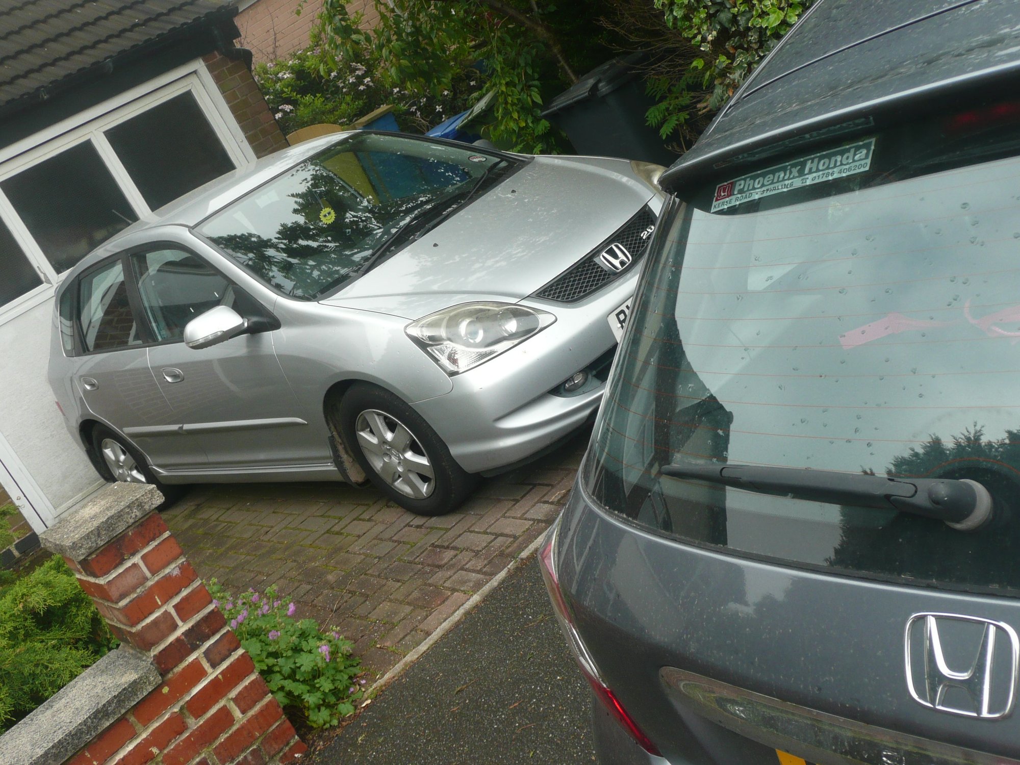

Been a 7th gen hatch owner for about 3 years, not a cool kid 3 door though, an old man 5 door (we all hate practicality, so uncool right?)
The tow hook and sticker mod crew in the UK despise the 5 door, but that is fine by me. Most of the UK 7th gen Civics apart from the Type R run D16 motors, but mine came with a K20A3 so it has a little more go, and potential for upgrades
Pics, first Civic:
