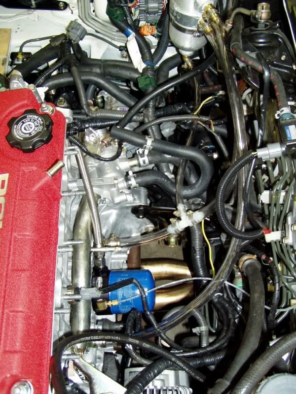

Read this:
https://honda-tech.com/zerothread/1676914
Heres the stuff you would need if you want to piece one together for your catch can
This is how it looks on an lsvtec.

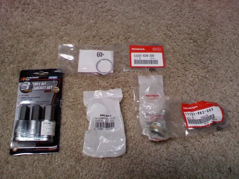

Can you explain what the parts are in the Honda bags? also like what they are for, how do they work? i would need some sort of tubing to go along with it and a catch can, is there a non-expensive catch can you perfer for the cheapest route i really doubt you need something really expensive being only a catch can nothing fancy, just something that does the job.
The honda bags have the actual product in what each bag has next to the left of it. Those are the two nipples you would need to vent your block with and the one above is the seal that goes with it. Yes you do need some sort of rubber tubing. Lowes is cheap. I bought my endyn catch can itself for like $50 shipped. pieced everything together and cost me less then $100.

Thanks man, too bad i cant read the part numbers on all those bags imma have to try to figure it out, does anyone else have any info they can share with me other than those parts, like what kind of hp i will be looking at when im all finished? im using stock I,H,E also.

11107-PK2-003
12207-634-300
These are the Honda parts, the one in the white bag you wouldnt need for your ls block since you never had the black box on the back of your block.
