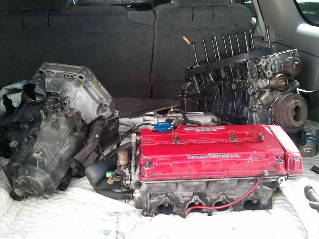

Here is a pic of what i ended up snagging. b16a and a jdm j1 tranny.
I guess ill clarify a little here. Im not racing. No quarter mile, autox, no STREET racing. The whole point of this is a project car. To restore the teg with a few modifications for a weekend enjoyment vehicle. I can drive it around town or hwy and sometimes really get on it when i want to. So i'm not looking for gobs of power. The reason i considered the b16 was smaller disp/ better gas mileage, and i love the high revs.

i hope you didnt pay too much for that set up... that head looks tired and looks like it had leaks around the flange..
but it could just be dirty and needed to be cleaned

No leaks. Prev owner said it never leaked or burned a drop of oil and old head gasket shows just that. Quite dirty though. lots of carbon buildup. Its getting full gasket replacements as soon as i can figure out which gaskets to use. And a through cleaning. Motor had 91xxx miles on it when it was pulled. stock bottom end, p-30 pistons. not even a ridge on the cylinder tops and cylinders are silky smooth. Head looked good. gsr cam replacement when it was rebuilt 91xxx miles ago. Tranny im unsure of. cant really tell until you run it but everything checked ok visually. Have know clue what clutch kit/pressure plate/flywheel to use. Lol.
Got the whole set-up for 650.
