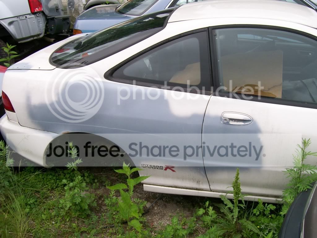

Here are some pics;
What should I do? I found this the other day. Its got an LS B18B1 non-vtec with Y80 tranny. I've been looking for another project but . Give me some thoughts. Its VIN is JH4DC2313VS003025 (I think I couldnt read the last 3 digits well becasue the windshield was filthy) So its a 1997, saveable? Should I try and buy/get it?

I agree, go for it. It looks like somebody else already tried to bring it back and gave up. Unless the rust is just really terrible, that doesn't look too bad.
:edit: And I agree with the above...the more '97's the better. How is the interior...if there is any?

they may or may not know anything about the car (and it's value). heck, they may be glad to just get rid of it for cheap if you haul it away. there have been shells sold for less than $1000 and i wouldn't be surprised if this one would be another since it doesn't have the five-lug, the engine's crap... but it looks like there may be some interior pieces () GL, buddy.

Motor and transmission from a lower model will bolt in(in a pinch people have even used SOHC D-series motors to get them rolling), the front suspension is the same so you can use LS/GSR suspension, brakes and hubs to get wheels on it. I don't know if LS/GSR rear LCA's can be used on the ITR subframe, but I would assume they can be, so the rear suspension/brakes/hubs shouldn't be a problem either. Hood is the same, taillights are the same, all of the interior is the same. (by same, I mean interchangeable) I can't tell from the pics what else you're missing...

pretty much everything from an ls/gsr will bolt onto the type r shell and work, basically honda made these cars like lego's which is great for parts but horrible for the fact that thiefs use that to their advantage
