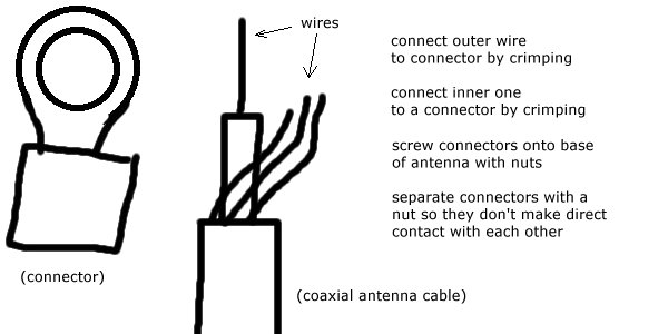

No. You don't have to buy a wiring kit.
I just tried the method of trial and error to make my antenna work. What you need to do is either cut off the end of your stock antenna cable or get an extension and cut the female end off. I'm not sure if the stock cable is long enough to reach though. Then you do this:
I suggest buying the extension. Then you don't have to modify OEM parts. Heres what you would need then:
http://www.weisd.com/store2/HRDPCR-18.html
Key is that the cable is of a "Motorola" type connector. At least thats whats in my 2000 ITR.
Here are instructions for the rest of the mounting kit. http://www.bseries.net/html/garage/s2kantenna.php
You need a metric course thread die if you're going to follow these instructions.
