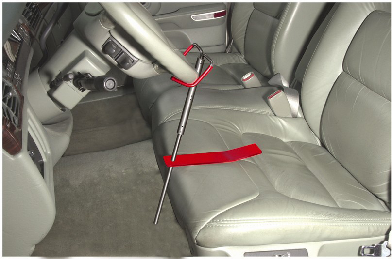

I did notice the right rear of my 94 Civic went out of whack (from .6mm in to 1mm out) in less than a year. I'm starting to wonder if nudging into the curb when backing into parking spaces is puts these rear trailing arms out of whack.
As for consistency, I've noticed that with the strings it's extremely repeatable. If I measure one day, and then check again the next, I get the same exact results (with the car sitting on the same surface). Probably better for back-to-back comparisons vs any shop anywhere. I will say the best part about doing your own alignments is the freedom to work on your suspension without having to worry about paying for (or getting a bogus) alignment. Takes me ~1-2 hours total to do all wheels and I know it's perfect.
http://www.negative-camber.org/jam14...alignment.html
Here is the writeup I used to learn the string thing. They even include an excel spread sheet to convert desired degrees into mm measurements for your specific diameter of rim and string offset. This is important because I found the OEM measurments in the manual (+/-2mm) are sampled at a considerably larger diameter than any wheel. For a 16" rim (measured 17" lip diameter), the +/-2mm spec in the book (that means 1mm toe per wheel) translates to only a 0.6mm difference from the front of the rim to the rear. Not the 1mm you might expect. That means you really need to be pretty spot-on just to get it within spec. I can confidently get it down ~0.1mm accuracy per side via strings.
One thing I add to the technique is sticking a bubble level to my scale for making measurements. This increases accuracy by monitoring the angle at which you hold the scale again and again. I also sit another small level atop the steering wheel once I visually set it perfectly centered. This way I can be sure it stays in the same place throughout the process. And if it doesn't, I can easily put it back to true center at any time (unless your kid comes along and snatches the thing up ).
I also park the front tires on some slippery thick plastic bags with thick shiny cardstock junkmail in them. This helps acts as a slip plate to reduce friction between the tire & floor. Without this, adjustments can feed back to the steering wheel causing to un-center (even with a steering lock device). Always re-check the steering wheel stayed centered after you've got the toe setting you desire.
I also dremeled my metal scale (.5mm increments) to a point at the measuring edge to make it easier to make the contact with the rim a tiny point. This prevents inaccuracy when rocking the scale left to right. Then I covered that tip with rubber cement to keep it from scratching up everything it touched (your wheels).
The tools:
Two cheap bubble levels (check each side for accuracy and mark all good sides) $2 on ebay:
Cheap .5mm precision scale $2 from china:
Steering wheel holder $30 from Amazon:
Day Glow Fishing Wire (.2mm diameter) $6 at sporting goods store
Harbor Freight Long Handle Metric Combo wrench set (includes large sizes required for bigger cars) $24 -20%:
2 jack stands (you should already have these if you work on cars):
Junkmail (free if you have a functioning mailbox):
