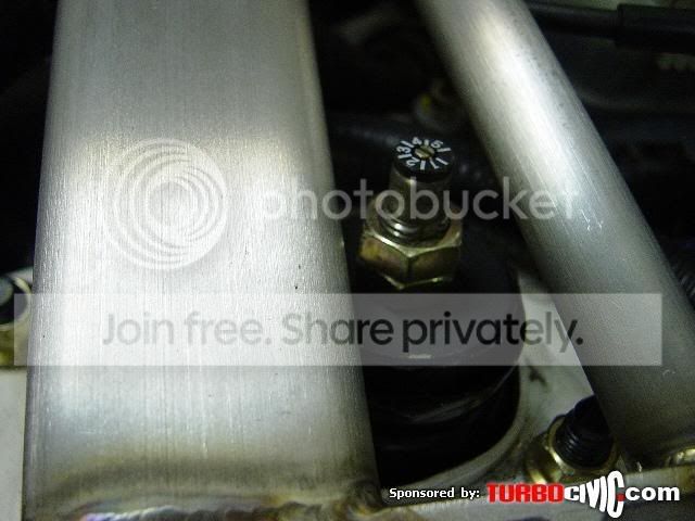

i bought a set used with the missing adjustable numbers 1-5. is there any way to find out? there is not a single number on there..
[IMG][/IMG]

I have the Mugen N1 setup with no numbers. What I do is change the setting and keep pushing down on that corner of the car. You'll be able to tell from going from 5 to 1

On my Spoon N1 dampers when you turn the **** it will skip the blank spot. When it skips that spot you can definitely tell and right after that should be 1. Three of the shocks do that and one skips number 3 but I think something is wrong with that one.

the thing is none of them have numbers... i guess i shouldnt have problem finding out which is which for the front.. but then the back should be pretty tough. only if i could find a brand new set of lowdown or maybe if somebody can take pictures of the top of the each towers installed would work too. thanks for the help guys

when you adjust the top bit. do each one slowly, and you'll feel it *click* *click*
there will be one of the clicks that feels longer. thats when it resets back to #1 on its softest setting
thats how it is for the 5-way rears of my Mugen N1's

yeah i think one of the click seemed to be hard to turn. i guess ill give it a try. thank you for the help tarje.

Gently turn it the other way..
If you can feel 5 distinctive clicks turn them all back counter clockwise 5 clicks and they should all be set to 1.
