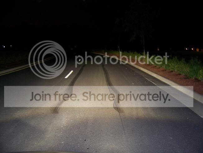

When I jack up my car and spin the driver side wheel by hand in either direction, the other side doesn't move at all. And when I go to the other side the same thing happens. I have a JDM B18C block with a B16A2 Si head with a '00 Si transmission. I was told by the owner that I bought the car from that he had installed an LSD. I've gone out to lay down some tire marks and have gotten two marks on the pavement, but on side looks darker than the other and the car pulls to the right when launching hard. Does any of this sound odd? I've always wondered if the trans has LSD or not, but no time to open it up and check.
Old Apr 22, 2008 | 10:34 AM
vinuneuro's Avatar
Posts: 6,619
From: Chicago
Default Re: (SeVeNisOnE)
You have an lsd that needs to be replaced.
