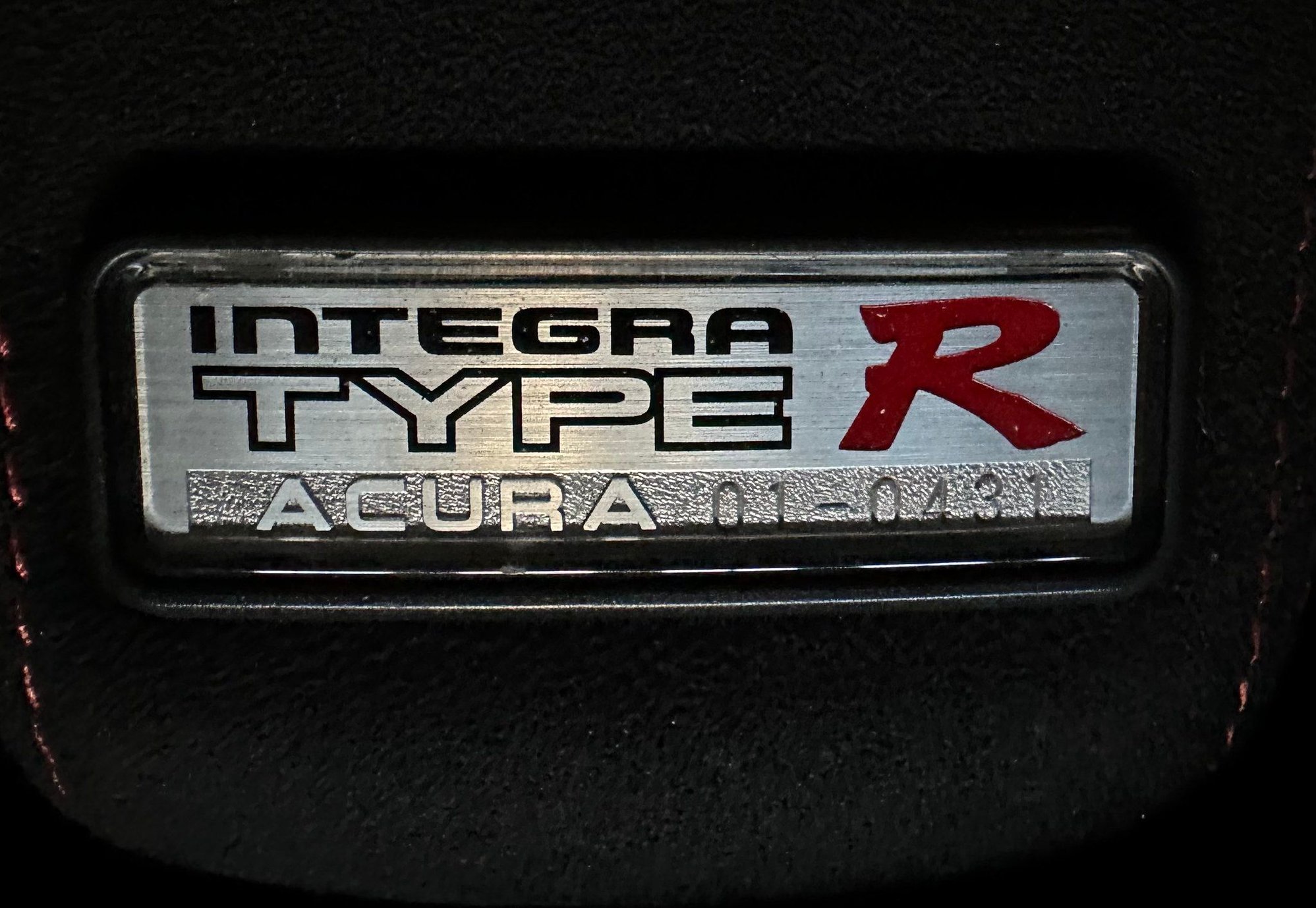

I recently picked up a 2001 Acura Integra Type R in Nighthawk Black Pearl, #01-0431, with nearly 94K miles on it, but with everything in great shape for a 24 year old car. Some or all of the previous owners appeared to take great care of the paint, interior, and maintenance, although at some point, I think earlier in its life, it got a factory replacement engine or block. It's a mystery why, could have been a money shift, factory defect, or some modification that pushed the engine too far. The current engine is at least from 2017 and probably way earlier. The current engine runs great, that last 1K of RPMS before redline is strong, and much stronger than I recall a GSR being, as it should with the extra 25HP near redline.
Official Badge:
How she looked when I got her:

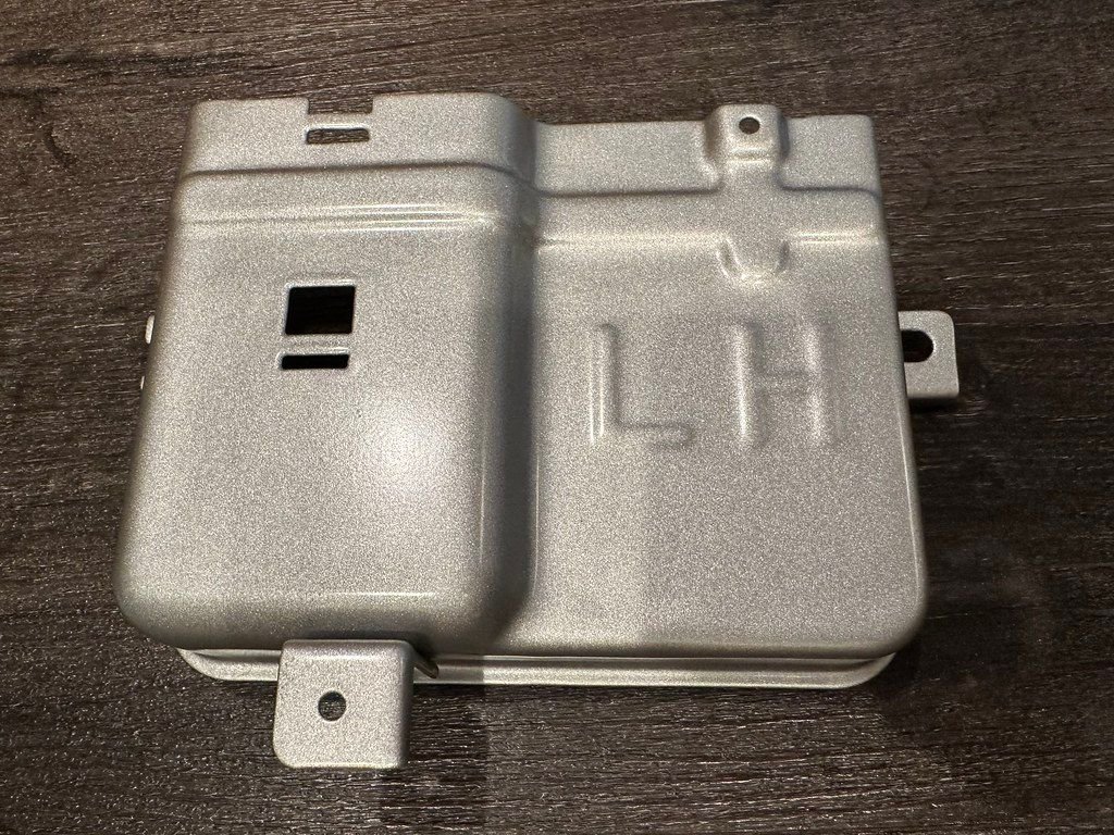

Last OEM piece I was missing, the ECU cover, which the passenger side kick panel also clips into. All the ones on ebay had rust, I found the least rusty one. Sanded and then sprayed a few coats of primer so far, will paint an aluminum color just to seal it before installing. Don't know how to do a zinc coating or something fancy like that, it's a hidden part anyways.

not a perfect paint job on the ecu cover, but good enough for a part I probably won't see again. Not rusted at least!
ECU and kick panel now properly secured, I added a missing nut for the ecu, and two clips for the kick panel.
