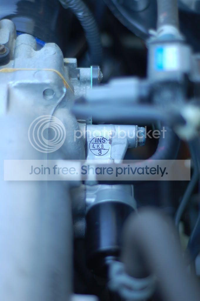

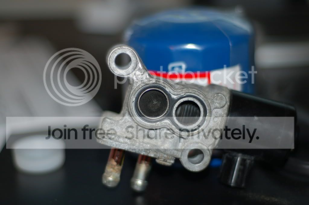

Since expo I've been having surging idle problems, original post- https://honda-tech.com/zerothread?id=2325797
Steps I took....
http://autumnatic.org/IACV/IACV-1.pdf
Plus.....
If your idle is above 550, check for vacuum leaks. Take the intake off, put your finger over the lower port in the throttle body. if the idle doesnt drop, check for vacuum leaks, make sure the throttle valve is closed completely.
if the idle does drop, adjust the idle speed. if you cannot adjust, replace IACV.
If the engine speed drops or stalls, adjust the (base) idle speed, clean the ports in the throttle body as necessary. if the engine speed doesnt drop, or doesnt stall, replace IACV.

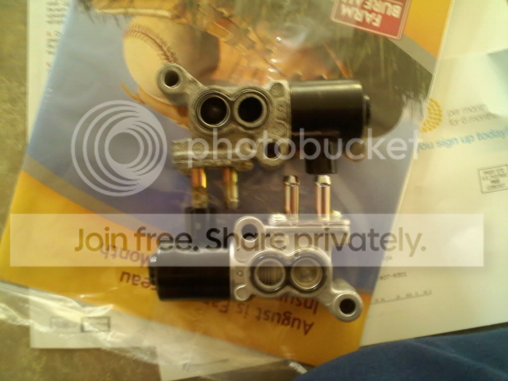

Took old IACV off.....
Camera phone pic
While it was off I jumped the connector and checked to see if it was functioning properly....it wasnt.
So I concluded that the IACV was at fault. Ordered parts from Len.....gottem
Replaced IACV. While the car was down I replaced some more things....

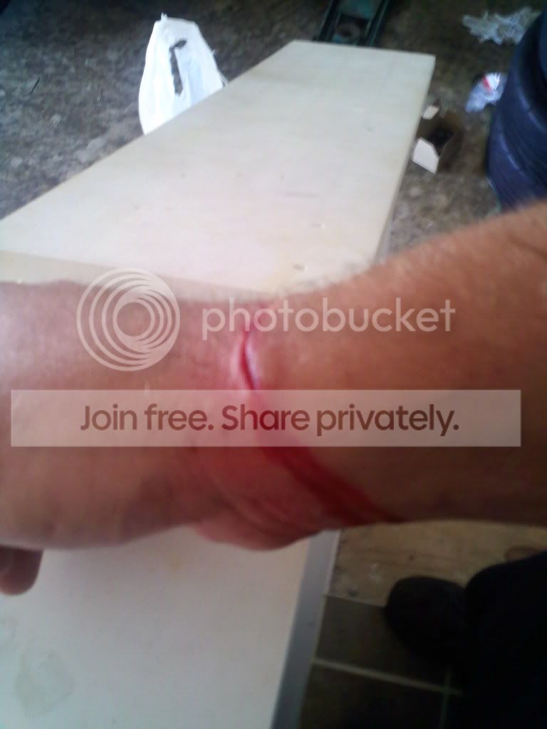

Carnage on something sharp under the IM.....camera phone pic
