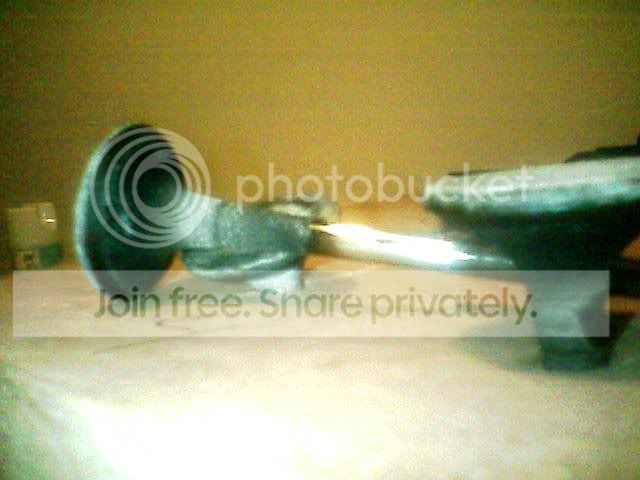

here is a crappy camera phone picture
luckily i found a box of GSR exhaust valves in my attic, what ever valves are not reusable i can use these

<TABLE WIDTH="90%" CELLSPACING=0 CELLPADDING=0 ALIGN=CENTER><TR><TD>Quote, originally posted by R.Kelley &raquo;</TD></TR><TR><TD CLASS="quote">
luckily i found a box of GSR exhaust valves in my attic, what ever valves are not reusable i can use these </TD></TR></TABLE>
oh no you wont

<TABLE WIDTH="90%" CELLSPACING=0 CELLPADDING=0 ALIGN=CENTER><TR><TD>Quote, originally posted by climb_on &raquo;</TD></TR><TR><TD CLASS="quote">
oh no you wont</TD></TR></TABLE>
why not....they're the same valve

From: USA
Default Re: (R.Kelley)
Valves are different.
Call Len and see the price for new ones, they might be affordable.

Default Re: (Bbasso)
Rob they've got the same PN for exhaust valves, the intakes are different.
