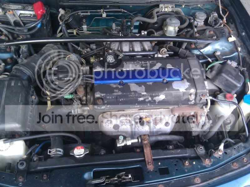

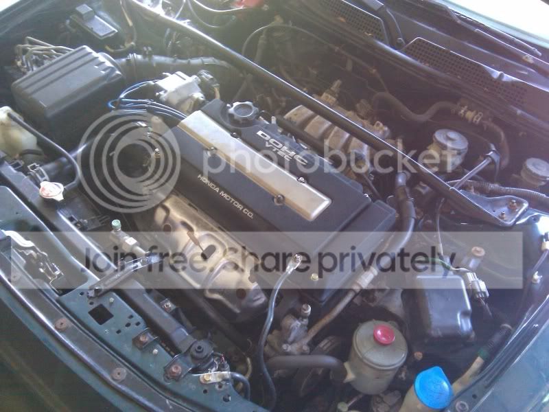

Anyway, this was beyond a simple detail job, but simple green really does work well. The engine was swapped out for a different one (which I also cleaned up with simple green), but the shock towers and the rest of the bay are obviously original.
Before:
After:

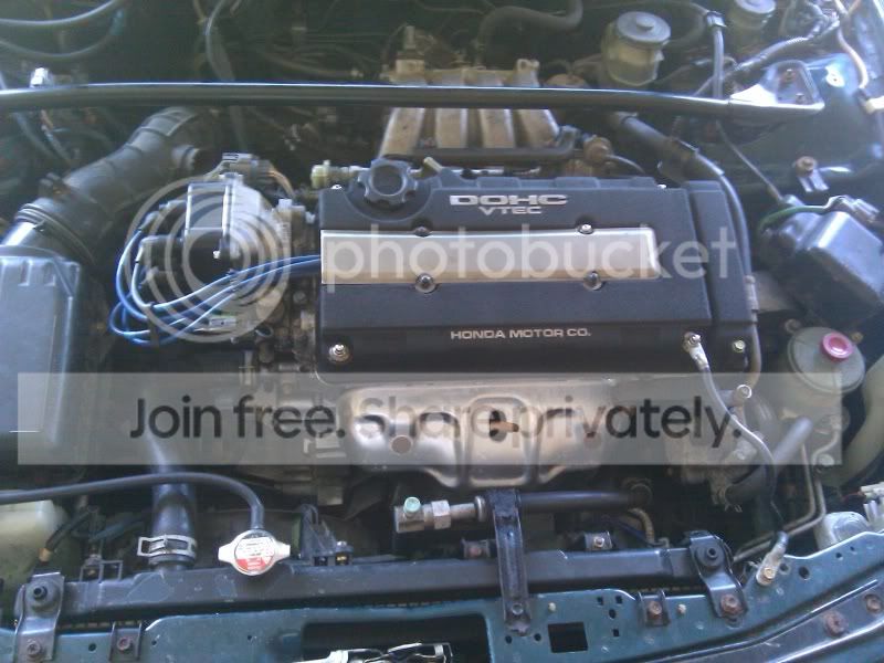

And after some scrubbing and armorall'ing on my old GSR. This thing was daily driven with 158k miles at this point.
