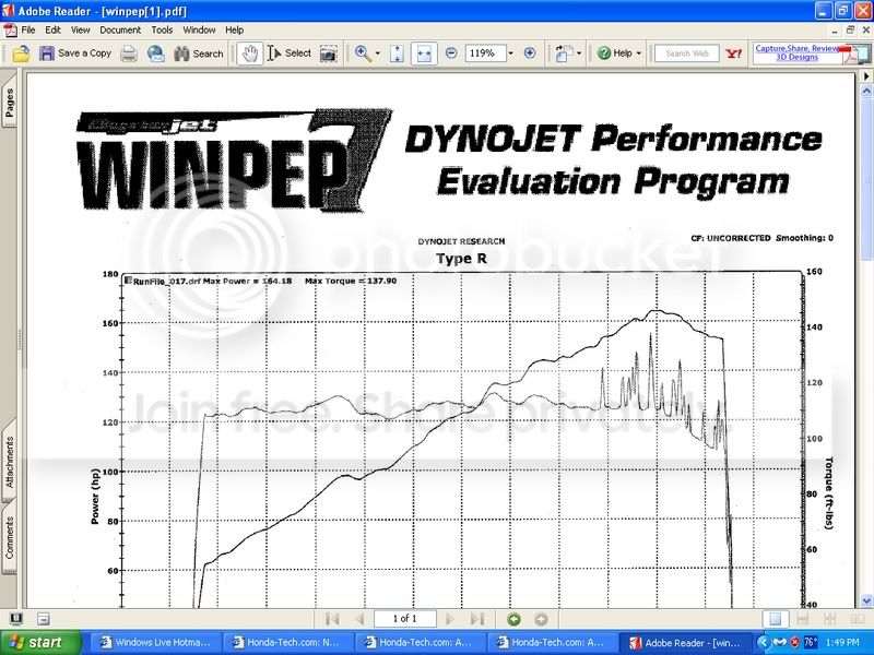

after 3 month of storage i took my car for a little trip. ive always known my car was running rich but not this bad. 20 mpg is what i got on my last tank. i decided why not get if fix when spending on all that gas.

[IMG][/IMG]
defenitly going to get new header and exhuast system soon
[IMG][/IMG]

where did i get all that torque from?

<TABLE WIDTH="90%" CELLSPACING=0 CELLPADDING=0 ALIGN=CENTER><TR><TD>Quote, originally posted by ge_itr &raquo;</TD></TR><TR><TD CLASS="quote">
skunk 2 stage 3 cams/ stock itr piston
Overcamed FTL.
<TABLE WIDTH="90%" CELLSPACING=0 CELLPADDING=0 ALIGN=CENTER><TR><TD>Quote, originally posted by ge_itr &raquo;</TD></TR><TR><TD CLASS="quote">where did i get all that torque from?</TD></TR></TABLE>
Faulty dyno reading FTW Just look at the sudden sprouts.
Modified by neo_ at 3:22 PM 4/24/2007

Holy crap... 165 hp????? Thats what stock ITR's throw down man. I've GSr's w/bolt ons hit that all day long...
Have you had a tune???
And I thought my ITR header looked bad

it was tuned, but maybe do to the smashed up 4-1 and 1 inch muffler. my car is overcam also. needs higher compression piston.

ummm 1 inch inlet and outlet? whats the story with that? A stock exhaust will probably give you like 15whp lol. you should be worried about that header and exhaust before even bothering with those pistons/cams/TB/fuel rail. the TB and fuel rail are way overkill for what you have. those cams are pretty big but would work ok with more compression. high compression likes to rev out and if it cant breathe then its just gonna choke. and what the hell are you using to tune with? and what happened to that trans?

looks like you def need a new exhaust system

Need some compression with those cams

somethin looks definitely wrong with the hp number but as far as the torque, thumbs up to that!! my old setup consisting of an aem cai, rsr exhaust, cheap 4-1 header w/ a 2.5 inch test pipe, simple B&M fpr, and some skunk2 pro 1 cams put down 188hp unorrected and 135 ft lbs. torque...

<TABLE WIDTH="90%" CELLSPACING=0 CELLPADDING=0 ALIGN=CENTER><TR><TD>Quote, originally posted by all_motaUSA &raquo;</TD></TR><TR><TD CLASS="quote">somethin looks definitely wrong with the hp number but as far as the torque, thumbs up to that!!</TD></TR></TABLE>
ummm no that torque number is also way bad....... you didnt look at the graph did you? it obviously got the 137wtq from the faulty spikes on the graph....... look where the torque really is..... it doesnt even hit 120

OHHH SNAP!! good eye...didnt even look at the powerband..i just managed to look at the numbers and hit reply...
