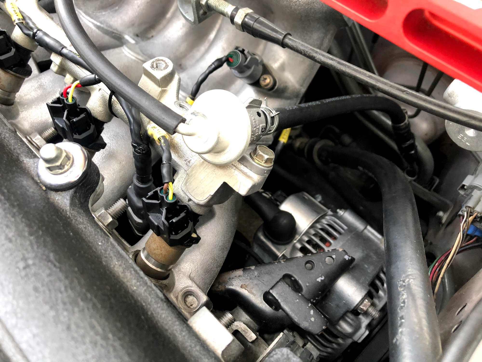

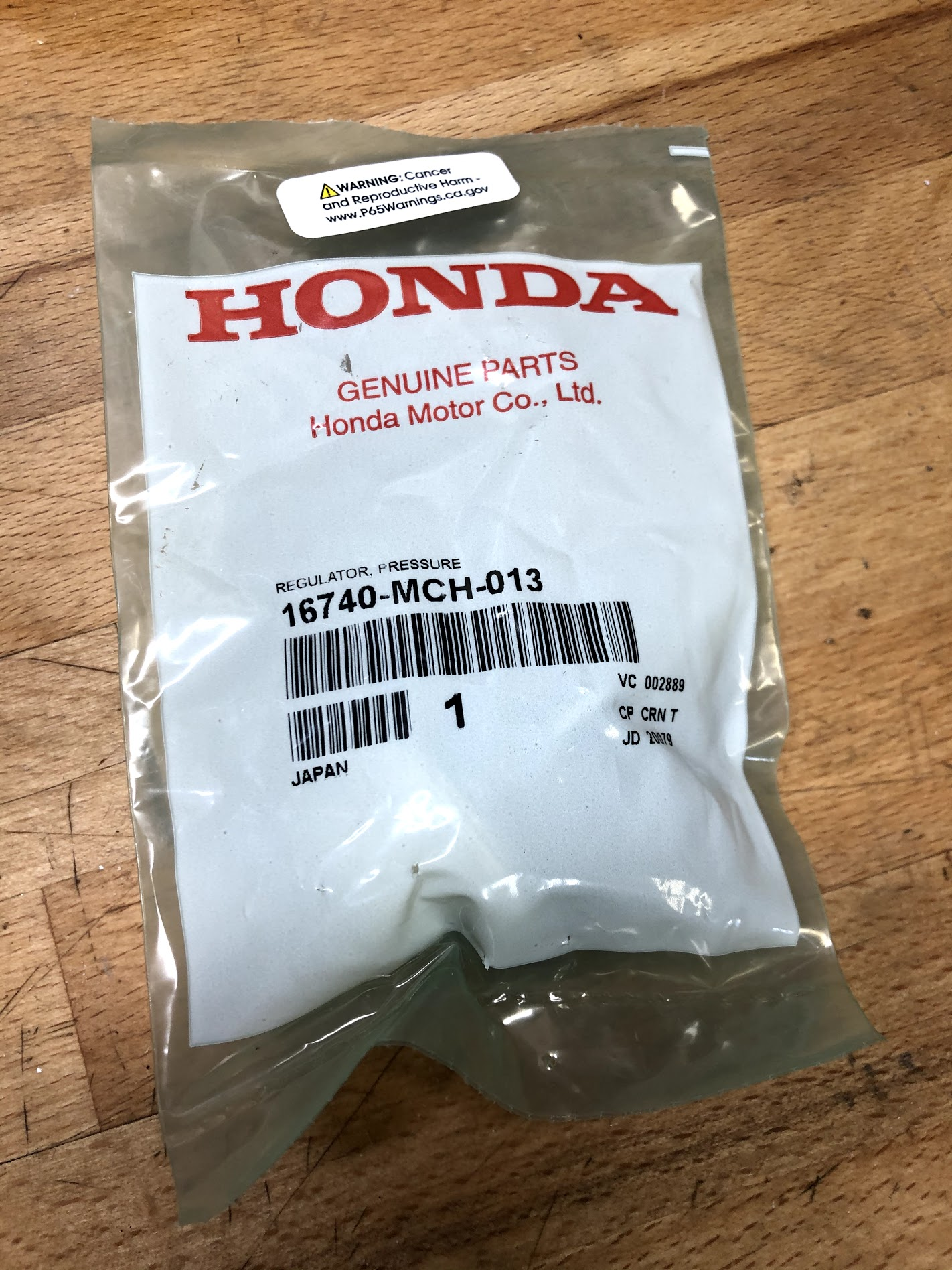

Thought this info might help the ITR community at some point so here it is.
I wanted to try an ITR fpr on the "smog legal" edition of my B20 swap since the fuel trims were a bit high with a P75 ecu, but found that 16740-P73-003 is discontinued and used ones were pretty tough to find. I started researching around and trying to figure out if there were other Honda vehicles with an fpr that I could hijack. Lo and behold, some of the early '00s motorcycles ran at ~50psi and the fprs are similar in design. 16740-MCH-013 is off of an '03 or so CBR954RR. The clocking of the vacuum nipple is a little off and the outlet nipple a little shorter but functionally it goes right on. It fixed the fuel trims on my project, and I thought it moght be useful for some of you guys that are trying to restore to original or replace one that's been hacked up.

It was <$40 from a dealer's eBay store

Works fine, it’s an oem regulator. Exactly the same as the P73 except for the nipple clocking (giggity?). To be fair, it’s only on the car when I’m in ‘smog legal’ mode. Lucky find though.
